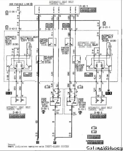

My passenger side seat belt has not worked since I painted the car. I can ground out the relay and get it to move back and forth and the door light comes on when I open the door so I know the door switch is working. Anybody know how the ground signal gets to the relay?

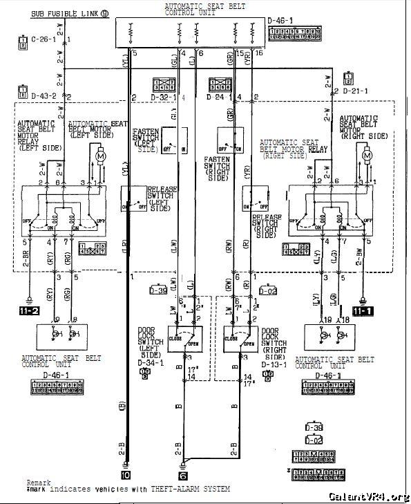

I've been having an intermittent problem with my driver's seatbelt for the past couple months. My seatbelt will retract at a specific angle open. Usually this is a few inches. At first, I was really confused why this was the case. The button switch that is on the chassis works fine for me, but doesn't seem to have any effect on the success rate of retraction. Apparently, there is a switch located in the door latch? My thought is the wiring for this switch is iffy and the circuit is only completed at the specific angle. Does anybody know which switch I am looking for in the picture below?
3,473
Pop the shoulder belt out of the buckle and make sure the retractor is not your problem. Sometimes the retractor will lock as the belt is moving back to the rear postiton and keep the buckle from getting full travel.
