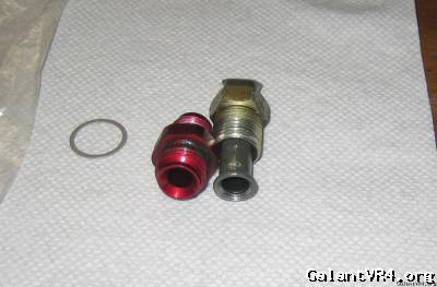

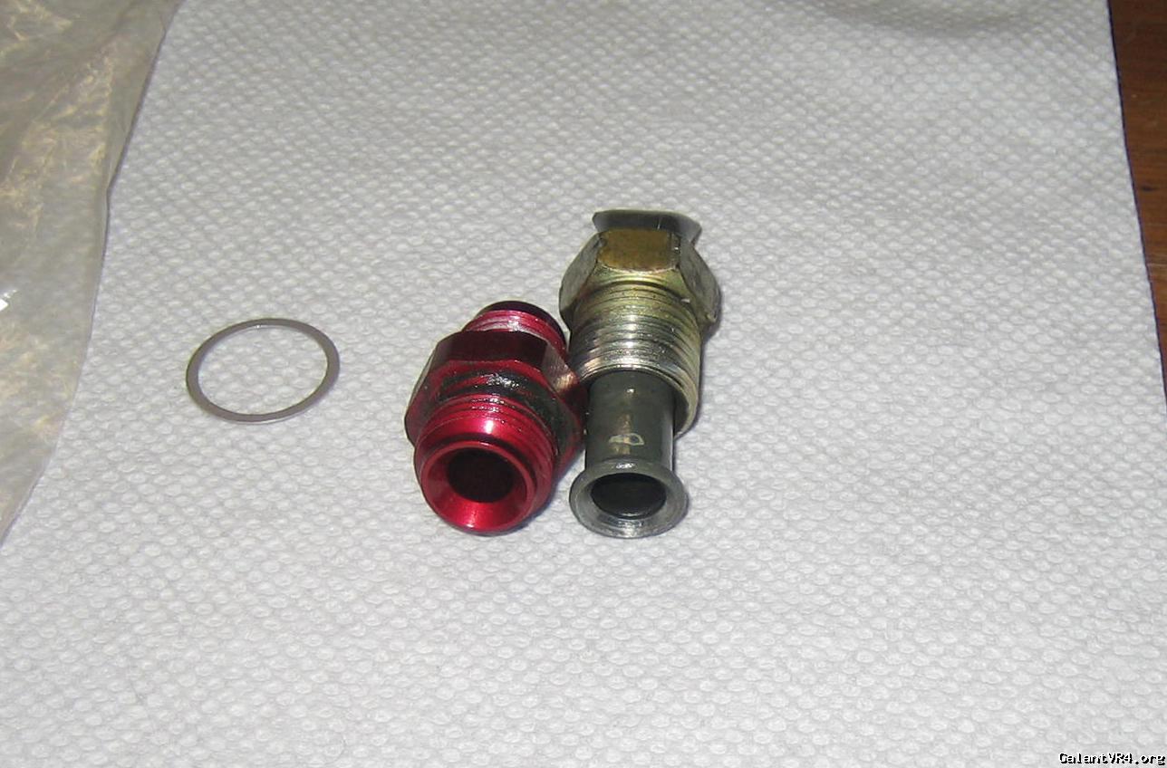

Hey all, I am having some trouble with some AN adapter fittings for auto transmission lines leaking. How on earth do I get these little @!*#!s to seal?
I am thinking that the brass fitting I am screwing the AN adapter into threads have been stretched beyond spec. Maybe I just need new brass master fitting. I am thinking that they install the lines at the factory with pneumatic tools because they were in so darn tight.
OR, the angles on the flared part are not the same on the brass fitting as they are on the AN adapter fitting which is causing fluid to get by. See the photo for reference.
I have tried the permatex sealant and it worked on one but the other is still leaking quite a bit, and I know people say to not use Teflon tape so what does that leave me with?

Much appreciated info, thank you. Here is the adapter fitting I'm using. Hard to tell if the angle is the same. I believe this is an inverted flare, AN on the left, oem piece on the right. Yes I cut that sob off.
The AN flare looks more steep, or maybe it's my imagination. /ubbthreads/images/graemlins/dunno.gif

JIC comes in both 45 degrees and 37 degrees flare. -AN is basically 37 degree JIC, but tighter machining tolerance. As long as the JIC you are using is 37 degrees you can use it with -AN no problem. If I was you I would take the fitting into a hydraulic shop, If what you are working with isn't correct they will be able to tell you right away, and get you the correct fittings. Or you could try putting a little bit of grease on the flare surface, gently thread it together and apart, if the pitch is different you should get a distinct line in the grease.

I will bring these two fittings to a local shop and see what they have to say. The main fittings I would like to keep since they are a major pita to remove with the trans in the car. I just need a male fitting with matching angle that adapts to a -6 male flare and I'm in business.

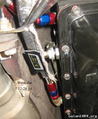

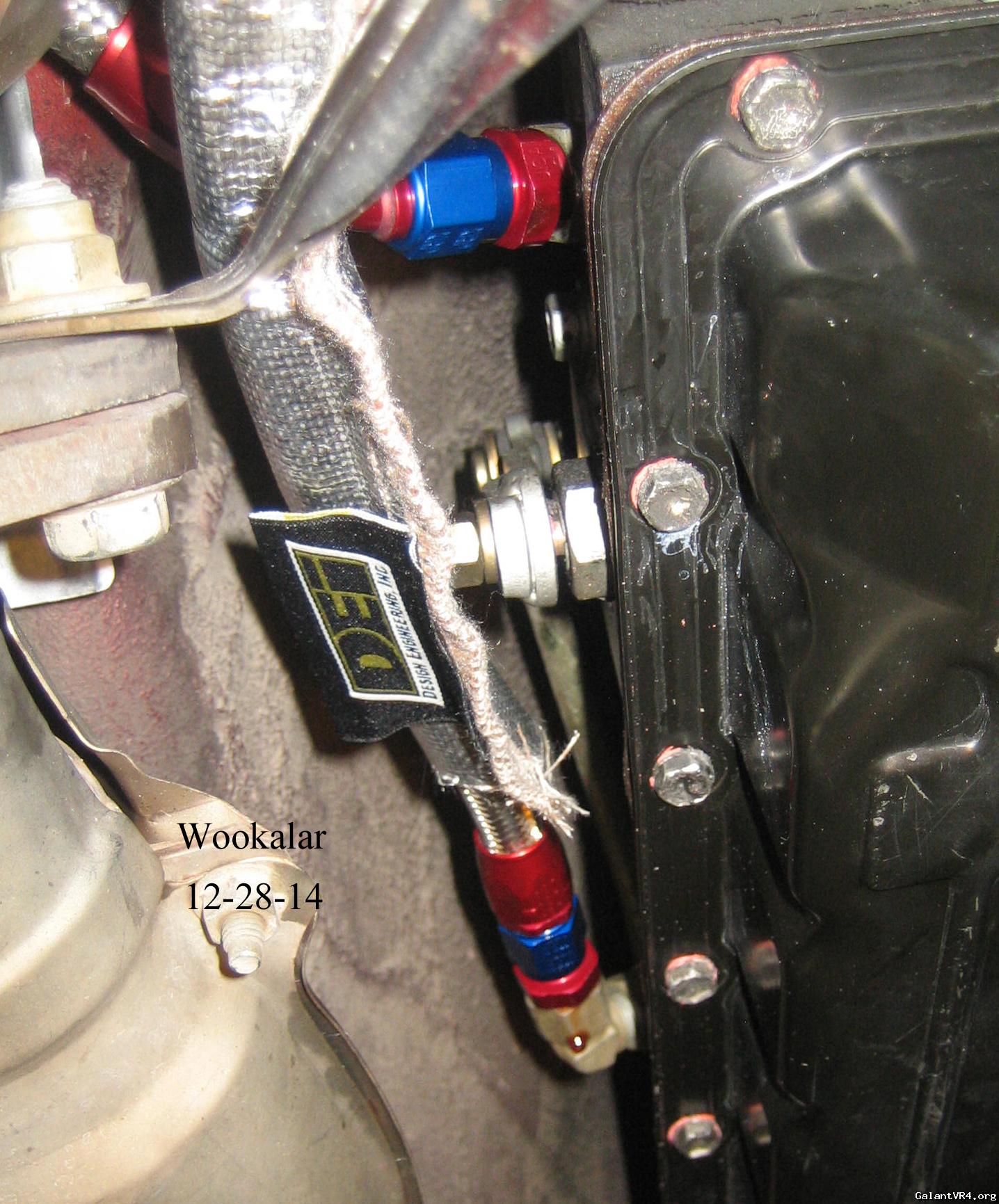

Yeah, I was under it when someone started it. Actually I think it came loose on me when I installed the hose end fitting to the adapter, so I just used some med Loctite on it today and I will check it in the am.
I spoke to a guy at a local store today and he said the angle is the same on the adapter side as the stock fitting, 45*, and that the AN hose end is the 37*. /ubbthreads/images/graemlins/dunno.gif
Update. The Loctite worked well, no leaks. Basically I just cleaned the threads with parts cleaner and used a bit of med Loctite on the adapter fitting into the brass fitting and let it dry for a few hours. Then I went back and put the hose ends onto the adapter fitting carefully using two wrenches so as not to break free the Loctite seal or overtightening (with a small amount of anti seize to prevent galling/binding damaging the aluminum threads). No leaks today after a test drive.
