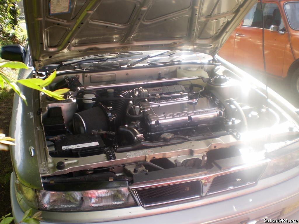

The car in question

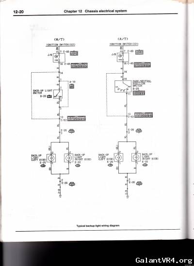

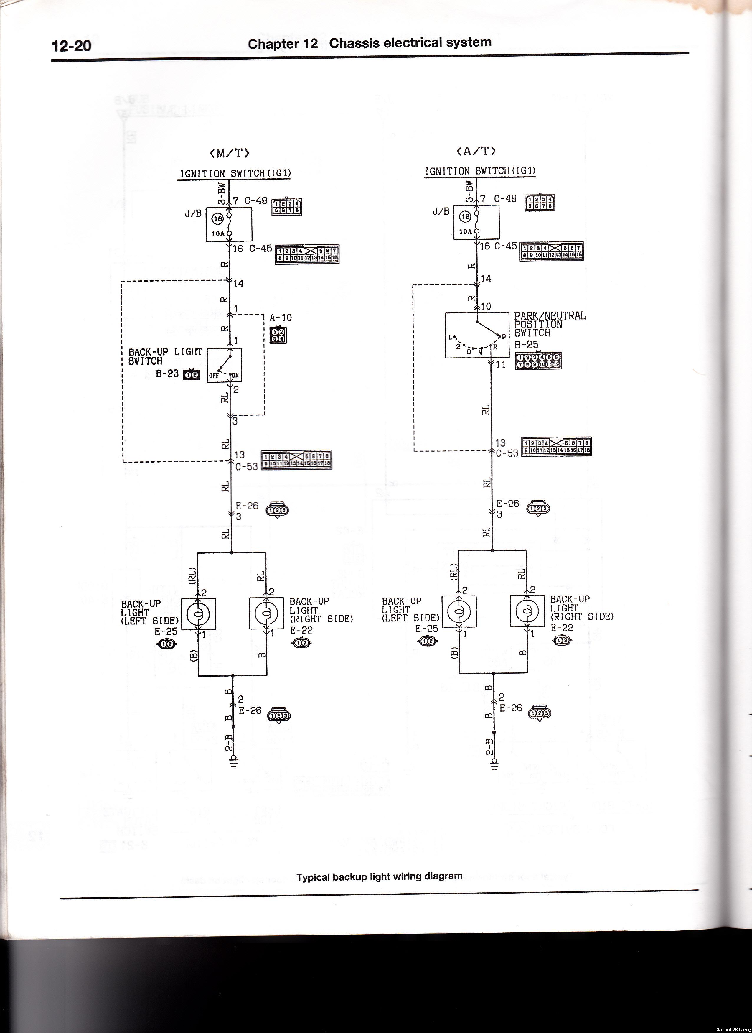

I have one, I can't make much sense of it though. I also know I have to attach it to the reverse sensor on the trans, I just can't find the wire that powers the reverse lights. The reverse sensor looks to be a simple on/off switch, so I assume positive current passes through it to the rear and then throws the relay for the reverse lights.
Is it as simple as finding the correct wire? or is there more to it than that with an auto harness?
Do I need to 'bridge the gap' between connectors where my TCU should be? or does that not play a role? I ask because from memory on a 2g the reverse sensor has to be wired to a pin on a connector where the tcu would have been under the console.
you could also use the reverse switch with a relay 4 prong you can get this at an auto parts store and ground the relay using the switch to do so and just make a simple harness that runs to your reverse lights and wire them into your harness you have made. Using the switch to ground will be easy just check the wire at the sensor for continuety when put in reverse and use that to ground the relay to complete the circuit. just fuse the 12v source voltage to the relay.

not sure if NZDM will have same pinouts for things, but it seems that for a DSM, applying 12V to pin 11 on the automatic gear selector harness will light the reverse lights - hope this helps, sry if it's useless /ubbthreads/images/graemlins/frown.gif
