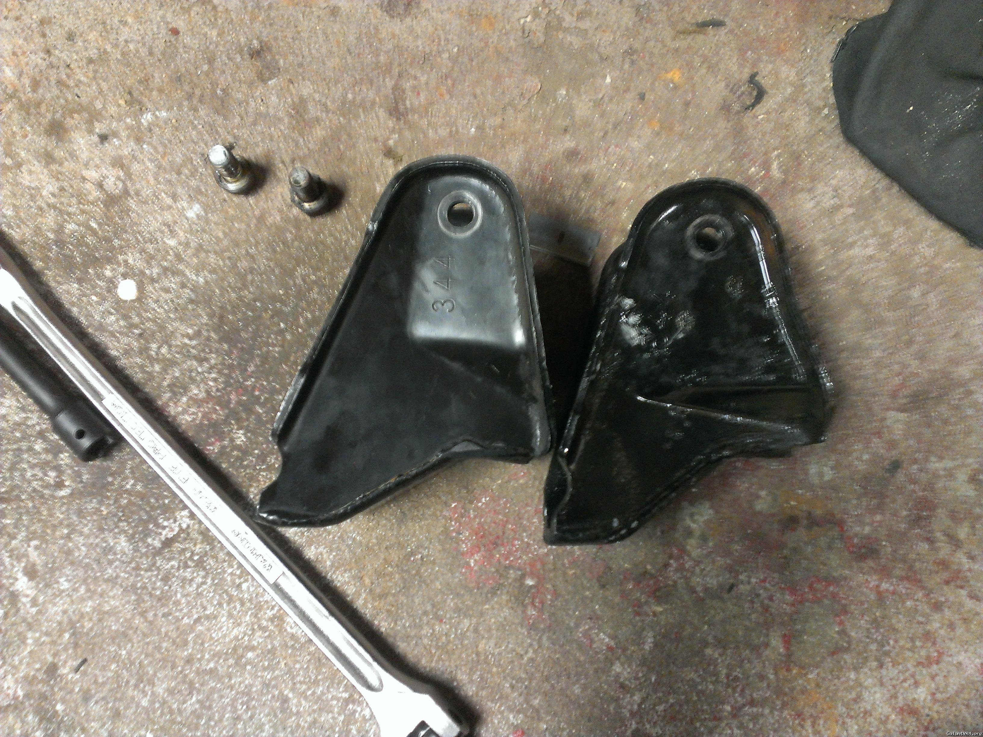

So... They are very different from the manual mounts. Here are some Pictures:

Motor Mounts - Some of the motor mounts on the trans are completely different and are impossible to swap over from your manual trans. Luckily both pieces to the front mount are the same and the mount on the drivers side for the engine can obviously be left alone. But both passenger side mounts are different. And on the rear of the trans the bracket that mounts on the trans is different but the mount that stays on the body of the car can stay.

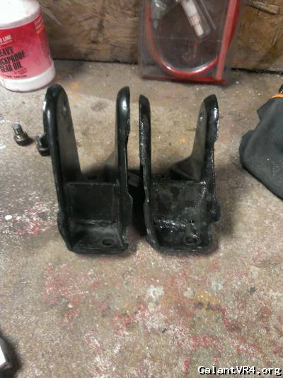

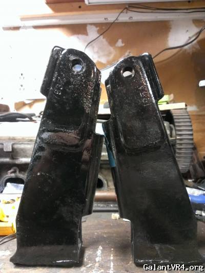

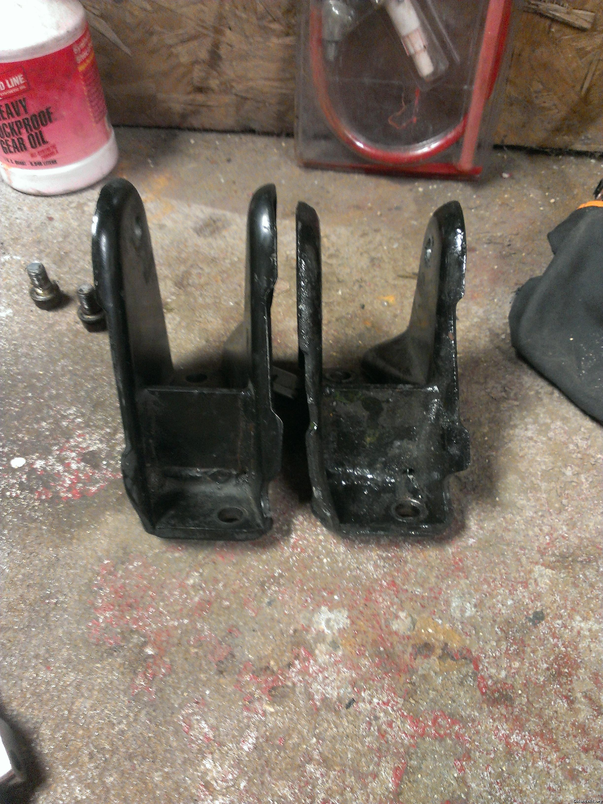

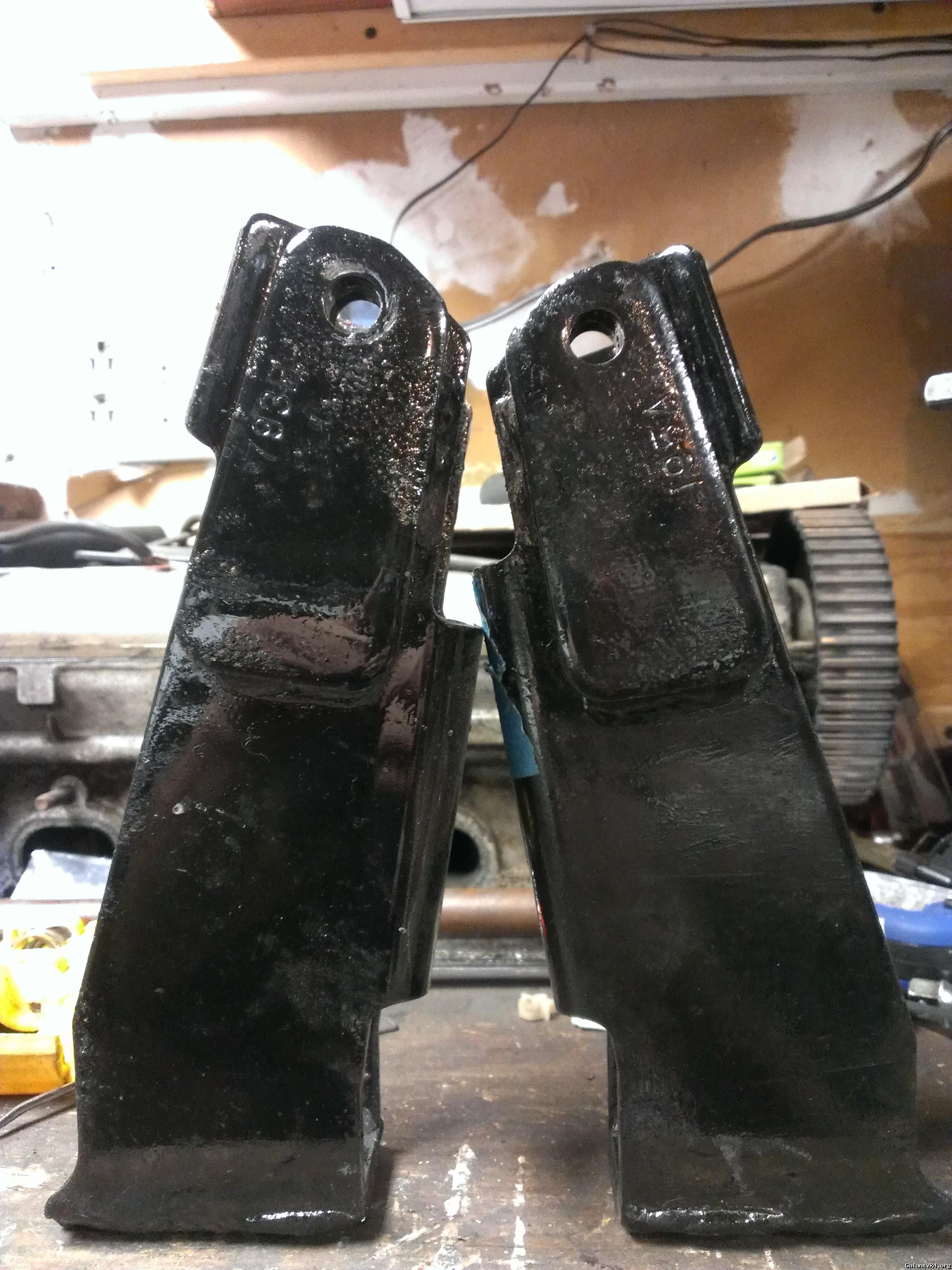

Here are the rear brackets. The longer one on the left is the auto.

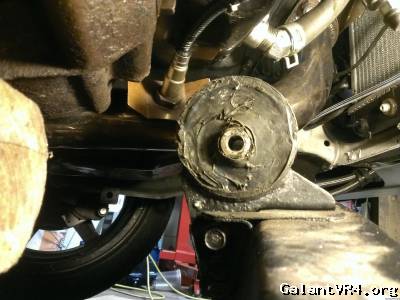

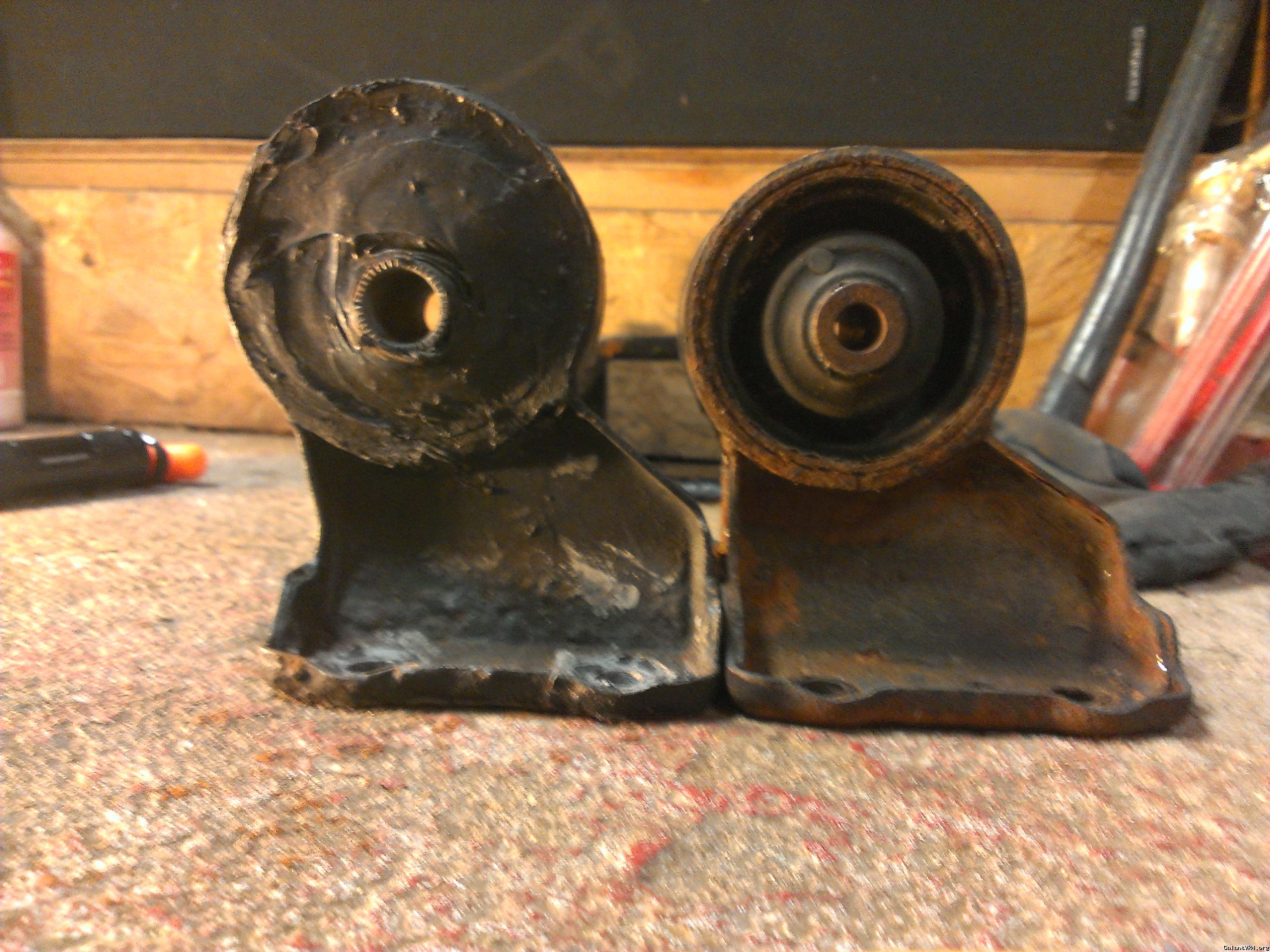

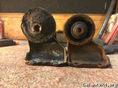

Here are the rear mounts. The bigger one on the left is the auto.

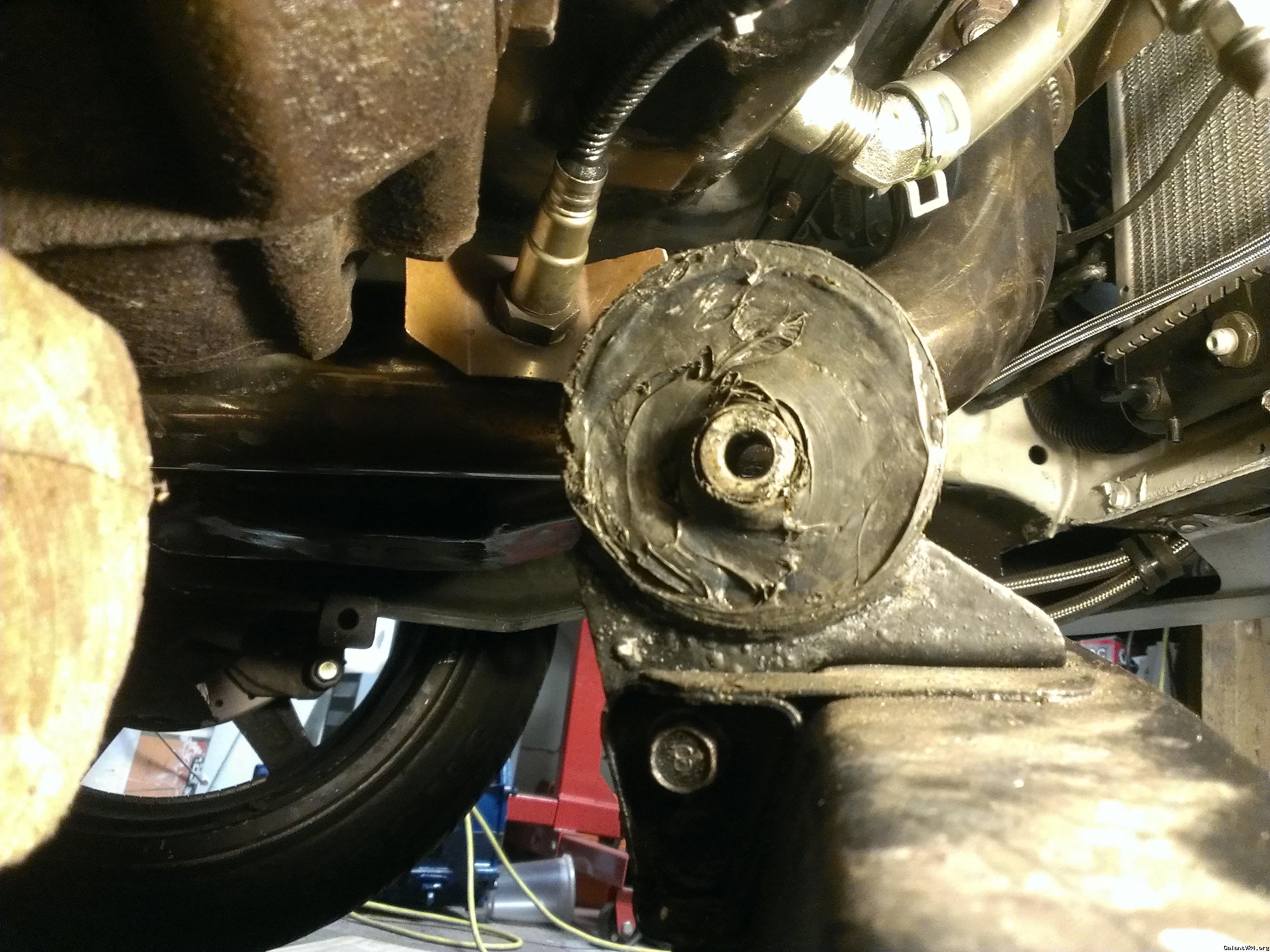

The sleeve in the auto mount is way too big. Both brackets have the same diameter bolt hole and both are a few mm smaller than the one in the auto mount. I think I'm missing a bushing or something. Also it is hard to tell in the picture but the holes do not line up vertically or horizontally.
Rock auto lists the manual and auto front roll stop mount as the same part number "WESTAR Part # EM9078 ".
So it looks like I'm just ordering a new rear mount. Or maybe get some more window weld and get to work rehabbing the old ones from the DSM the trans came from. I would like to go to mod on Saturday.
