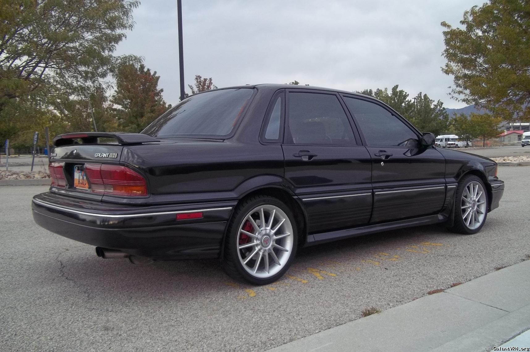

1991 Galant VR4 #1605/2000 nile black sunroof car

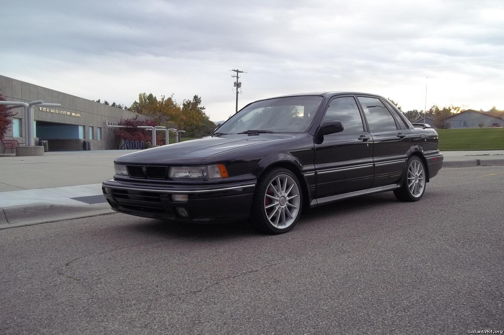

bought the car jan 2011 with blown motor, bald tires, bent wheels, and missing a door clading.
car had 106k on the odometer.

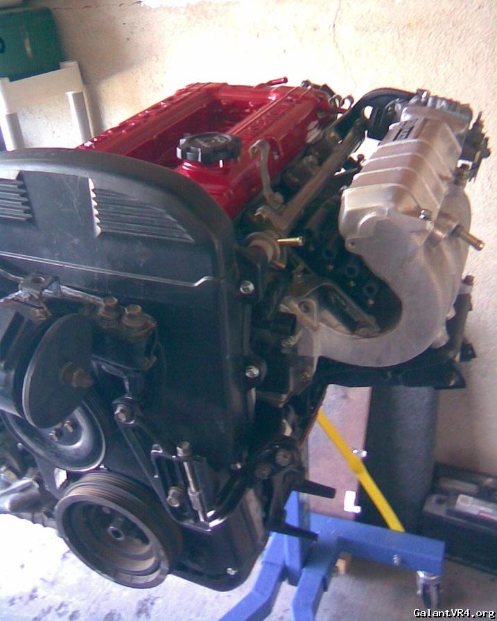

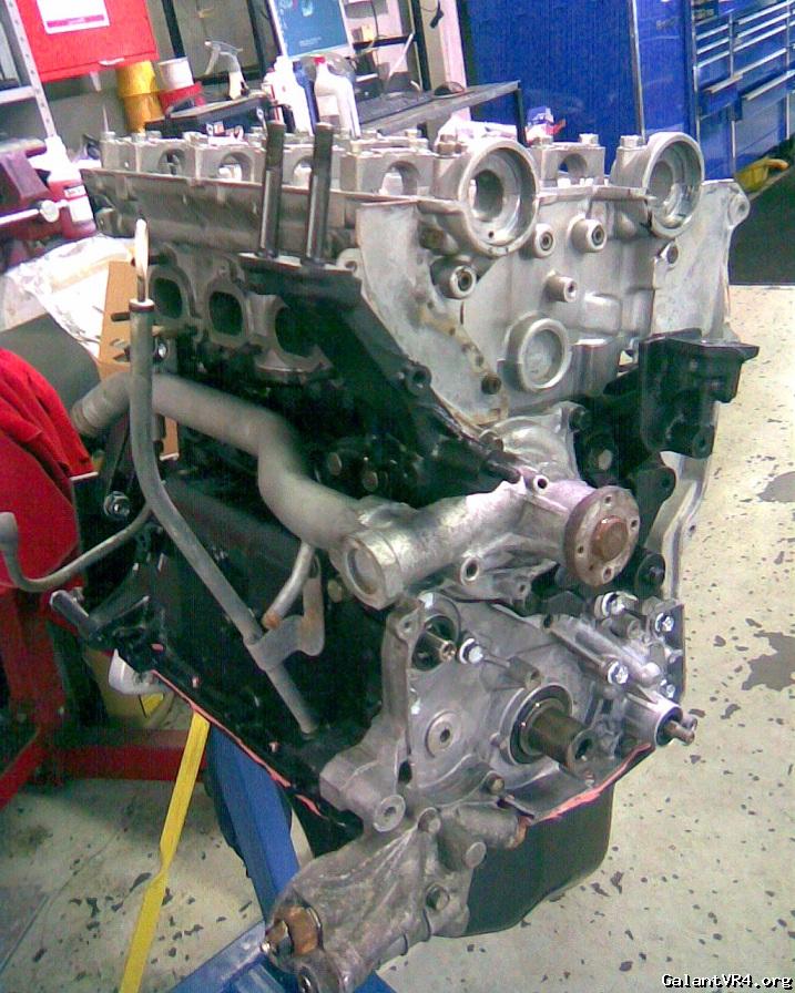

Engine-
Bored 20 over with new factory pistons, rings, and bearings.
New water pump, Timing belt, 93 intake cam, Rebuild Head, 1g exhaust manifold.
New belts, plugs wires.
Rebuilt 14b for now.

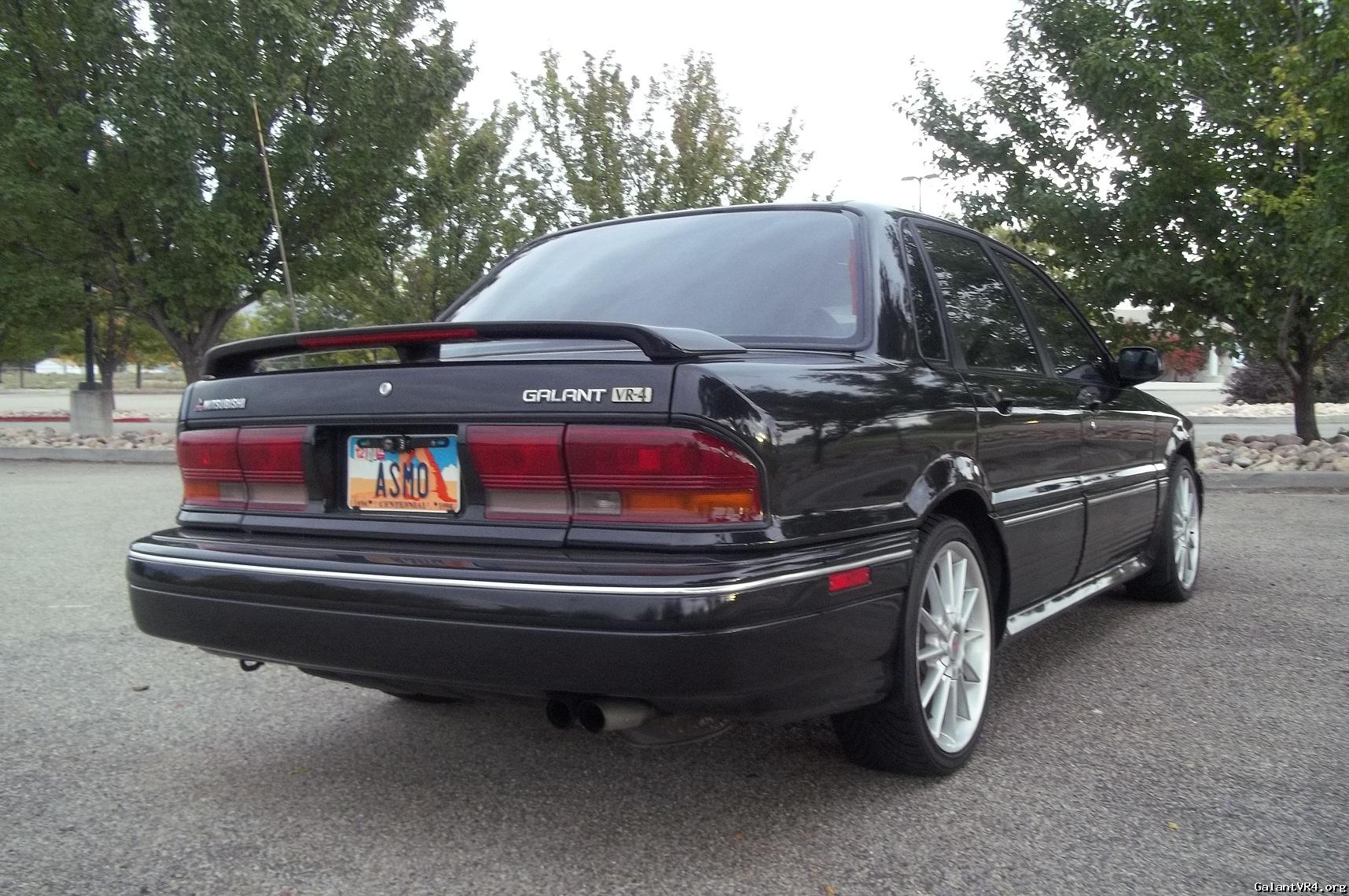

RRE downpipe
3" local muffler shop catback
Turboxs manual boost control

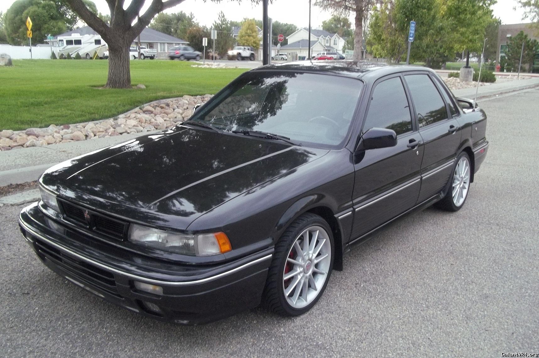

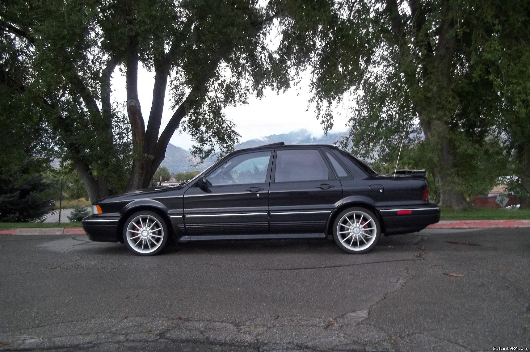

Exterior-
Door cladding from donor junkyard vr4

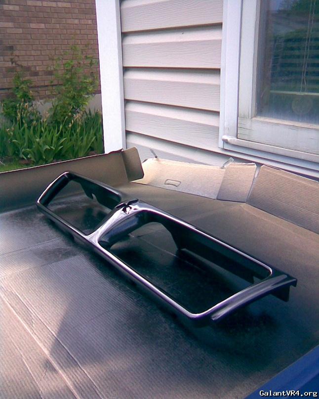

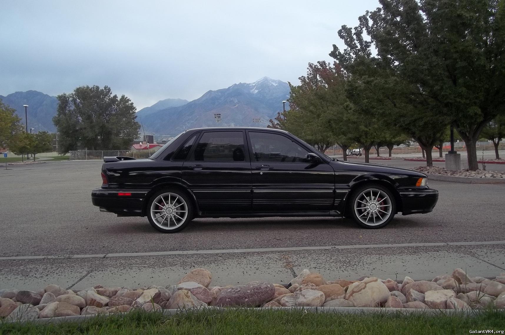

1992 painted grille

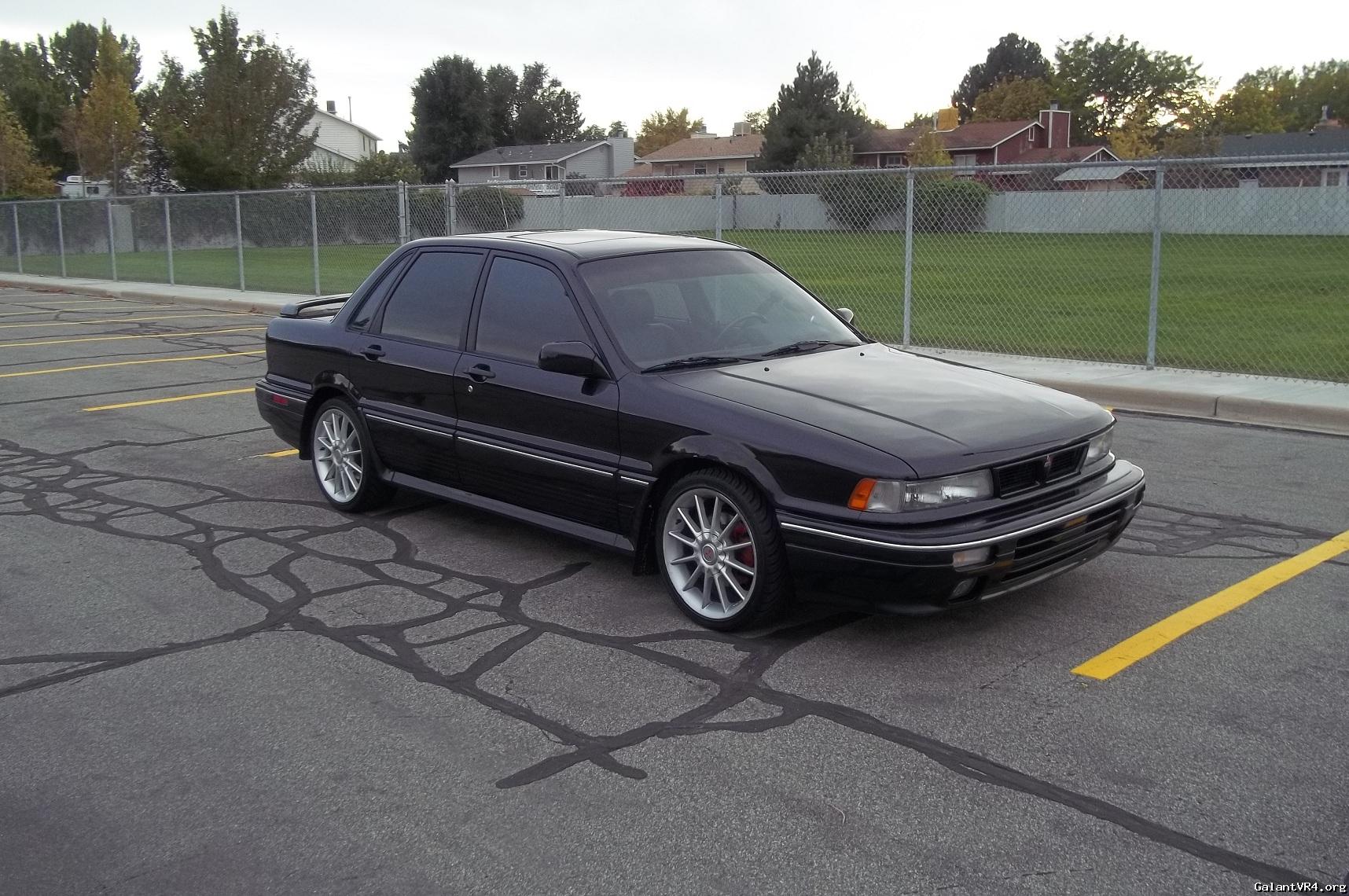

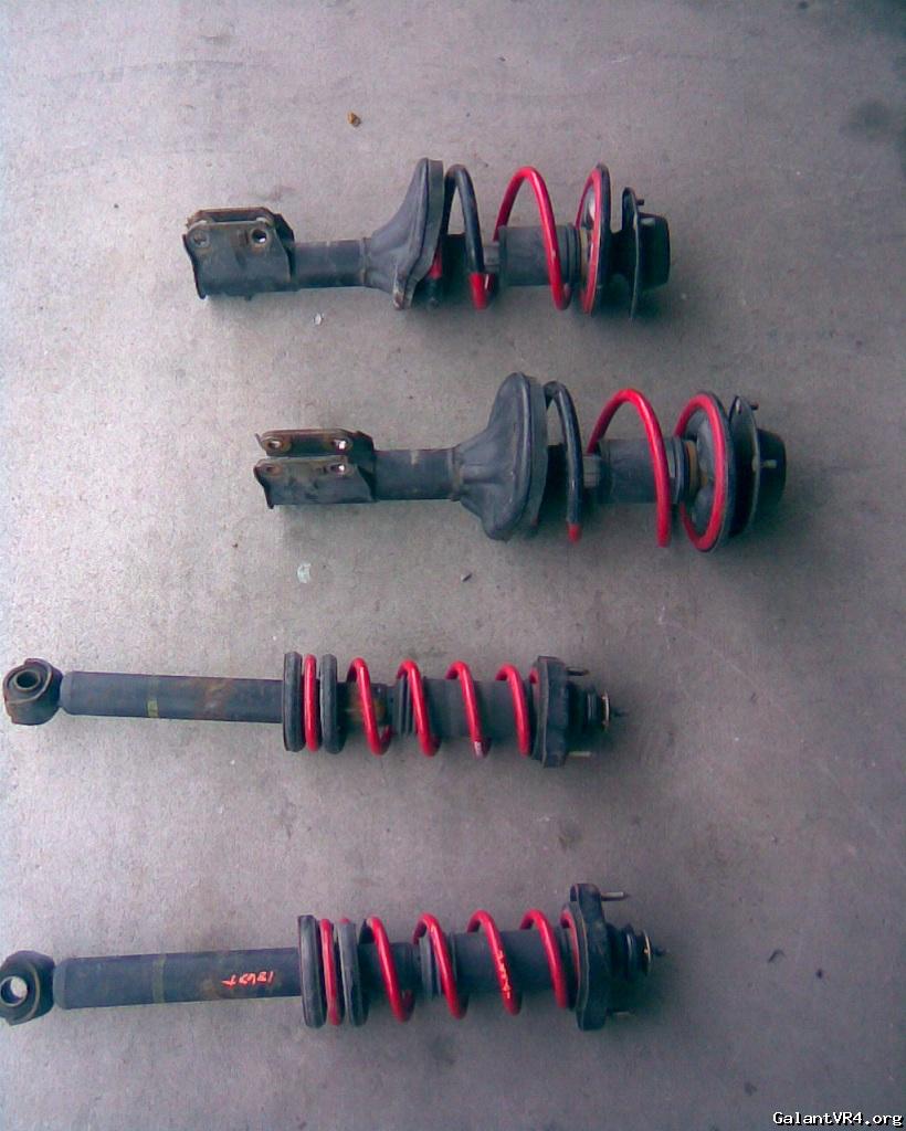

Evo KYB struts modded by garfield, Evo8 SWIFT springs about a 2" drop all around
17x7 Primax 417 wheels
215/40/17 Hankook tires
new outter tie rods.

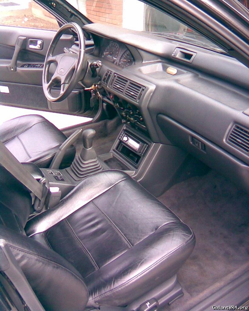

Interior-
3-4 leather conditioner treatments, soft as new again!
Pioneer cd player
Lancer OZ floormats, they fit pretty good.
