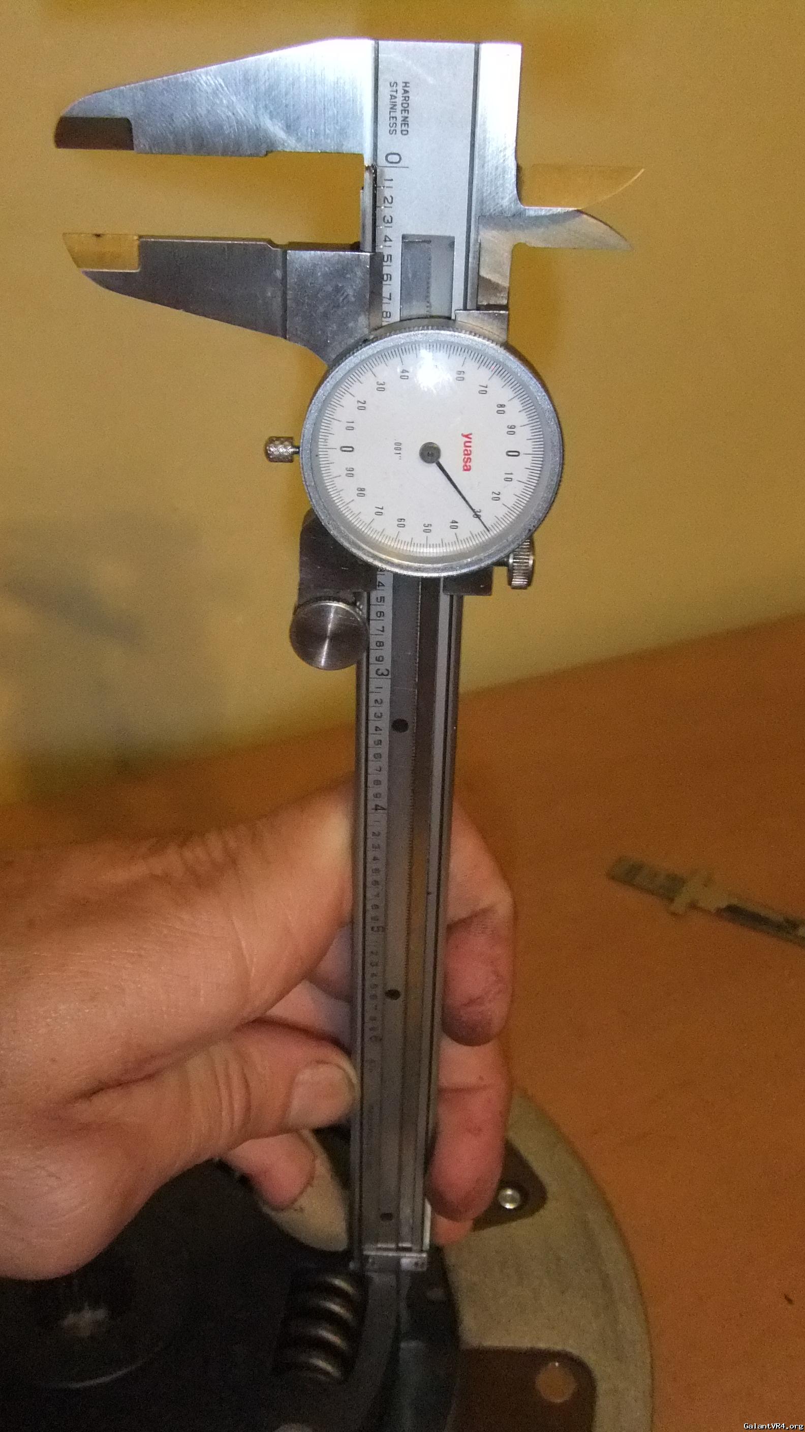

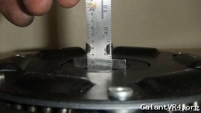

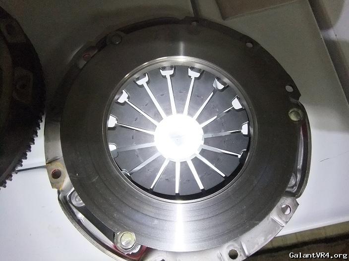

OK, I replaced the clutch pedal assembly with one freshly rebuilt by Shep and adjusted the pedal as per the FSM. Still didn't fix the problem. So, I pulled the tranny, and the pivot ball DID have a shim under it, so THAT's not the problem. Then I noticed the following when I pulled the clutch and pressure plate off:

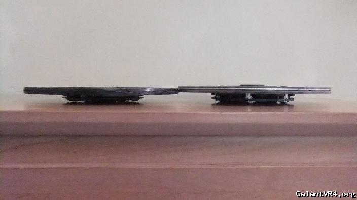

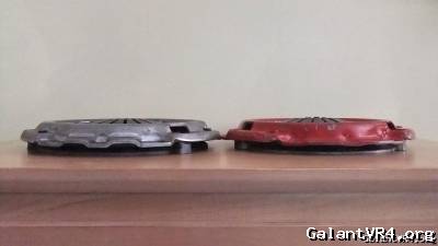

From the pics above, you can see that the fingers on the PP seem to be contacting the back of the disc in the vicinity of the center spring covers. That shouldn't normally happen, right?
I checked the step on the flywheel, and it's 0.609" which is right in the middle of the range the RRE suggests. The ClutchNet rep told me on the phone that the stock step was what I needed to use (0.612" according to RRE).
It seems like the clutch is not fully disengaging, no matter how long it's held in. As further evidence, once it is in gear, with the clutch fully pushed in, the front drive shafts will spin.
Any ideas?

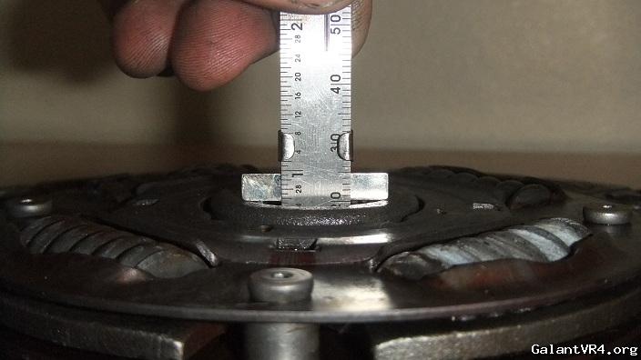

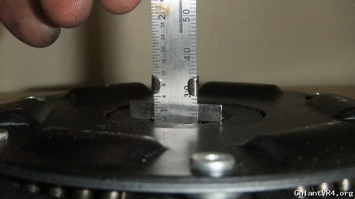

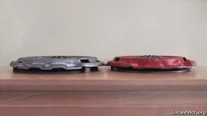

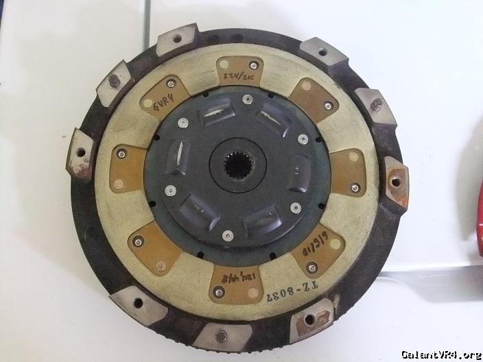

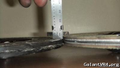

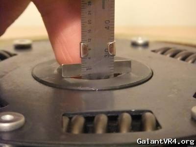

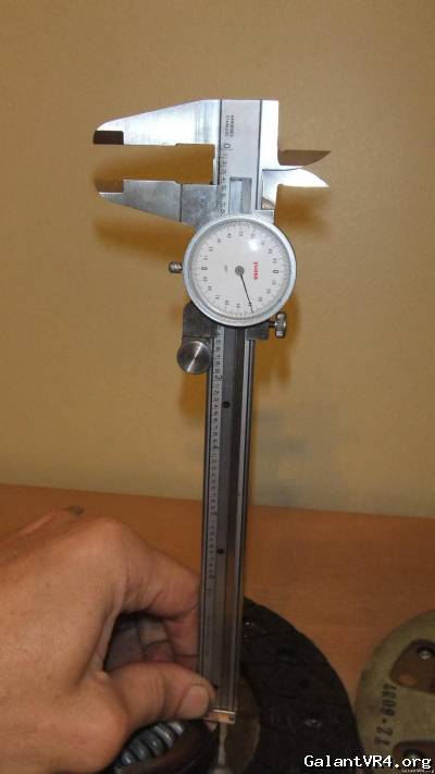

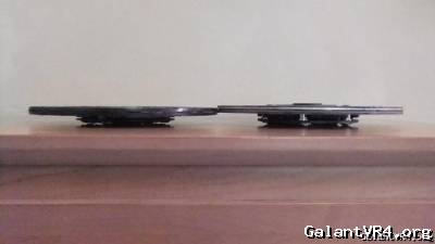

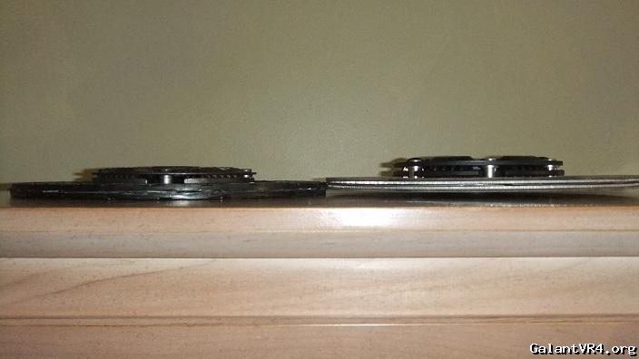

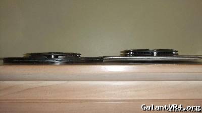

I pulled the stock Exedy clutch from 1078 for comparison. The PP has almost the exact same dimensions, but the disc is different by a good amount. See pictures below:
The major area of concern seems to be the distance between the surface of the rear spring cover plate to the mounting plate for the friction surface. There's about 0.130" difference between the two. It appears that ClutchNet may have sent the wrong disc, as there's almost no way I could get the flywheel machined to make up that difference in step. I'm quite sure going from 0.609" to 0.612" would not even come close to making this be able to work.

Well, I swapped out for the gently used Exedy stock clutch shown above, and the problem went away. There is still some grinding in 1st and 2nd, but that's more likely attributed to bad synchros; the reverse crunch is gone. I can get 1st and 2nd to not grind, if I give enough time for the gears to spool down.

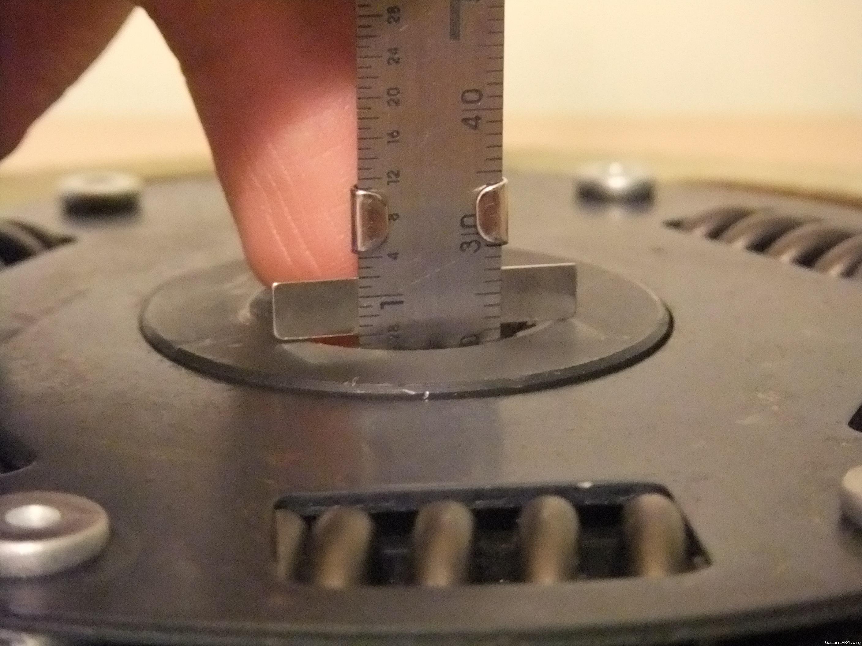

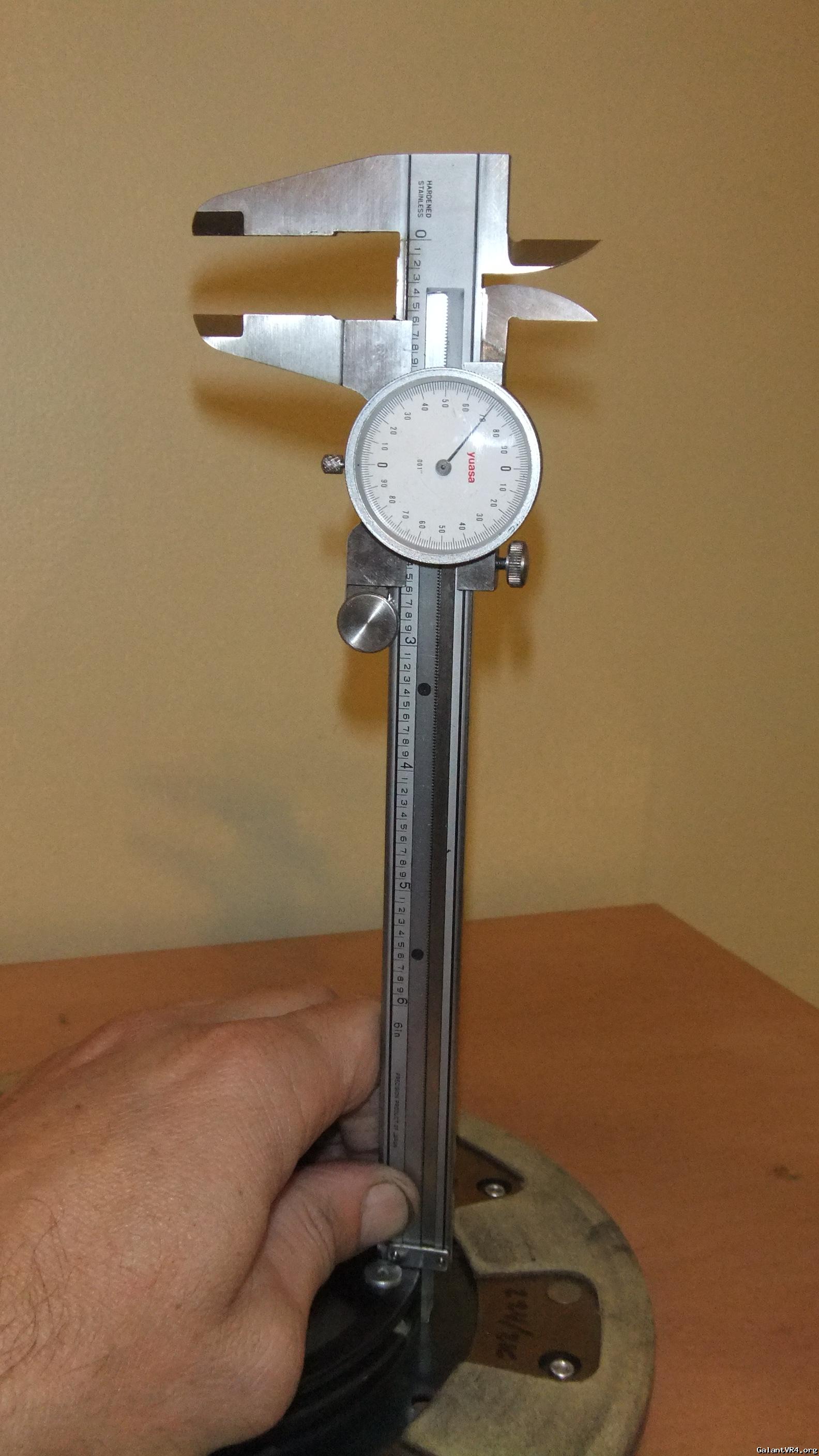

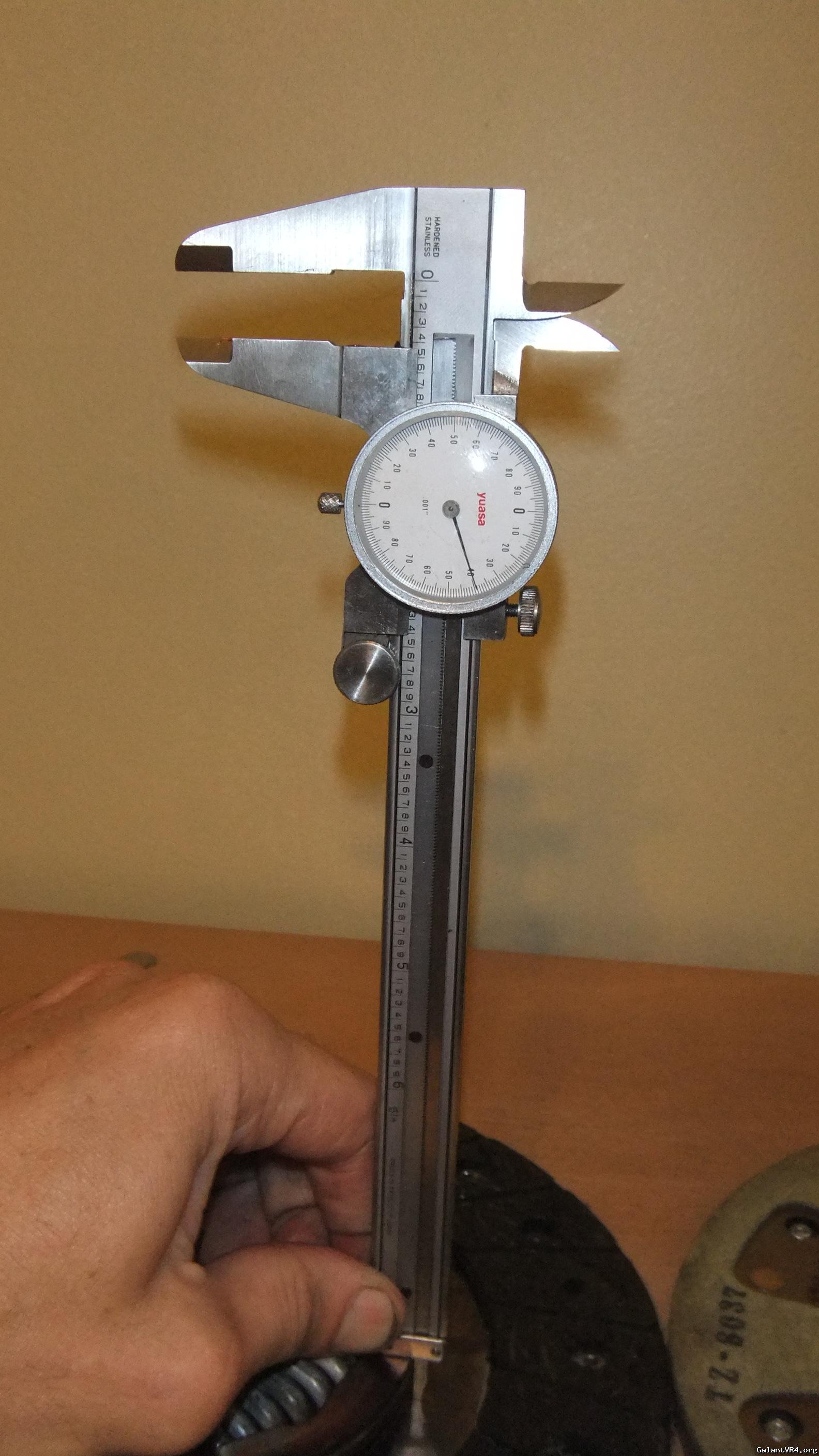

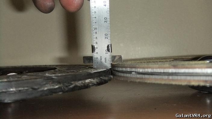

Apparently the problem was in the design of the clutch disc. I sent it back to ClutchNet and they fixed it:
I called and the guy I spoke with (Russian or some other East European accent) said they replaced the spring housing with an open design. They must have used shorter spacer rivets to hold the spring retainer plates together, too, because the assembly is now MUCH closer to stock (actually a little shorter now, but that shouldn't be a problem). The one thing that didn't change is the hub part. As you'll not if you look closely, the stock disc has the hub ending right at the forward end of the disc, so that the disc rests flat on a table top. The ClutchNet disc, however, has the hub extending about 6mm forward of the front edge of the clutch disc. I don't think this will be a problem, but won't know for sure until I install it. I will keep everyone posted. Basically, though, this looks like it should fix the problem.
So, in short, if your ClutchNet disc looks like the one I first posted, you might want to send it back. They were really helpful, and if this all works out, I'm going to post up (or add to) a Good Guy thread for them. Either way they deserve it, since it has been more than a year since I ordered the part, even though the part had never actually seen the road.
