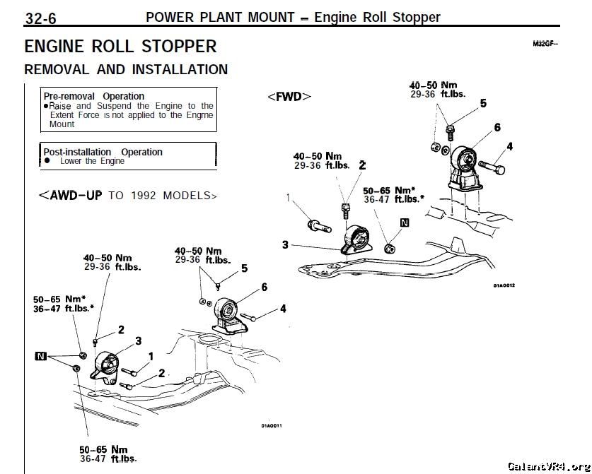

I really need the front motor mount and I'm thinking of picking this one. Just wanna make sure it will fit anyone try this out yet?

I bought the both the front and rear engine mounts from RockAuto back when I had my engine out last summer. They fit, and are holding up just fine.

Yes, 9708 is for AWD Galants. The 8103 mount is for FWD:
