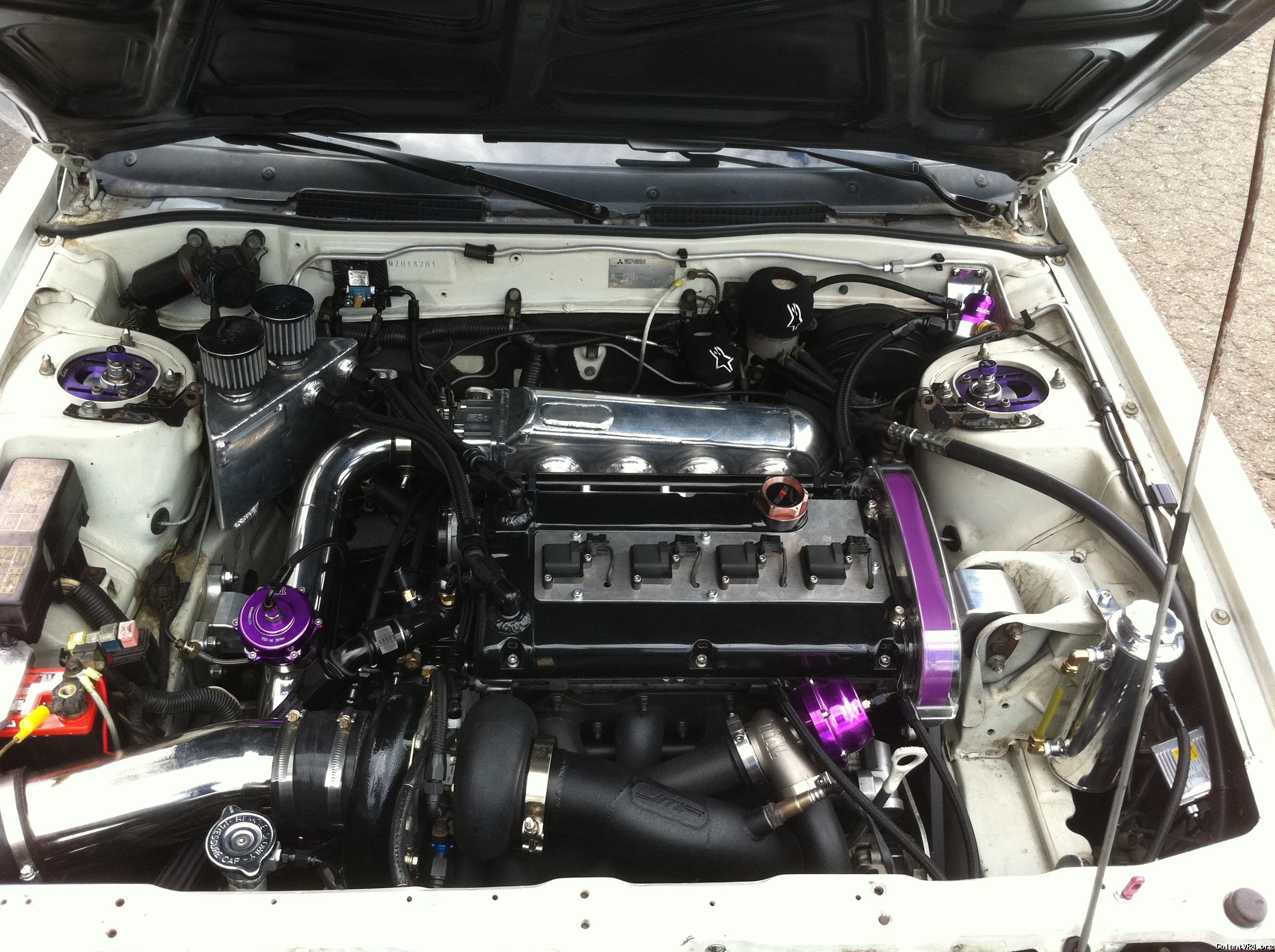

Does the coolant neck and fittings look familiar?
I mean I'd try to straighten it with the above method which should work, it won't be perfect but worth a try. Also you could just buy another one of those rads from summit and have someone weld on the fittings you already have on the old rad.

YUP... Haha that's the car it came from, I think... I know you aren't the guy who sold it to me, but you sure do know the guy I bought it from then. Haha. Yeah I will go ahead and try that. If it leaks, it's okay. Good garage ornament I guess. I tried looking for another sirocco and doing just as you said, but they're in the mid to high 300's range, and I'd rather buy a bolt in Koyo for that money.

Yea he came down and bought pretty much the whole front clip off my car, also thats my car in the picture. I'd recommend sticking with that style radiator as its going to be pain in ass to move the lines and make them work properly just my two cents.
