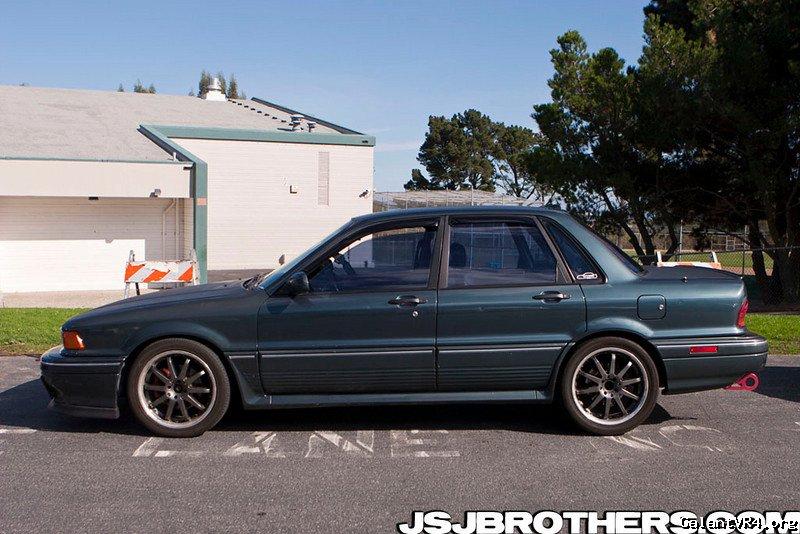

any pics of galant with evo8 suspension with lowering springs
Same pic i had in the other thread. EVO 8 struts Tein springs.

Evo KYB's with one coil gone on the front and stock evo springs in the rear. 215/45 17's

sorry though this pic was going to show more than does as far as ride height... EVO8 suspension with prokit (I welded the rear lower strut mount in a position that would keep the rear slightly higher/similar to the front ride height) I'll be back to my car in 4 days now and will be sure to post some other pics.
