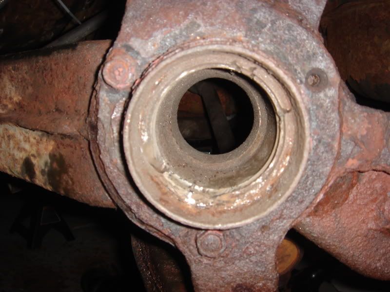

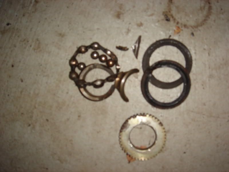

Any ideas? Rear wheel bearing.
donkeylips
Jun 18, 2009
552
Rochester, NY
Slide hammer - nothing.
Socket and deadblow from backside - nothing.
Sawzall - nothing. Can't get started, too hard.
Dremel/cut-off wheel - would work, but can't get it in there.
I really don't want to take off the trailing arm what with the eccentric bolts and everything.
I hate you guys that live in California.
LILEVO
Sep 20, 2003
195
Wisconsin
Damn that sucks. That bearing has always came out with the hub stub for me. Did you pound out the smaller bearing already? Use a mapp torch to heat that thing up good and pound it out from the inside /ubbthreads/images/graemlins/cool.gif
Otherwise a brand new sawzall blade has always got me through bearings.
SouthCaliVR4
Jul 31, 2010
984
North county San Diego
Holy rusted metal Batman!!!! I'd be looking to replace that. along with anything else under there that looks like that. You need to stop spending money on anything other than rust repair or soon your car will be scrap.
donkeylips
Jun 18, 2009
552
Rochester, NY
That's why I own 3 Galants. This is the winter beater. But it's just a little bit too beat.

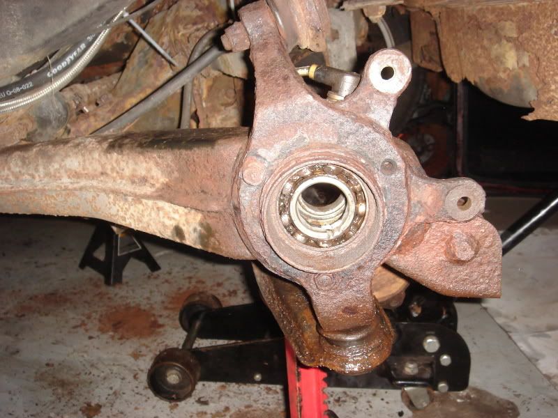

The inner bearing is out in the pic from my first post. What you may be seeing in there is the ABS ring.
Getting the inner race out was supposed to allow me to cut the outer race with the dremel. So far I've only managed to get a couple of pie-shaped wedges out. It's rust-welded in there good. Not sure if I'll ever get it.

My air hammer chisels are too soft. They're getting all chewed up. What it's leaving behind kind of looks like solder.

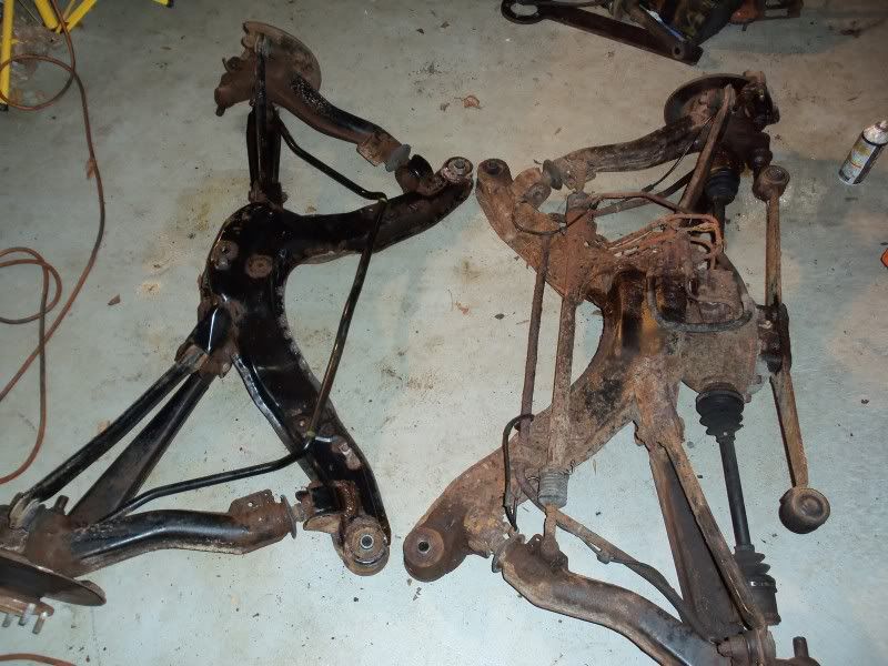

Well I'm a quitter. I just bought a complete rear subframe/suspension from a guy with a 1g that hit a deer. It's almost rust-free and already 5-lug with good bearings.
Thirsty
Sep 6, 2007
53
Brisbane, Qld, Australia
Gee, I feel for you poor blokes with the salt on the roads. /ubbthreads/images/graemlins/bawling.gif
I was complaining my subframe was dirty but it is mint compared to those pics. Come live in Australia...LOL /ubbthreads/images/graemlins/applause.gif
Ross
donkeylips
Jun 18, 2009
552
Rochester, NY
No wonder my 4WS didn't work! I'm shocked!
This picture actually makes the old rear subframe look good though.

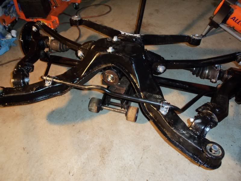

After POR15 and liberal use of anti-seize. Decided to use the lower mileage 3-bolt rear diff from a '91 Talon.
Back on the streets in no time:
I'm cleaning mine up too! Im just wire wheeling off the surface rust and hitting it with rustoleum though
