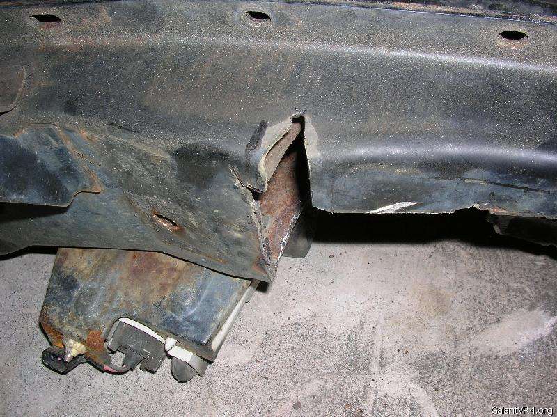

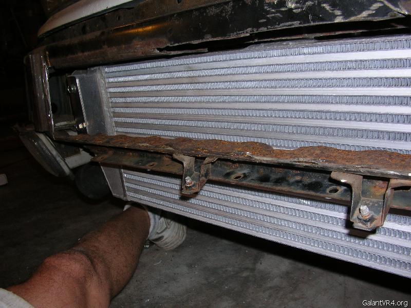

I finally tackled the Dave Brode complete installation this weekend, but I wasn't sure where to start, as the documentation is rather limited. So, I thought I'd take some pictures as I went, to help the next guy. My first question was WHERE/HOW to mount the IC?? /ubbthreads/images/graemlins/confused.gif It seems that Dave is confused himself, because he emailed me that he had maybe installed the one bracket wrong. It turned out that he had installed BOTH brackets BACKWARDS, and on the WRONG SIDE! /ubbthreads/images/graemlins/shocked.gif I know I took some pictures of the IC mounted, but they've disappeared from my camera! /ubbthreads/images/graemlins/mad.gif But, on this picture, you can sort of see that bracket through the hole in the bumper.

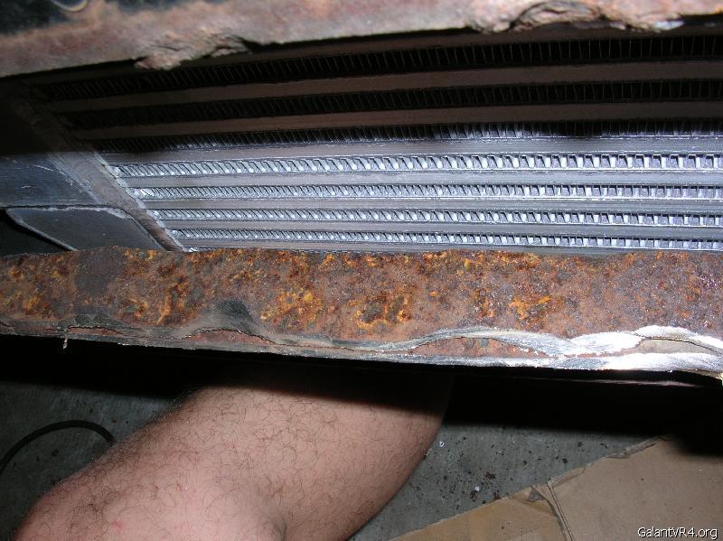

The brackets should face back, up, and out to the sides, so that they can be attached to the ends of the frame rails that protrude from the front of the radiator support. This is the same, rectangular protrusion that the stud sticks out of that the 14mm nuts go unto to hold the bumper on. I mounted the brackets about 1/4" below the top of that protrusion, as I didn't want the IC to be pushing down on the bottom of the bumper cover, as my RRE one does on #1886. However. I cut it REALLY close, as I could barely slide the bumper on later. I had to loosen all the bracket bolts, and drop it down as far as it would go, and it just fit. /ubbthreads/images/graemlins/blush.gif As you can see in the picture above, there is

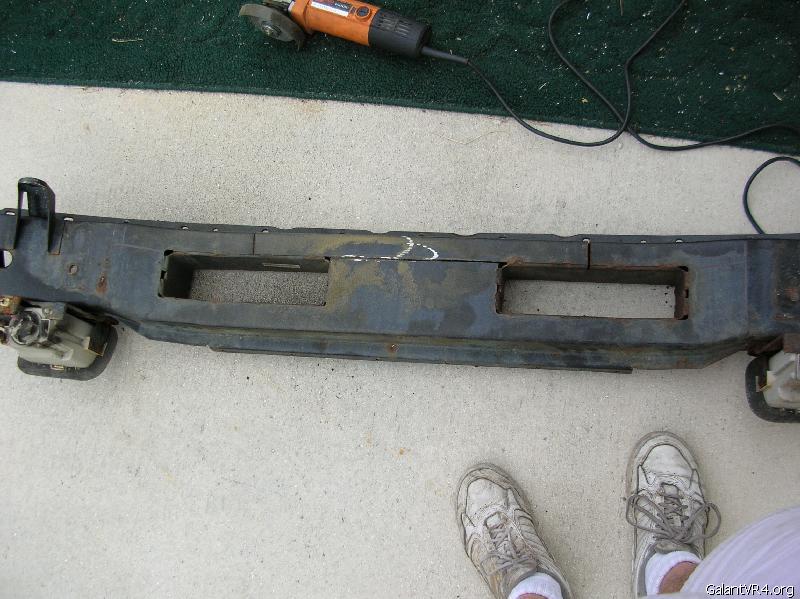

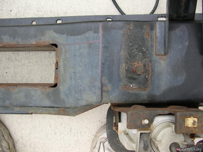

I first made some marks with a magic marker by holding the bumper up to where it should be installed. A second person to help steady the bumper would REALLY help.
Then, using my handy-dandy Harbor Freight angle grinder, I started cutting off what had to be removed. I wanted to leave the complete, boxed section at the top for some strength, and I also wanted to leave the lower bumpercover-support strip, so that the cover doesn't sag down.

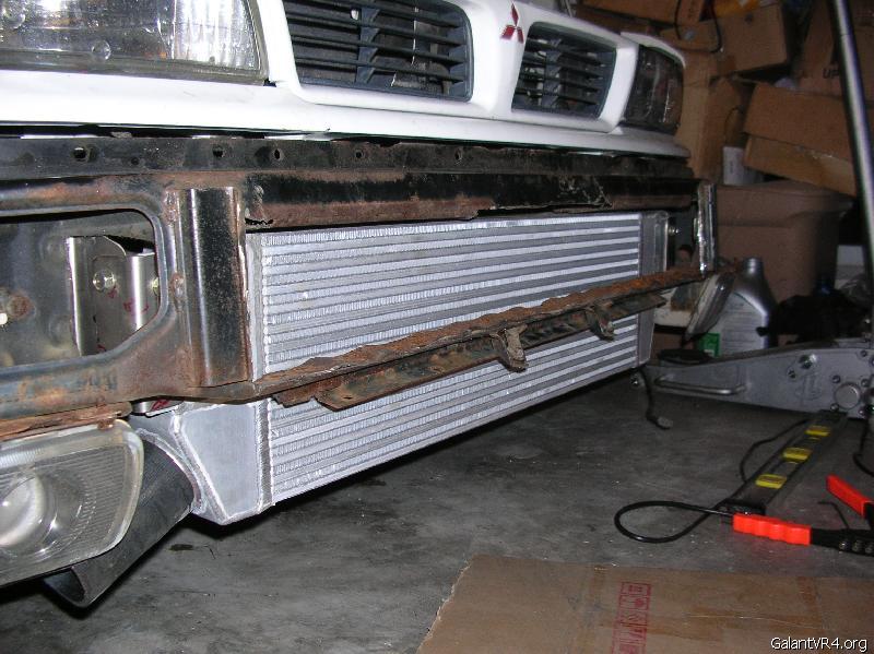

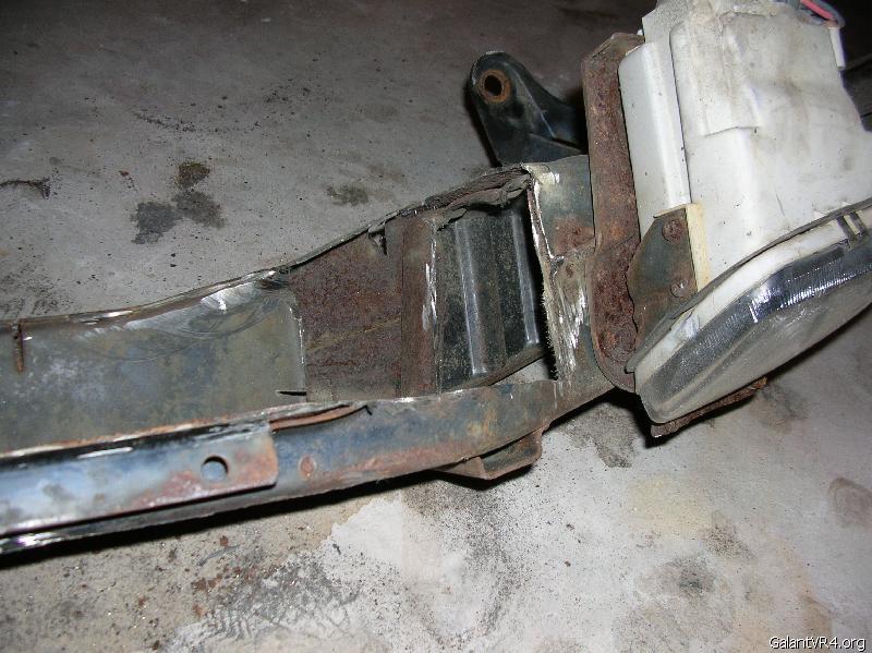

You also need to completely remove those metal dividers in the ends of the bumper, seen here:
But, missing here:

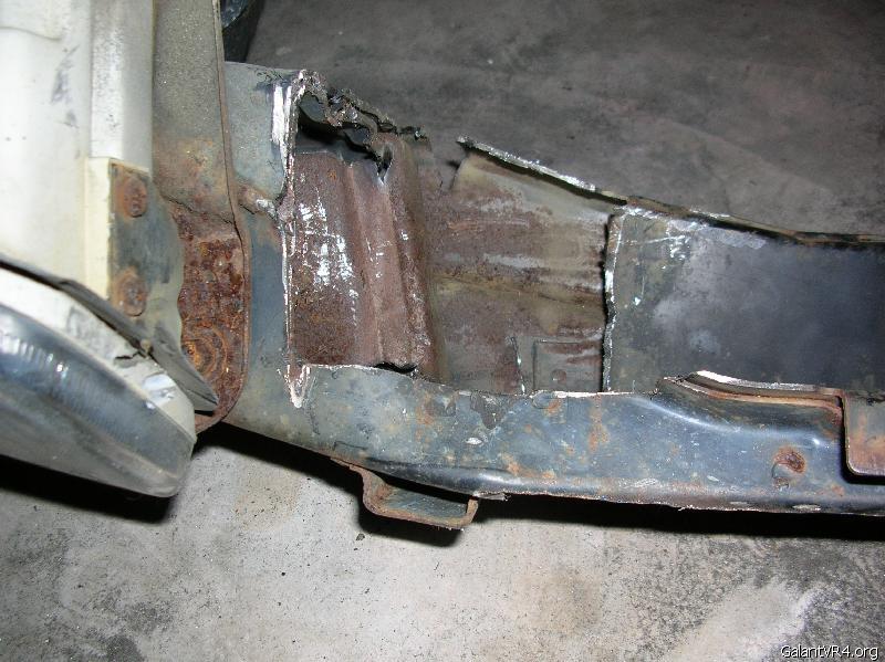

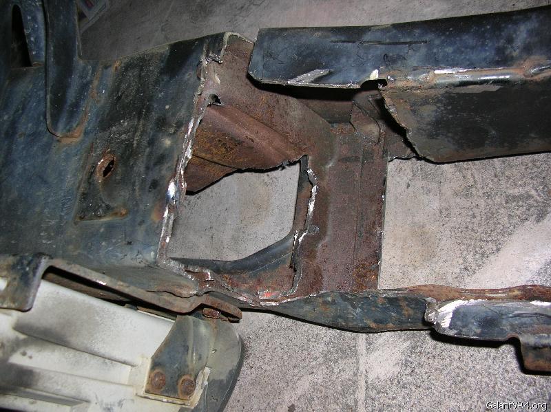

Actually, this is a better picture here, showing the missing divider you need to cut out, as well as the cut you need to make straight back from the front of the bumper underneath:
I also had to notch the top of the bumper to allow the IC brackets to slide through a gap:

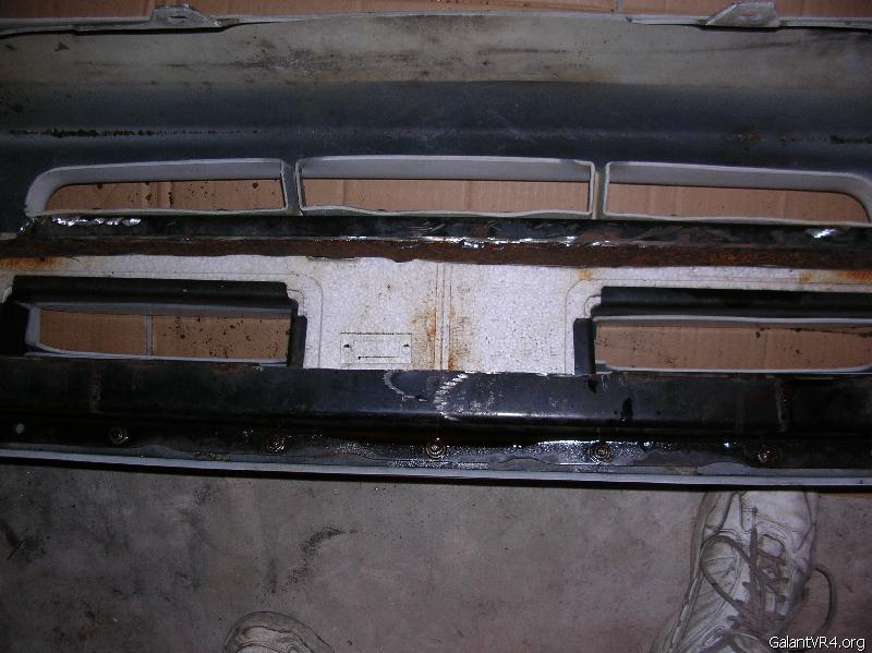

Here is what it looks like when dropped back into the bumper cover:
As you can see, I actually removed alot more than I had to, but I was sort of working in the dark here. Depending upon how much you plan to open up the bumpercover grill, you may want to remove more or less material than I did.
I also could have left more depth to the front brace, which supports the bumper cover:
As you can see, there's a healthy 1" gap there between the brace and the IC. You could leave more material if you wanted it stronger structurally.Here's one last view from the righthand side of the installed bare bumper.

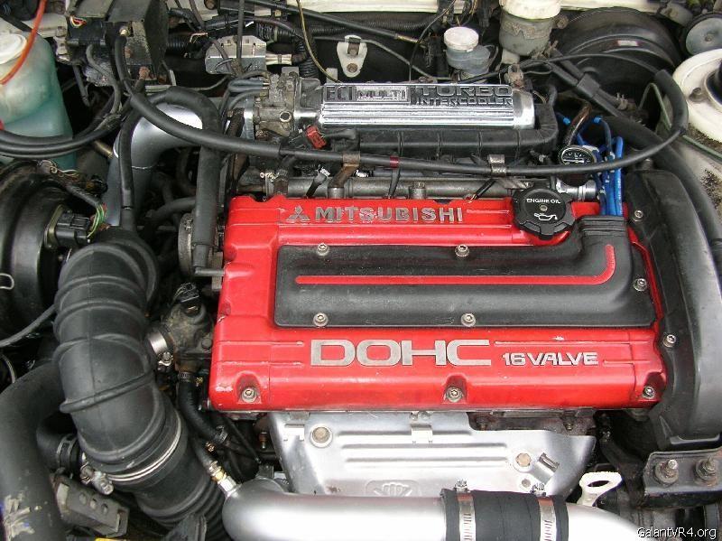

Here's a picture under the hood. The pipes fit great, following the stock route with no issues. The only problem I could see is that its going to make replacing the alternator more difficult.

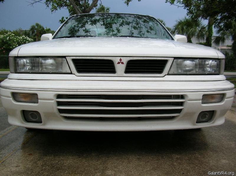

Talk about STEALTHY! /ubbthreads/images/graemlins/devil.gif
As you can see, the bumper cover still fits perfectly, no drooping, cutting, or reshaping of the cover at all.
