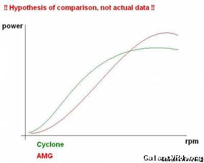

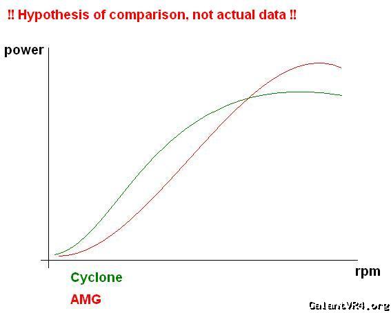

The AMG WILL move more air, but it's a question of where in the RPM range it does it, and is it usable. I suspect, however, it moves LESS air in the lower RPM ranges.
Where did you see the cyclone tails off after 6500 rpm? Everything I've seen says the cyclone flows slightly less up top, but it's as near as makes no difference to a 1G.
Edit: Here's a quick paint drawing of what I'd generally expect the dyno graphs to look like, if the only thing changed was the intake.

What is really doing my head in is why the longer runner in the AMG cyclone is the larger diameter one. Irrespective of HOW the manifold operates I would still expect the design to use a longer smaller runner for low rpms and a bigger shorter runner for top end. Of course, I take your point that being NA perhaps it uses the larger runner most of the time and only opens the smaller runner at significantly higher rpms when the first one is becoming restrictive. If that is true it really would seem the AMG manifold is a poor choice for a turbo application. Not that it would take much to alter the activation point OR if the runners do act independently to switch polarity so to speak to use the smaller runner at first and the larger one later but then everything is still ass over tit because your small runner is short which won't produce as much torque and your larger runner is now long. The latter might not prove a significant issue but the former would probably negate much of the point of running the dual runner setup in the first place.
I think once I have done the measurements on the two Cyclones, I will send them off to be cleaned up media blasted, powder coated and possibly get the plenum sections extrude honed. I'll gasket match and reassemble them when I get them back. I'll go check out what dyno options are available and see if I can get a discount for booking a number of sessions in bulk. If I can, I'll get the car dyno'd as it stands to use as a base line and document the actual increases in horsepower achieved with each mod or group of mods. I have two Small 16Gs so I can throw one on in the stock housing and then swap in one with an extrude honed turbine and compressor housing to see if it makes any difference. I cannot promise to be able to document every single mod individually (for instance the extrude honed housing will probably be ceramic coated as well, so we won't be able to see which process yielded the most benefits) but hopefully we will see how much is bling and how much is worth doing.
Somewhere towards the end of those mods, I'll swap on the AMG Cyclone and see what effect it has. If it isn't that effective I'll pull it and save it to put on the NA GTi and I'll swap on the Cyclone with the extrude honed plenum and see if that yields any power increases as well.
Going back to CAMS which is what this thread is about (although I do believe there is a genuine correlation between cams and intake manifold design which should be addressed), I'd be interested to hear what if anything you can tell me about the differences between NA and Turbo cams especially in relation to 'overlap' to find out if it is worth using a full AMG head. Logic states the parts matching would already have been done here and we would simply be using the turbo as a pump to flow more air. The compression ratio would require more thought and the activation point might need to be addressed as the point of restriction would be reached earlier but since the AMG was designed to rev a bit higher and hold torque longer, I have a feeling this approach might have some benefits if we aren't shooting for huge power.
cheekychimp
Apr 19, 2004
7,333
East Sussex, U.K.
Actually that's pretty useful information thanks. I had been looking for info as to why the NZ facelift spec GTIs had 15 horsepower over the pre-facelift ones and it seems it was due to a hike in compression. That thread says the early GTI was a 9.5:1 compression, whereas my information said 9.8:1. I'll need to double check that.
But it means that the extra compression is responsible for most of the power increase between the early GTIs like mine and the AMG. Still means the Cams, IM and Header only accounted for SEVEN additional horsepower. I hope that the power and torque curves show a more serious benefit or it doesn't look like that manifold is worth much at all.
Did you notice at the bottom it said German Tuners had made 200 bhp on track cars. I'd like to see what mods they did. A 200 bhp NA Galant would be cool.
Edit: From that, it appears the AMG cams in addition to being hollow and lighter weight have a 260/264 duration and 394/374 lift.
