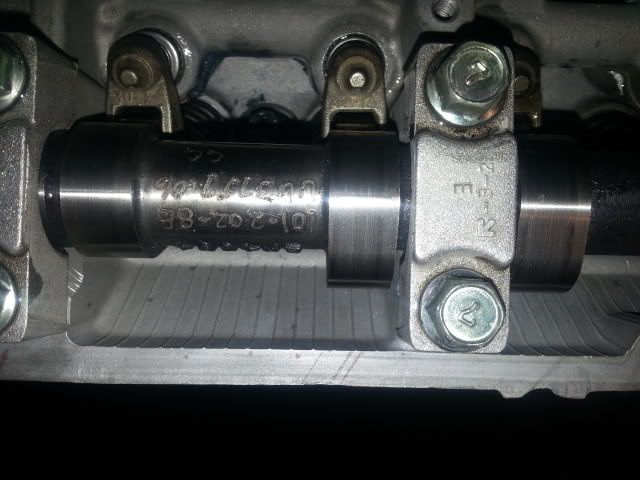

so i spent a couple hours pulling out what i was told to be FP1 cams to install the cams i picked not long ago that i think are FP2 cams.
after pulling them out last night, i can't find any info on them from the numbers?
XE250HR 108* uj5180
XE251HR 106* uk 1066-04
what i am installing, along with BC springs and retainers(should be FP2's)
101-201-8I
101-202-8E
after a little goggling this page pops up but i can't find any info on these numbers. anyone heard of these cams?

thats my FP2 exhaust cam... i got them used, but trust the guy who hooked me up with them.
