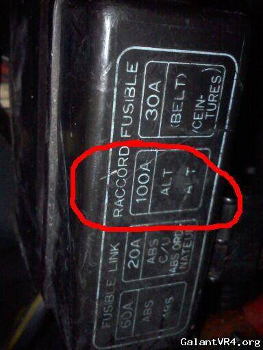

holeshotmoe
Apr 7, 2005
1,298
VA
++ on rechecking the alternator. But if it is okay, then check for +12V battery voltage(car on or off) at the big terminal on the alternator. Not sure how you rewired the battery but...On the stock wiring, it is supplied from the battery through the 100A fuse that's inside the little black fusebox right at the + battery terminal (picture below). If the fuse is blown, you won't have the 12v needed for the alternator field windings so you won't have any output. On the small plug, you should have +12v on one (can't remember which) of the two wires when the ignition is on. I think this one is powered through a fuse and is labeled "Charge" or "Alt" in the under dash fuse box. If either fuse is blown, then you probably have a short on the respective line.
