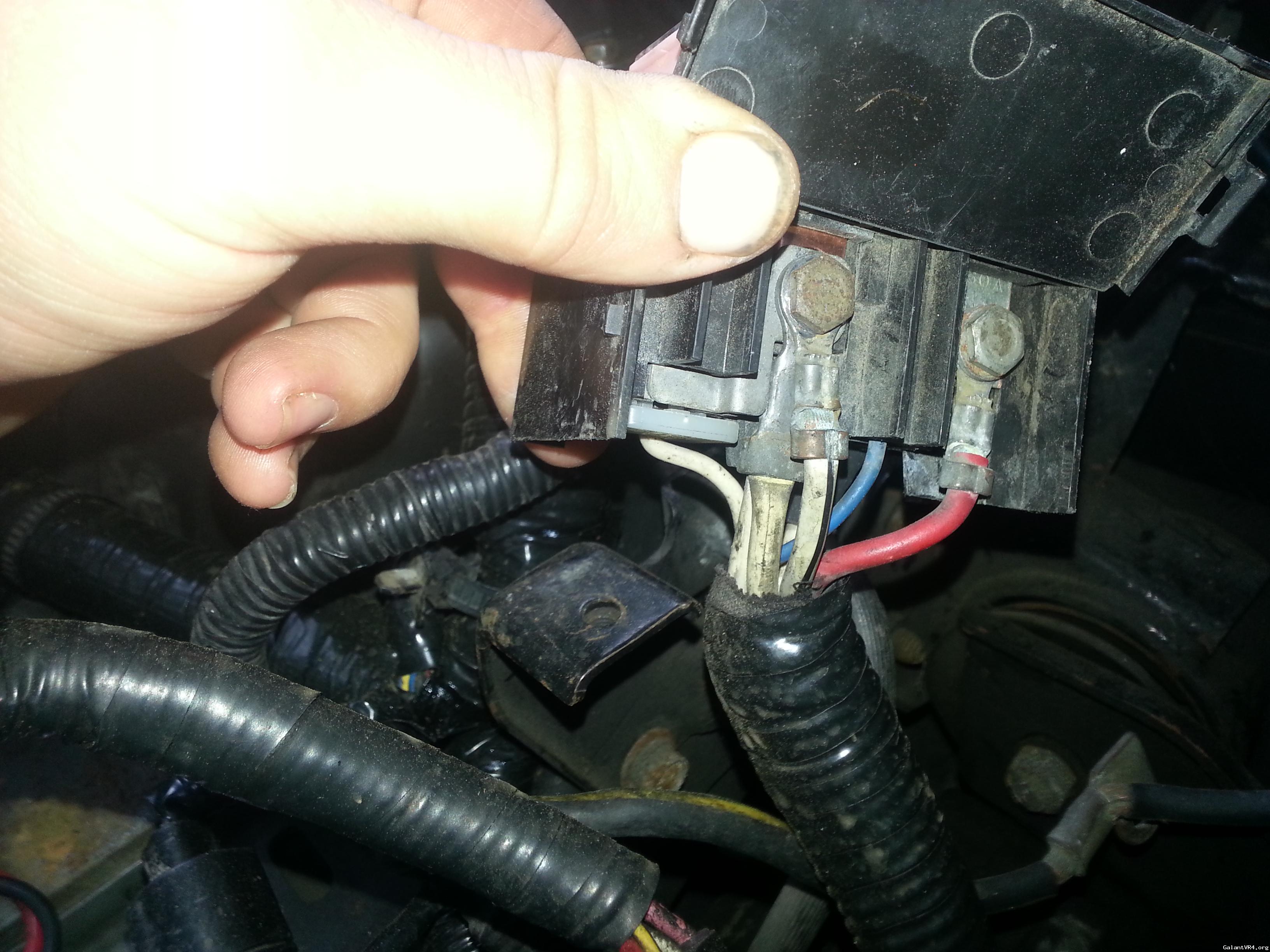

Ok so the new battery i just installed is dead. I checked amprage draw on every circuit. None. Untill I removed alternator fuse. The unit has 200 miles on it. I ha1e to replace it? What's broken and how do I fix it? Its the double line that draws current.

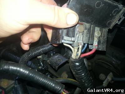

Left these wires disconnected last nigh battery did not drain. Tested them both for draw and could not duplicate my readings from yesterday.
Can someone confirm both these wires should be tied to the same lug?

I did manage to narrow the draw down to one of these wires in the picture above. The harness was in good order when I installed it a few months back. I would just hate to replace this alternator to have the same issue because its caused by over heating.

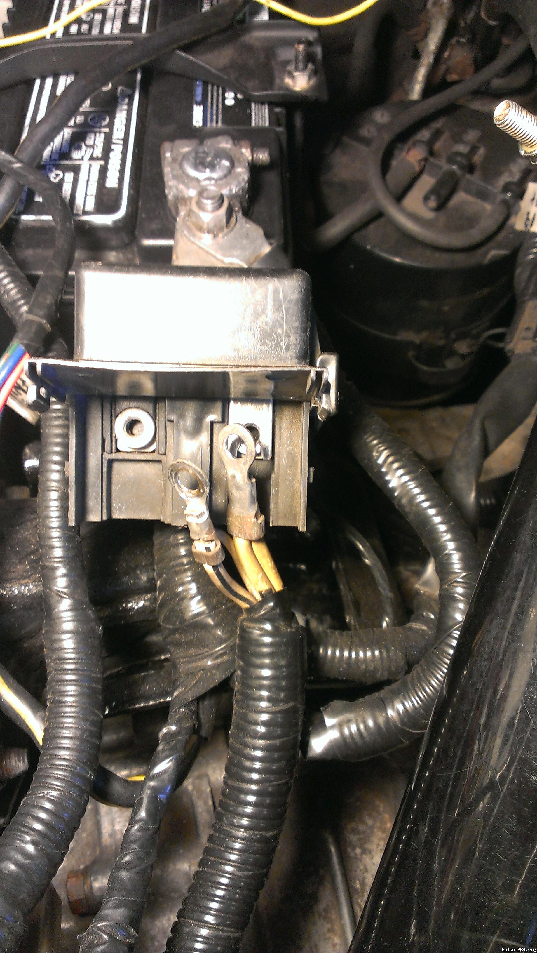

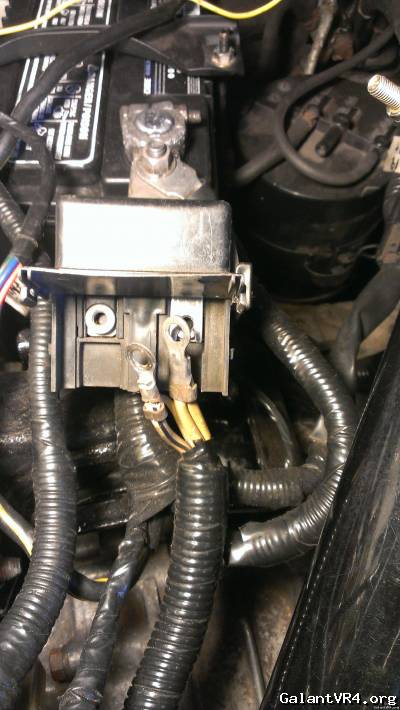

In the picture above, are both the 2 wires together and the wire with the black strip supposed be going to the alternator fuse? I want to rule out that it's wired wrong.

The wires on the right are a different circuit. But you have the same 3 wires on alt circuit. Thanks for the picture.

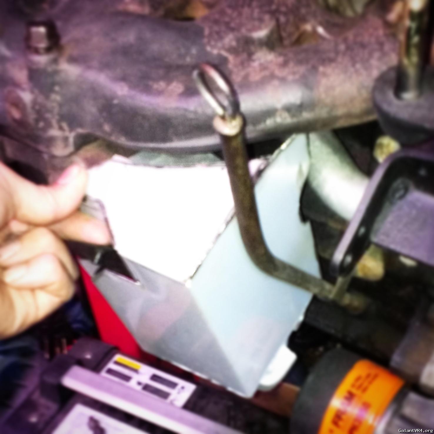

I have no draw when I tested today. I think its a heat issue for the alternator. So I spent some time in the garage making a heat shield.
Its cut and bent stainless, just need to weld polish and put some bolt holes in it.

Oh I believe you, I did the same thing. I think it's the alternator itself getting hot. The diodes inside or something else getting over there rated temperature and then creating a short somehow. everything is connected for three days, and for three days i haven't started the car for more then a minuet or two. Battery is still at 12.86V. I can swap out the alternator for the stock 90a with 87k, but its so filthy. I don't want it to do the exact same thing because of heat. Would have tig welded the shield I mocked up but I put a water pump in my wrangler today. Wouldn't you know one of the bolts broke off in the block... so needless to say it took a lot longer than anticipated. All done though. Welded a nut to the piece sticking out and after a couple attempts I was able to back it off without breaking the weld.
Edit: added the heat shield and drove the car all day. There was no drain on battery over night. So I think I'm good.

Found my short.
Looks like there's a pin hole leak in my water pipe and when it got wet it would short and when it was dry it wouldn't. Had the alternator checked and passed test. I'm going to insulate some more and fix the coolant leak. Not sure how, but it seems I have to take the water pipe out now.

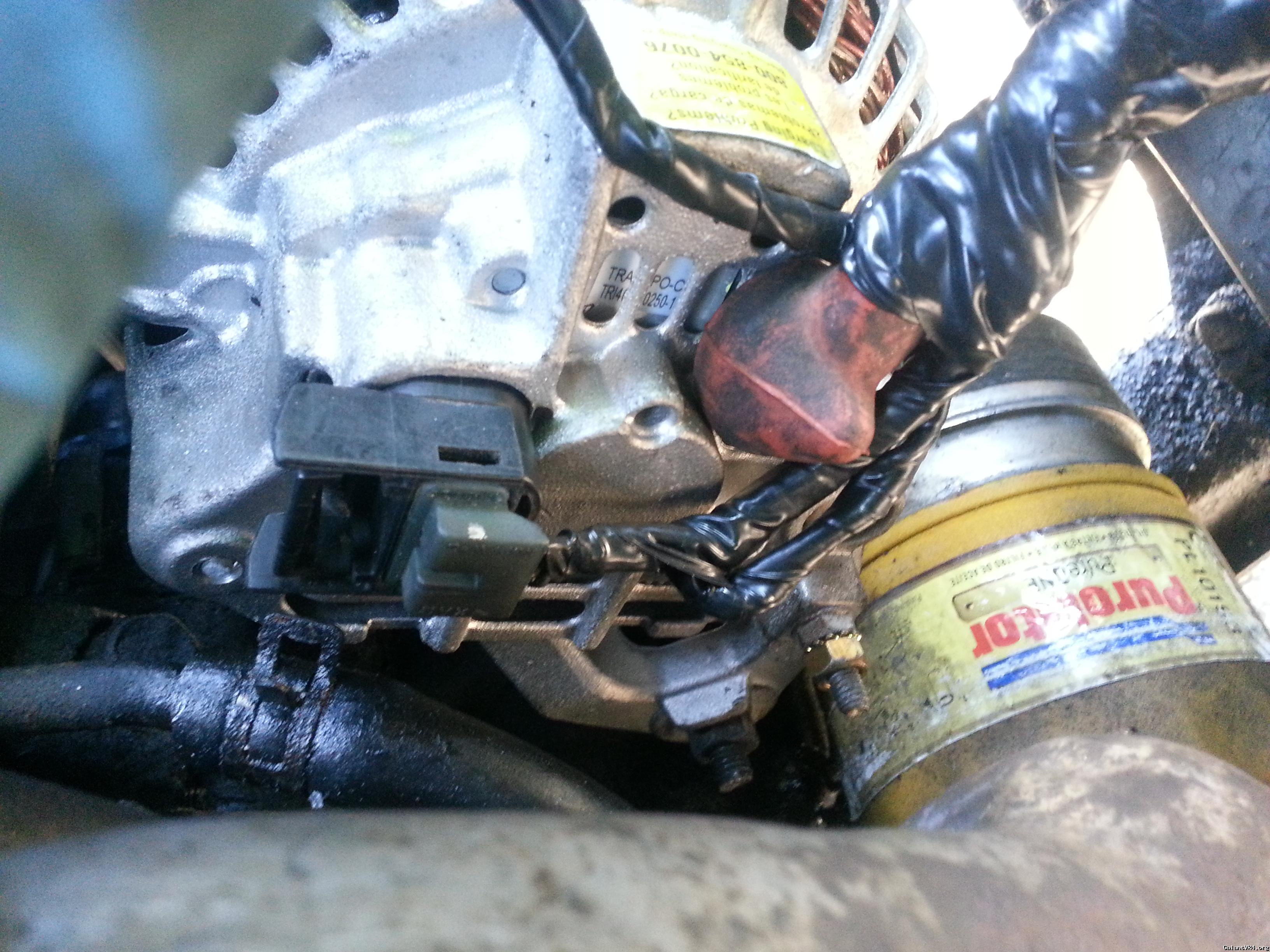

Well my scernario is a bit different. I swapped out my shortblock and when I put it all back together my volts were fluctuating between 13v and 16v. It was just cycling and all the lights on the car would dim and get bright. I drove it for a bit before the volts just stayed at 16v and limped the car home. I pulled the alternator, got a warranty replacement from advance auto. I installed the alternator, went to the trunk to hookup the battery and walked up front to hear crackling and popping sounds from the relay area, and saw smoke from the alternator. I ran to the trunk to pull the power from the battery. I disconnected the cables from the alternator to see one had a slice in the sheathing that was shorting against the metal wire holder on the back of the alternator that is covered in plastic when it's not worn down. I pulled off the wire holder and moved the wires away from that same place you had an issue with and now I'm good.
