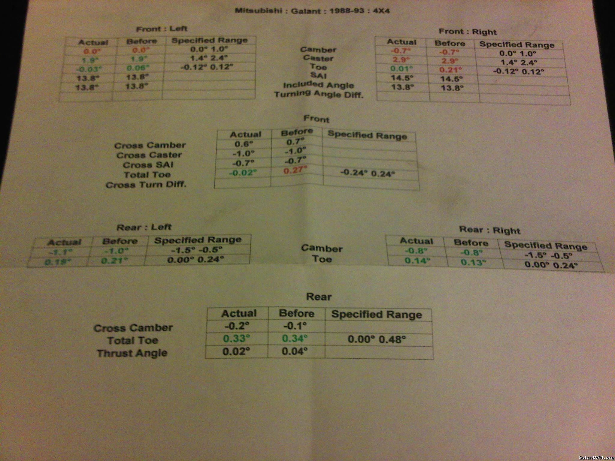

Am I missing something? They didn't do their usual, "Here's a dozen things wrong with your old car that you should let us make awesome margins fixing for you" spiel, so I'm guessing they didn't have any trouble aligning the car, and didn't find anything that looked wonky. They gave me the print-out showing the numbers before and after, too (don't have it on me ATM), so I dunno.
I'm thinking an alignment means the car should track straight. I know they did something, but it still pulls left just as much as always.

Did they just do a toe and go? I know in order to set front camber you need to e longate the front strut tower bolts in order to get some adjustment out of them. If you could post a picture of the print out that would be helpful. At the very least the specs for before and after.

What are all the numbers on caster, camber and rear toe as well? I know they are not all adjustable easily, but cross camber and uneven caster can cause some pull.

I'll see if I can't grab the printout here in a bit. Thanks, fellas.

Hmm your front toe angle ever so slighty points to the right, your rears are favoring the left though. The rear left wheel has more pull to the left then the right to the right by .05*. It definitely isn't perfect by any means. Front right wheel also has .7* of camber in while the left wheel has none.
While the alignment isn't perfect, it should be pretty close, maybe try rotating tires and checking the air pressure. If your not happy with the alignment though I'd definitely bring it back and show them the problem.
