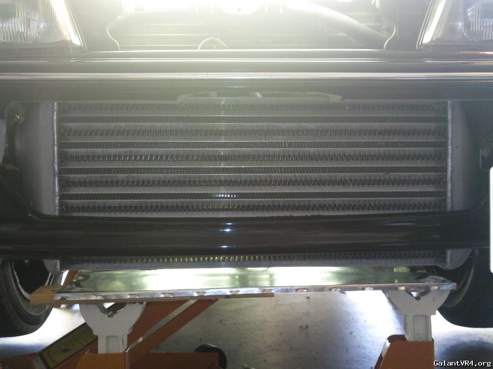

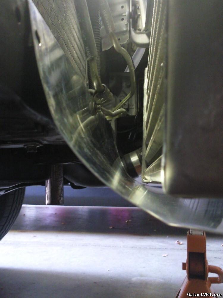

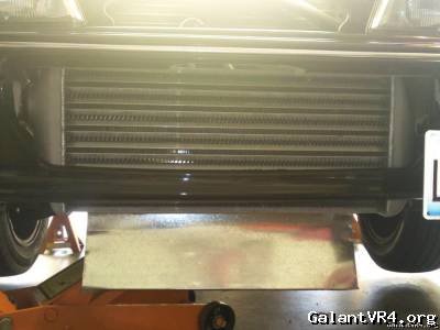

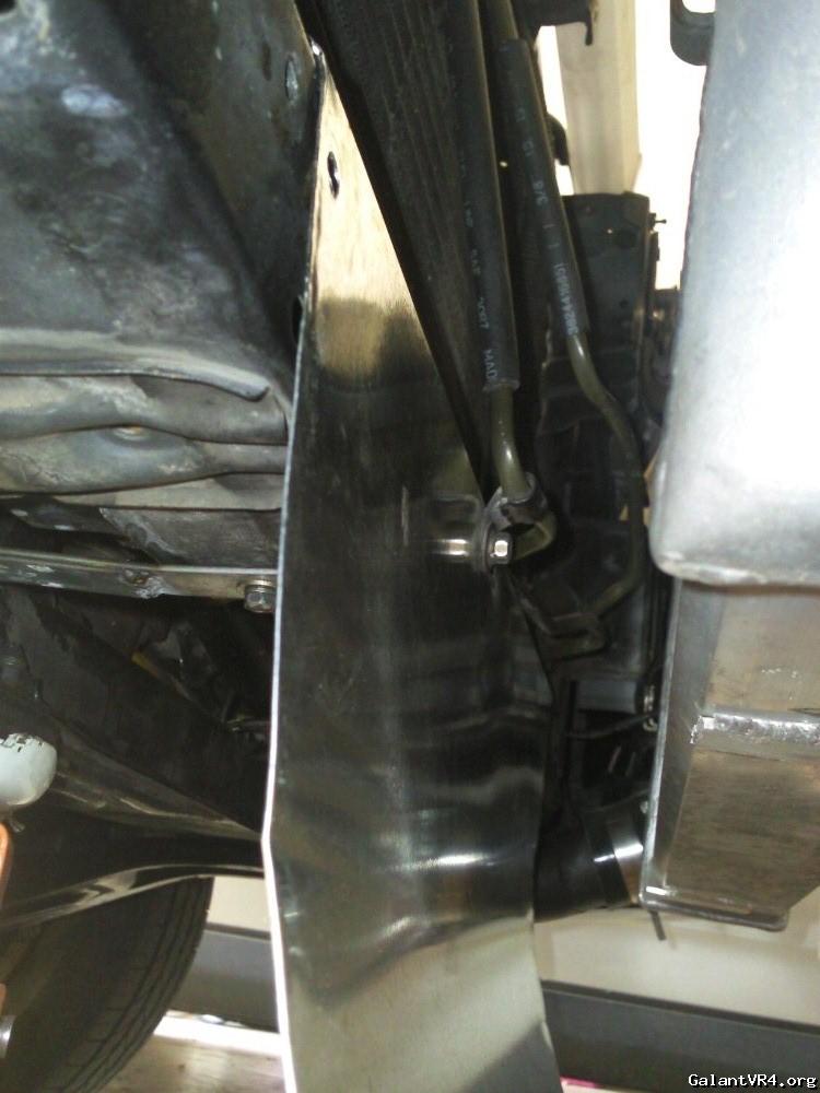

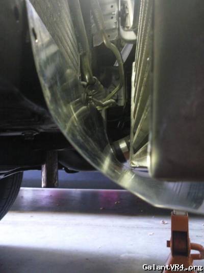

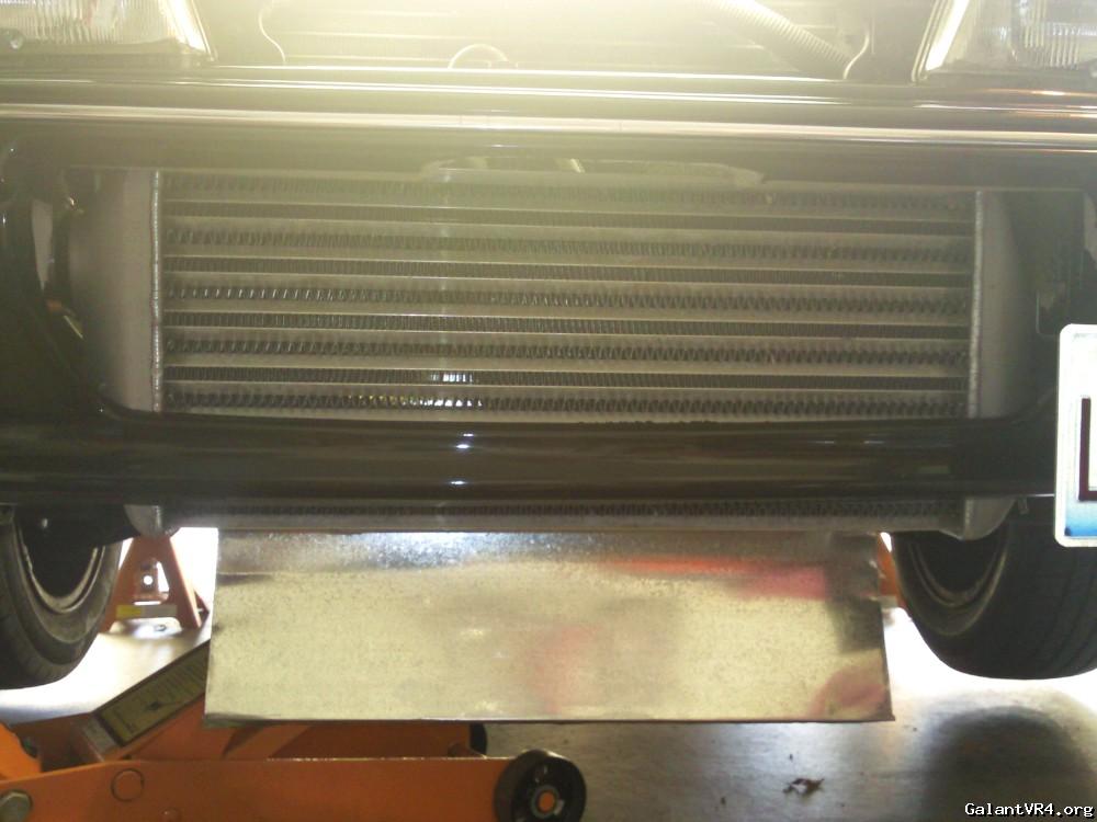

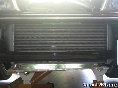

On my never ending quest to try and solve my civic radiator problem, I decided to try an add an air duct. I have 2 options on doing this and I need peoples opinion on what would be more beneficial.
1. Having it curve up(almost like a quarter pipe) starting under the FMIC. The space between the sheet and FMIC would be 1-2".
2. Having it just straight down and about 2-3inches(if not more) lower than the FMIC.
Let me know which one you guys think will flow more air to my radiator. I`m trying to finish this tonight so that I can compare my results from last night. Thanks...

I'm gonna go with the curve, as it should direct the airflow upward more smoothly. I'd also make sure the top and sides of that radiator are walled-off to force the air through it, otherwise you'll just be accelerating air past the fins.

I vote neither. Any ducting like that will likely create a high pressure area before the radiator. That high pressure area will cause air to go under your car, not through it. If you have a cooling problem, you need to find the real problem. Ducting would just be a bandaid IMO.

Seems like your duct work will push air up and not in! It might not let the air that is able to get in above the FMIC to push into the radiator. Find the reason for your overheating....To small of radiator. I have a honda radiator in my shop that would fit nicely in my car, but they are half the size of the stock one. How is something half the size supposed to cool the same or better as the stock one?

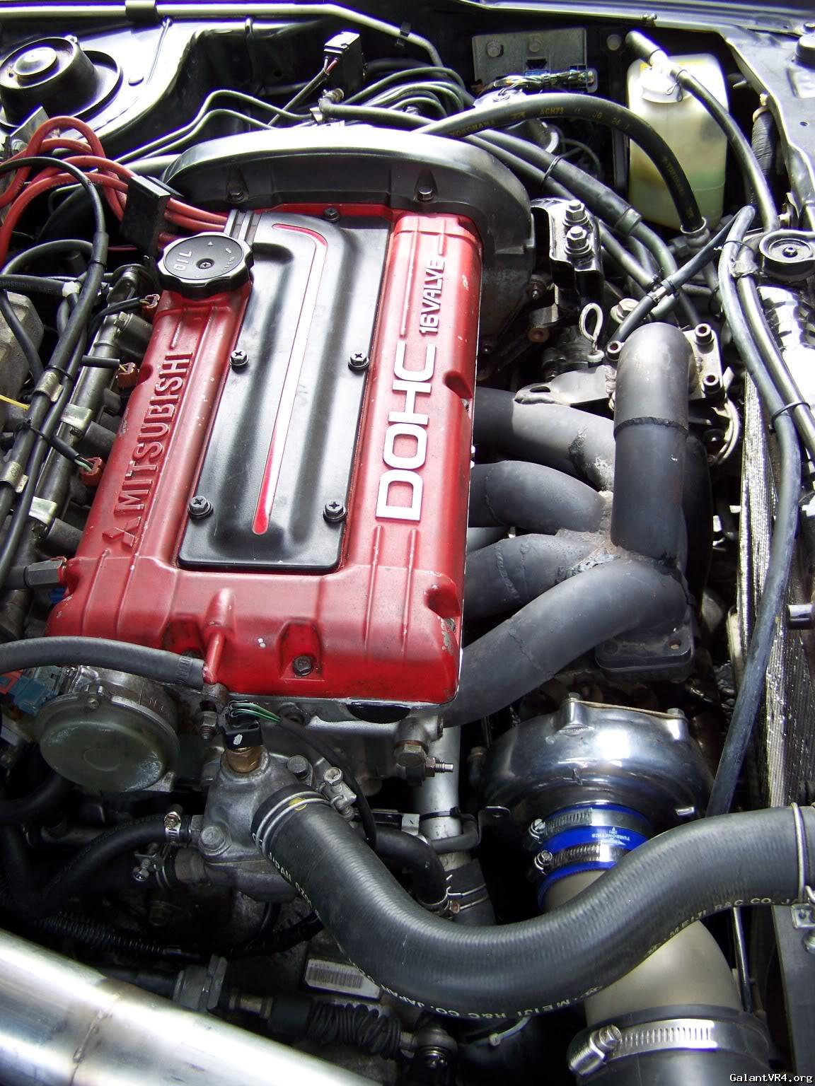

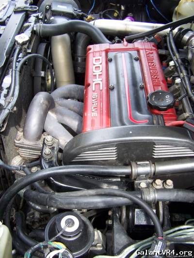

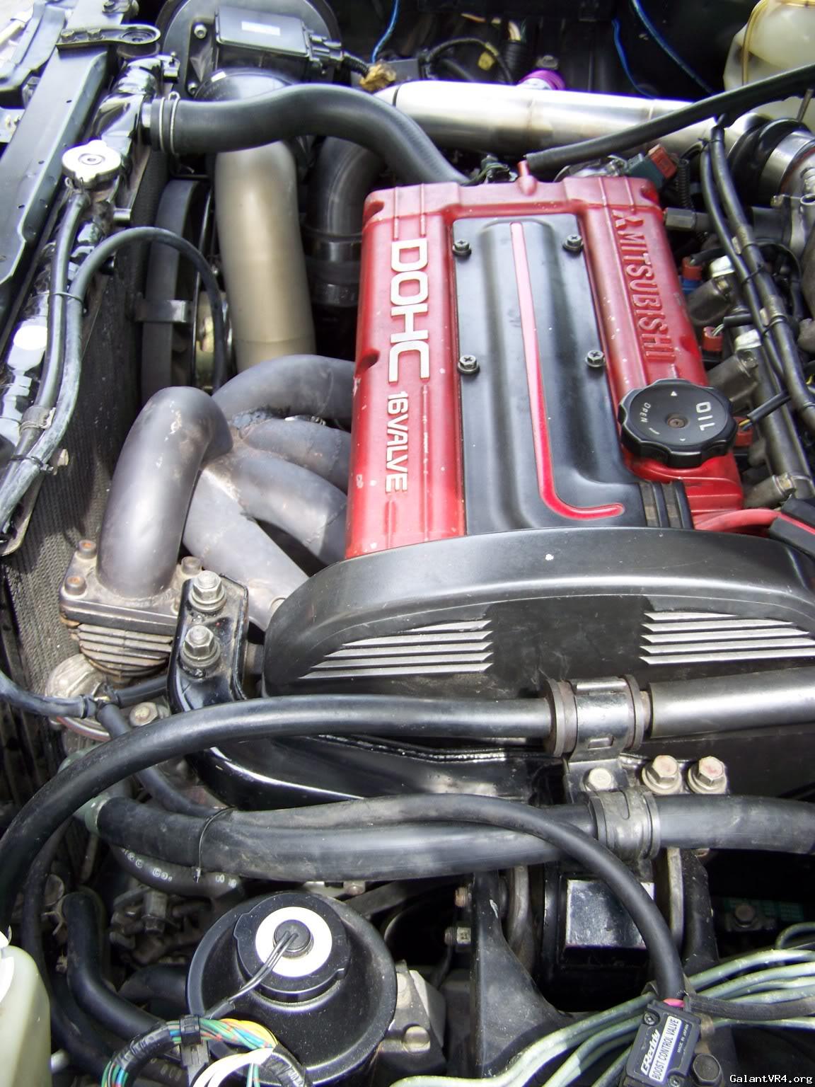

^^^^Here's a pic of my old set up with a oem style radiator.
The car was done this way by the PO. If I were to try and go back that route, I would have to buy a new manifold, modify my downpipe and o2 housing. I would most likely have to replace my wastegate with something smaller and route the dump where it would not hit anything. With all those things I would have to do...the civic radiator route was a cheaper alternative. With the cost of buying the radiator, cap, extra fan, snips and duct...I`m only in it for $100(-$80 for my old radiator).
I've been reading some threads of people doing some duct work and have had decent results. If it doesn't work, I still have the option of going with a smaller radiator or deleting the ac. I found a scirocco radiator for $90 shipped so that would be my next move if anything...
