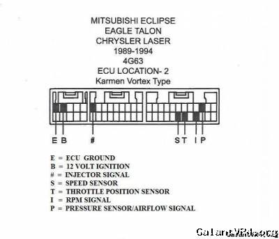

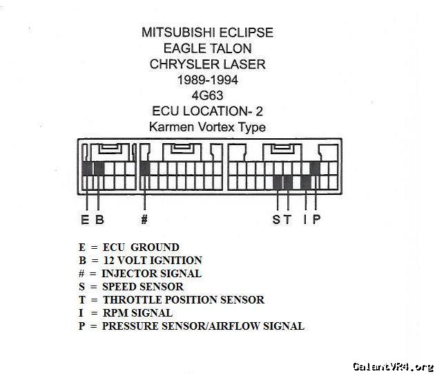

I used the following diagram for referencing the RPM signal when installing my HKS turbo timer and Greddy-e01 Profec. The "I" port on the harness side has worked for me on both occasions. I would "assume" this should work for you.
