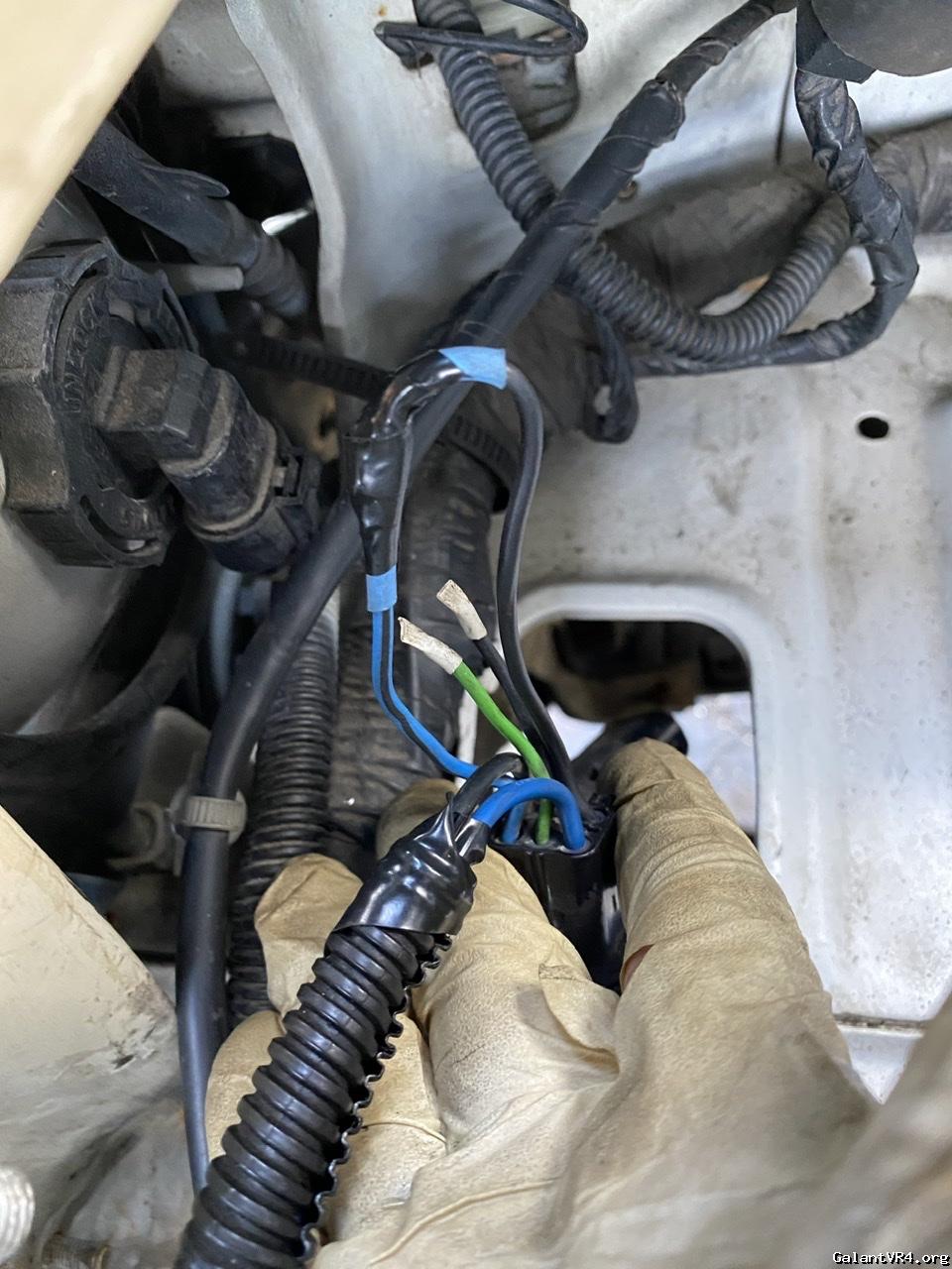

Ok, first of all I’m really bad at electrical stuff so what I did I tried to copy from a thread on here. Probably messed it up since my fan won’t turn on.
I recently bought a used aftermarket radiator and fan from someone who said that the fan works. After wiring it up I ran the vr4 and it would warm up to somewhere close to but not quite halfway on the temp gauge. The fan never turned on. Can you guys take a look at these pics and let me know what I did wrong? Any help would be appreciated. Thanks.

Any chance you could post a picture with both side of the connector visible so we can see all the wire colors. Trying to figure out how you wired it up.

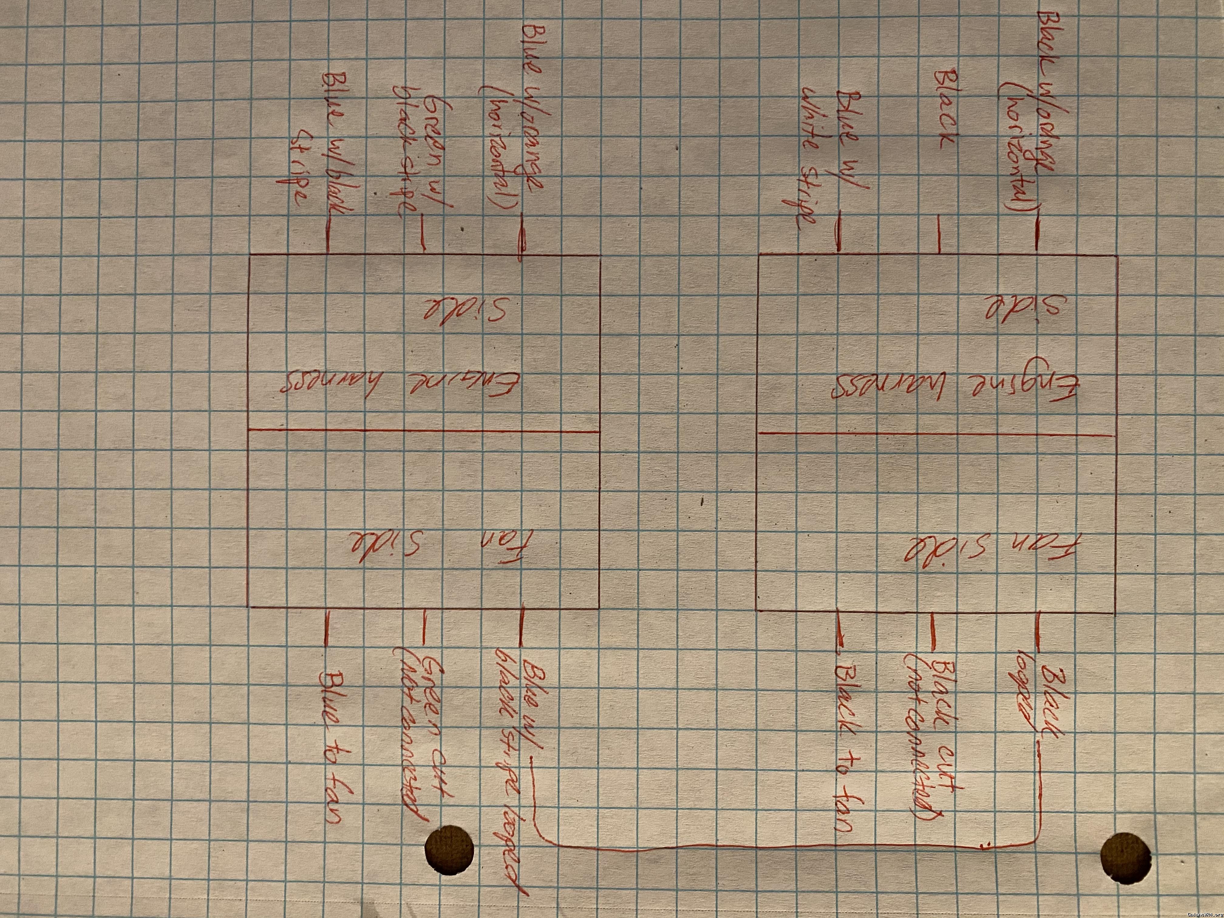

I tried taking some pics of the connections but they still ended up looking a bit confusing to people who would look at them so I ended up drawing it out. Hope this makes it clear.

Put the car in the on position, remove the plug connector at the bottom of the radiator, get a jumper wire, jump the two pins in the plug connector.
Did the fan turn on? If yes then that sensor is junk
If not then the fan is garbage and needs to be replaced or the wiring harness he made is sh*t and you need to build your own harness out of the OEM harness on the stock fan that you removed.

Quoting yonwd:
So after further examination, you see the black and green wires that are taped up..... Those are supposed to be attached to the sensor at the bottom of your rad to tell the fans when to turn on.
Homie build and sold a sh*t harness. At this point if I was you I would question where the fan was bought from. Unless it says spal or mishimoto very clear and visable I'd assume it's cheap eBay sh*t and won't flow enough air to keep temps in line on 90+ degree days.

the radiator is very similar to a afco one and it doesn't have any sensor bungs. that's why those wires are cut off...
it looks to be a cheap ebay fan. at this point it doesn't overheat when driven around and my other car needs attention right now so i'll have to put this on hold for a bit /ubbthreads/images/graemlins/frown.gif

well if those two wires arent connected to s switch sensor the fans wont turn on. you need to get a bung welded into the bottom of the rad that will except the oem fan switch and then wire it in. there is no other fix or option really.

There is an option if your radiator doesnt have a bung for a fan switch.
mishimoto water temp sensor
One other thing, my vr4 takes a solid 10 minutes to warm up before the fans will ever kick on. If possible I would see if you can purchase the stock fan wiring/harness from someone and wire it back like stock. That would be the best way to fix it. And get a SPAL fan.
I forgot to add that the radiatorfan switch is just a path to ground. So if you decide to use that mishimoto style inline switch option, that thing will need to be grounded with a wire.
