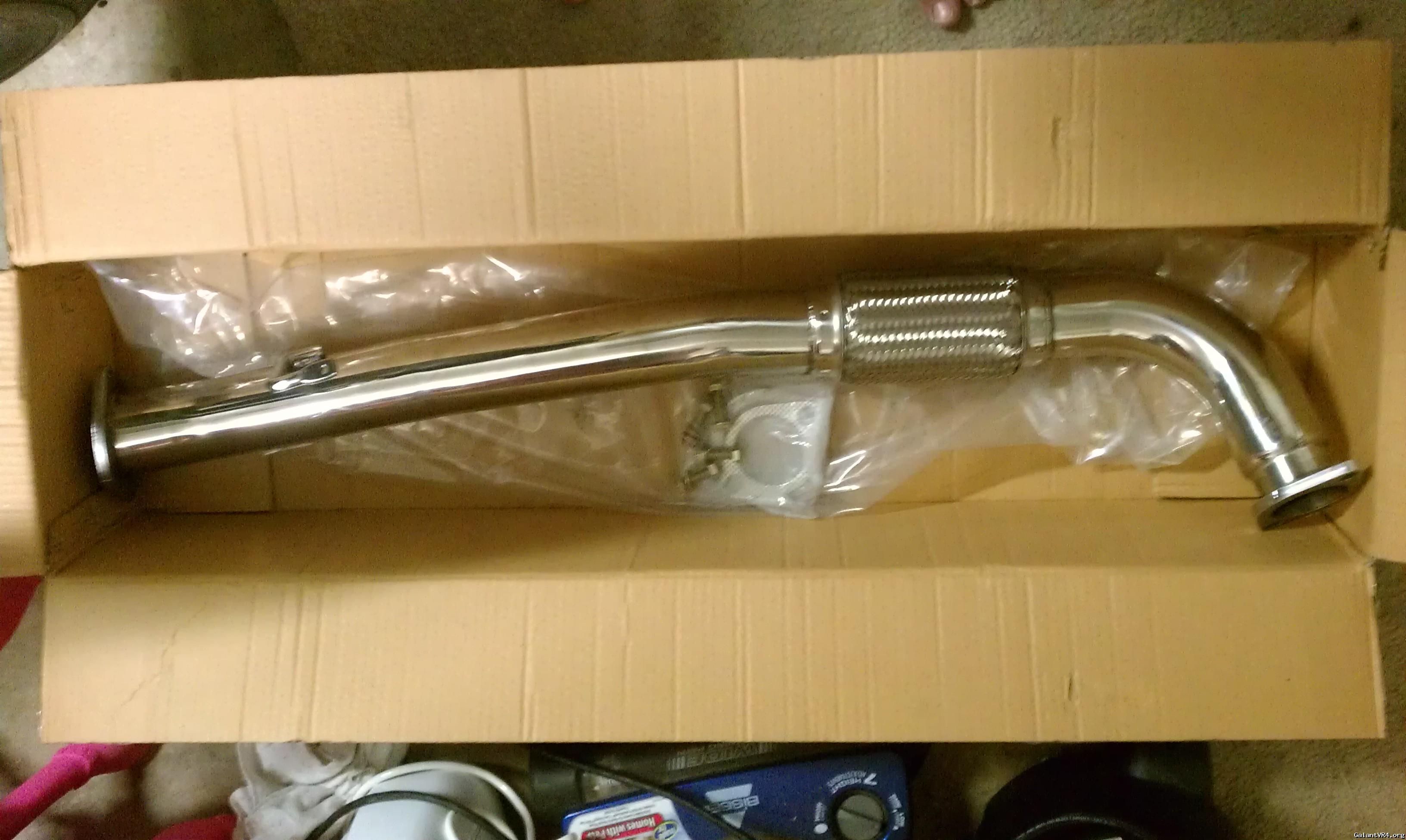

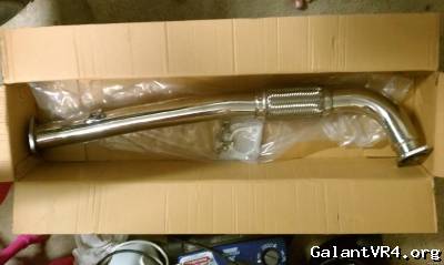

I received the EBAY downpipe yesterday. $69.95 shipped. Comes with gaskets and bolts. Everything looks good.
One thing I learned about Chinese tig welding when I worked at the shop was they generally do not penetrate all the way through. This holds true for this piece. The shop across the street from my old shop made exhaust manifolds for Nascar. When they welded, they would fill the inside of the tube with gas while they welded the outside to make sure the weld went all the way through.
Anyways, for $69.95 shipped with hardware and gaskets I'm happy. I don't know if it fits yet. I'll keep you updated.
