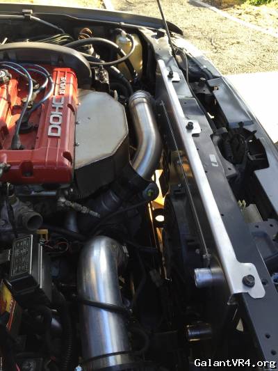

Pics of it all mounted up before.

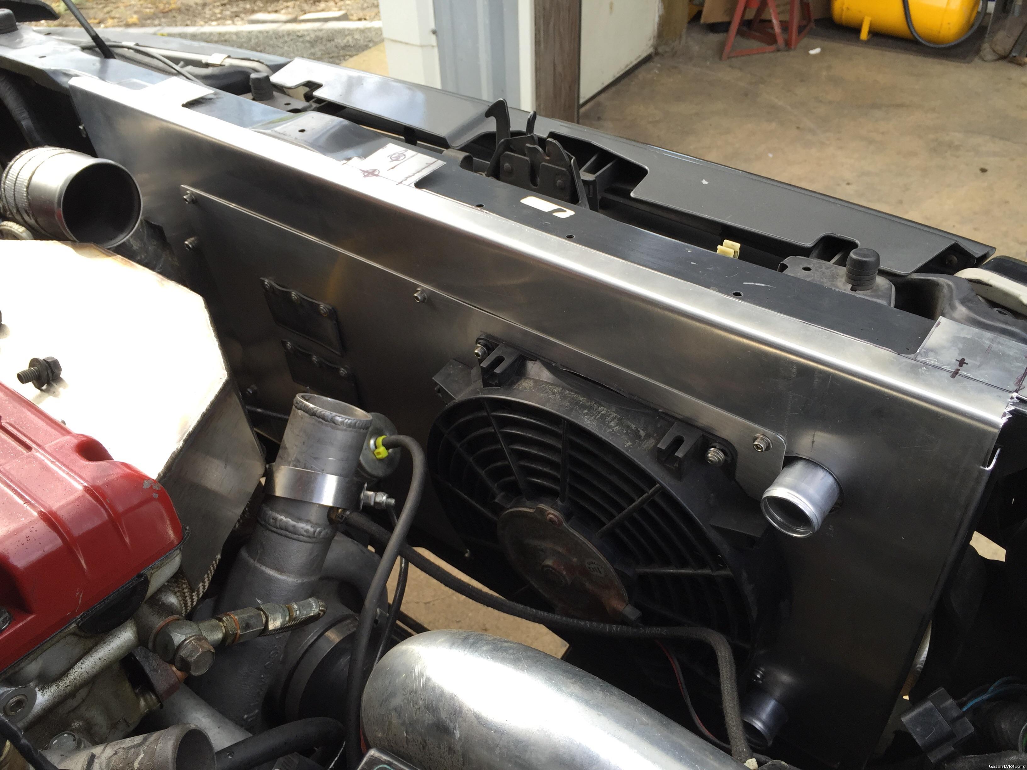

Yes, you (EH aka. Evan) did an awesome job. I'll start a new thread for that work. I'd also point out that Evan also
- Welded my IC piping
- Built a little custom heat shield since neither of us were happen with how the piping looked with the heat tape (which you can see in his last photo and a bit in this one as well)
