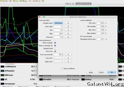

On my setup (ECMLink w/ MTXL), I'm using a LinearWideBand configuration. I did this because the value I was seeing on the gauge (correct) was about 0.5:1 lower than the value I was seeing in the link software. A minor adjustment to the minimum voltage value brought the DAC output inline with the gauge output.

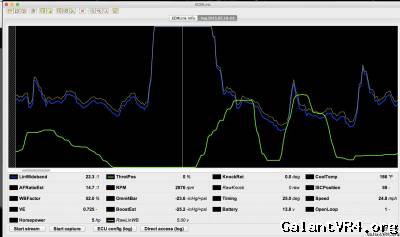

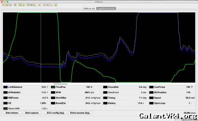

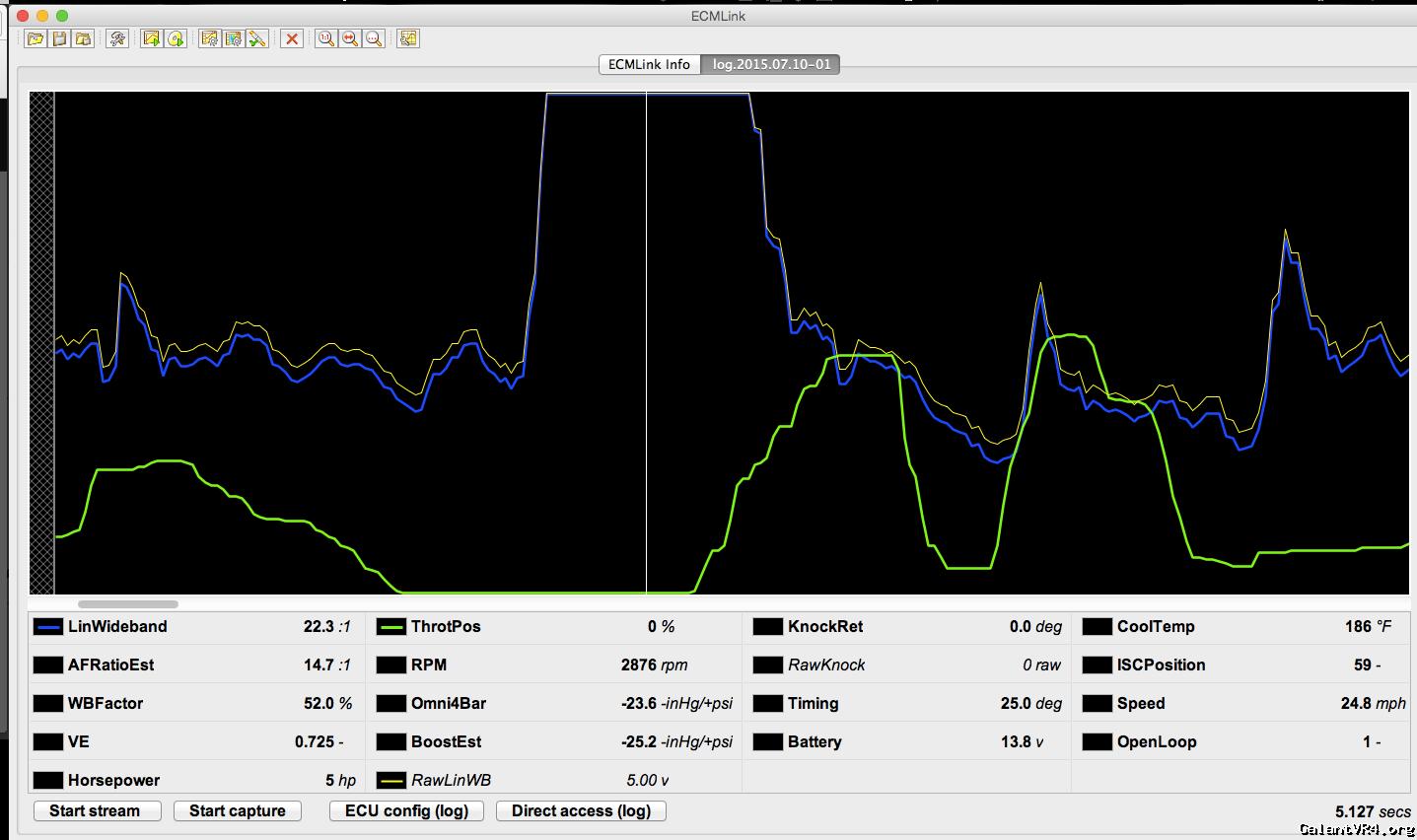

Here you can see what the raw voltage and AFR looks like at WOT...

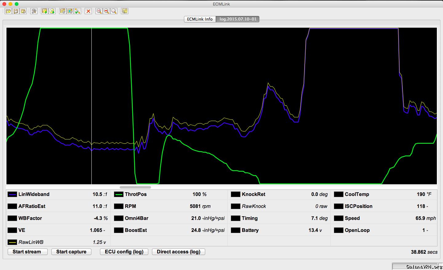

...and at full vac with my foot off the gas
The point is that your voltage should never be configured over 5v. 4.99v is fine, and if you see drift between your gauge and your computer, adjusting the minimum and/or maximum values is how you can get things synced up.
