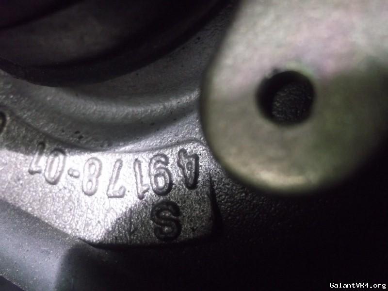

hi guys ive my gvr4 for about 9 months only been drivable 3, but i just did the timing belt and got it running running again, but i noticed it had pretty much no power over 4000 and putted but i hear the boost swoosh,no boost gauge tho but after all the bars are lit on dash it keeps getting louder. so i found out that i have the evo 3 big 16 i forgot the numbers but it had 47 between the numbers that stick out. ohter mods are bc cams stage 1 im told, 2 1/2 to 3 inch turbo back. my queston is i just bought evo 560 injectors and a walbro 255 with re wire kit and will adding those with out some fuel controll like apexi s-afc make it more driveable in the mid range and stop what i think is fuel cut or pulling timing? maybe one or the other untill i get the s-afc??? thanks for all help.

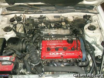

Also, it might help if you send us a pic of your engine compartment. Also, what kind of boost control is your turbo hooked up to?

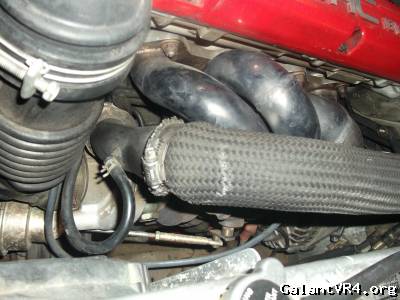

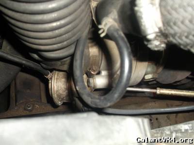

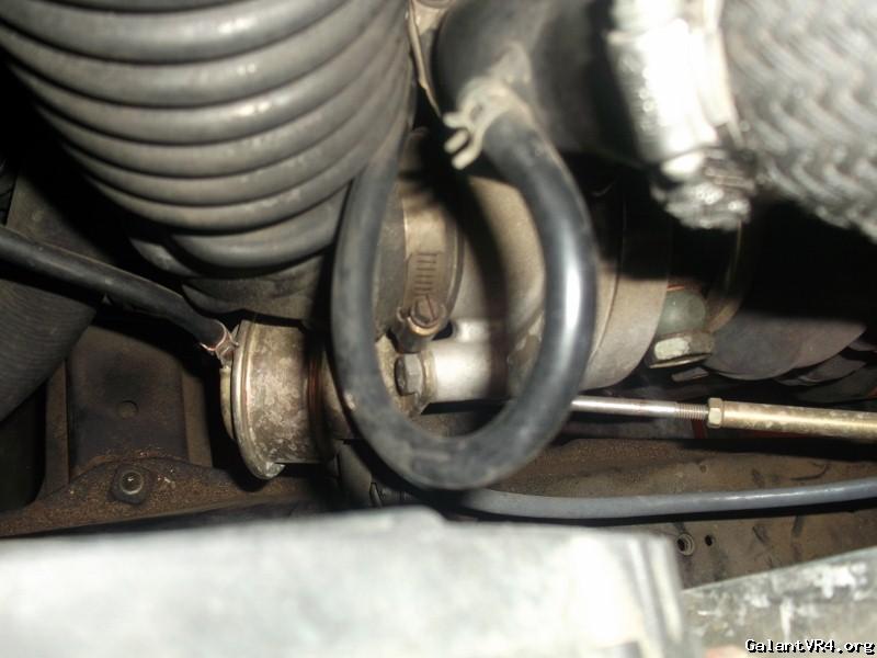

just added a boost gauge teed in right out the fitting in compressor outlet. what i know is it has stock ecm, stock maf, stock blue top injectors and pump but not sure about pump, stage 1 bc cams, 2 1/2 turbo back with 3in cat, and 16g. the boost hits 7psi @ 3500-4000rpm then loud putt-put-put (almost like launch control) no power right when i hear loud spool, shift up boost gauge jumps to 10-11psi. going to pressure leak the intake side 2morrow.
i tapped into this hose for boost gauge\/

Tap into the vacuum line at the fuel pressure regulator. It's much closer than routing it around the engine.
Get a boost leak test done. A bit early for cam upgrades.
