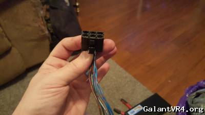

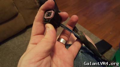

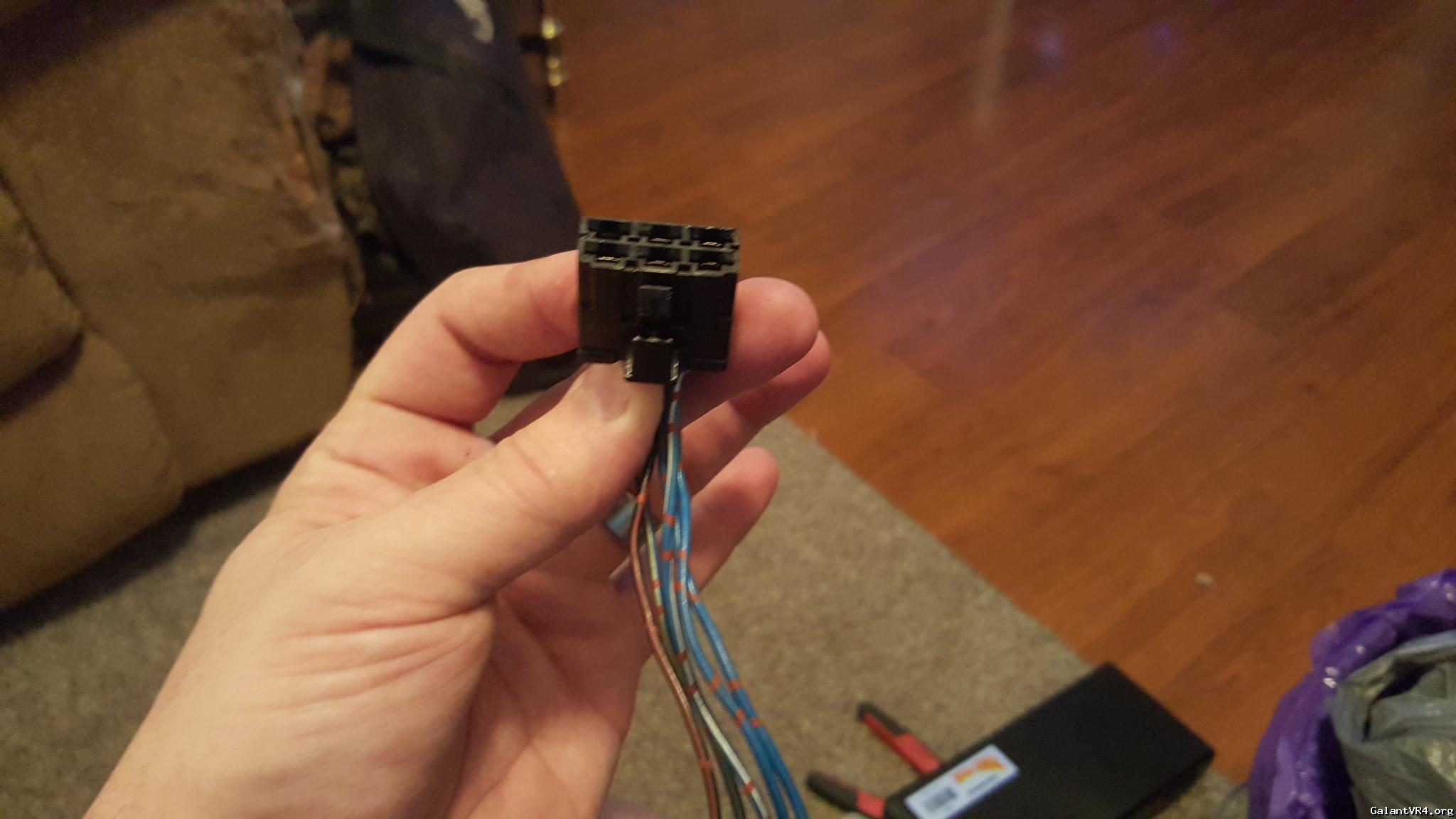

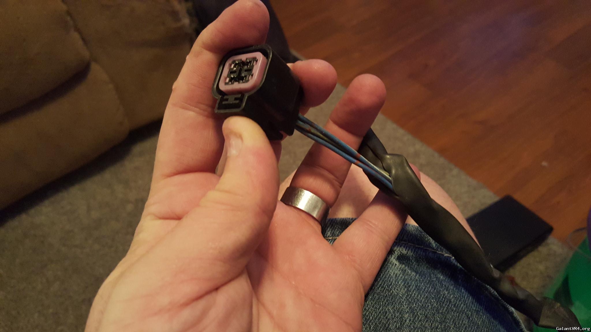

Are these the two plugs from the ECU harness that I can remove if I will NOT be running AC, ABS and Cruise? These were not connected to anything when the harness we installed. I know there is more on the other harness in the engine bay, but concerned with these two currently.

Yes, that is correct. You can remove both plugs. Both will run to above and behind the glove box and connect two large white connectors that in turn connect to the steering column switch.

I traced them to those plugs, just wasnt sure. That is great! I will trace them back and remove the wires up to the plugs.
