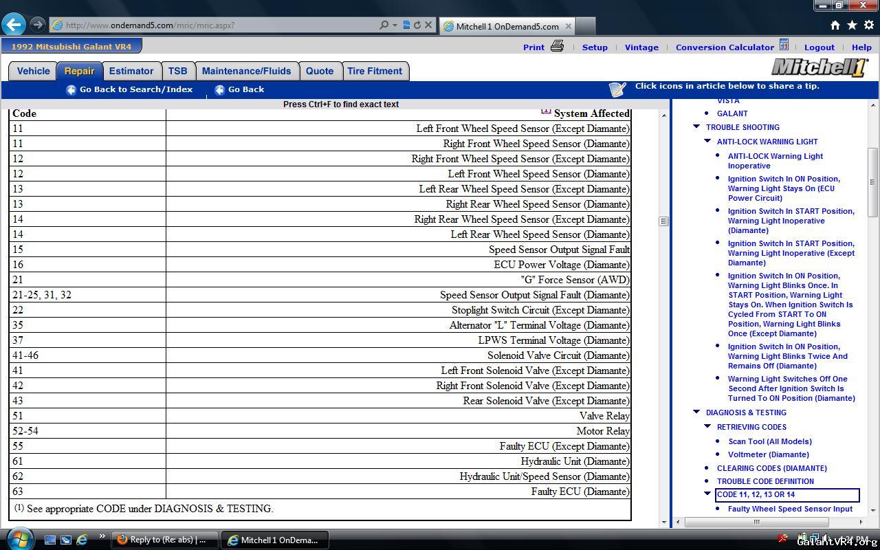

Be sure to check all fuses.
On US models, I believe pin 4 and 12 need to be connected to your volt meter. Pin 4 is the ABS terminals and 12 is the ground.
Then, use this chart.
