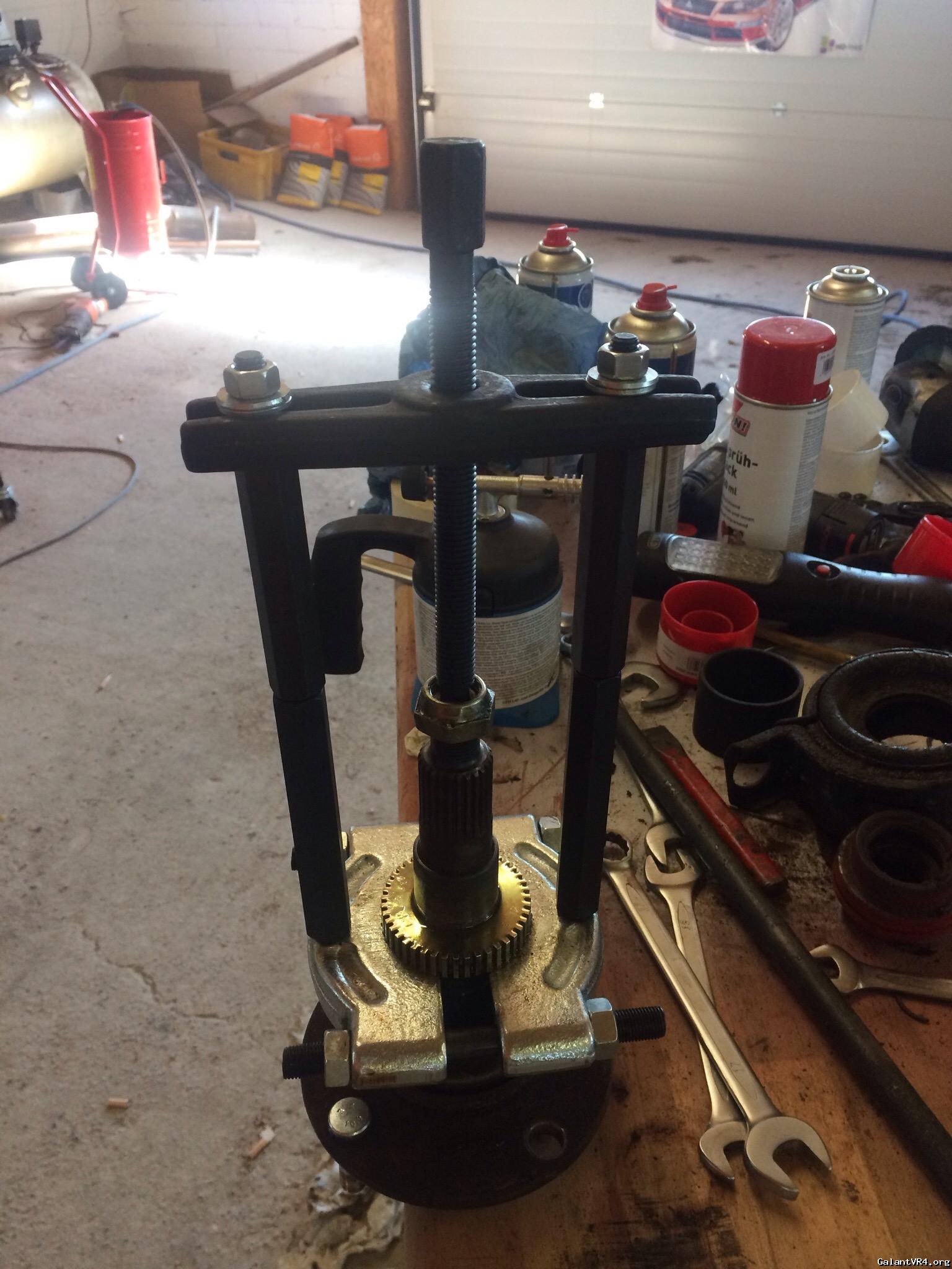

My outer wheel bearings are crap - bought all the stuff to overhaul the rear driveshaft and have to face a new problem...
The brass ABS rotor is stucked at the shaft, it doesn't move anyway.
Can't use my hydraulic press because the wheel hub is too big....
Any suggestions?

Maybe saw a slit in each side and smack it good assuming you'd like to get rid of the ABS. For me, I just took the spindles to a shop and they put the new bearing and seal on. Sorry I don't have more for you this time. Maybe an impact could give the extra jolt it needs

@Nebraska: deleting the ABS is not an option. To keep it strrelwgal, the ABS must be functional. I would kill the gear if a new was available - but these are discontinued...
3,473
Clamp the ABS ring in a soft jaw vise and smack the back side of the hub face with a hammer. It should pop off fairly easily.
3,473
And if you f*** up the ABS ring trying to remove it, I may have one laying around you can have.

Update:
After heating it with an electric heatgun, the puller at its maximum, at medium temperature for half an hour it suddenly decided to move with a big bang...
Thx to all for your advices!
