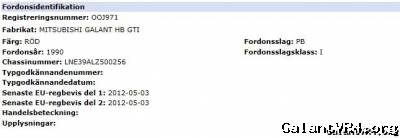

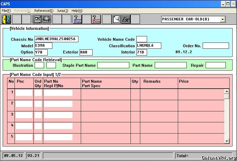

what year is your car Egon, i''ll scan and post later for you. could you pop up a pic of the abs computer? its an EDM model isn't it. could you let me know the model code? will end in L6.
The abs light and the panel in the wheel well tell the car had abs. and yes if fitted in europe it must work at inspection. They have databases that define the must haves.

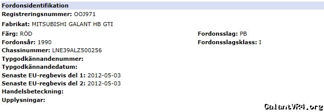

Ill look for stuff when I get home, but here is a pic of the Swedish registration info.

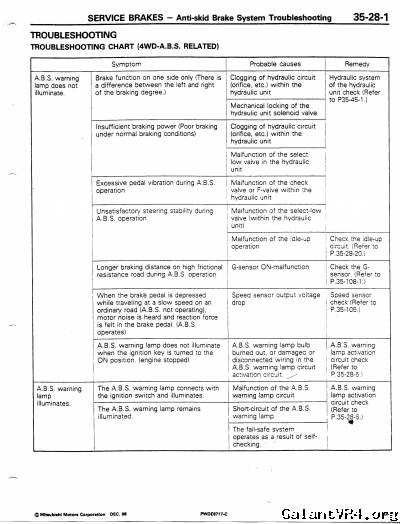

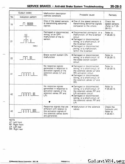

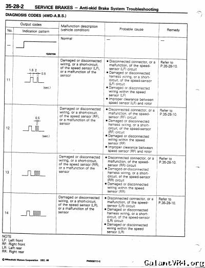

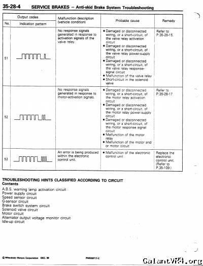

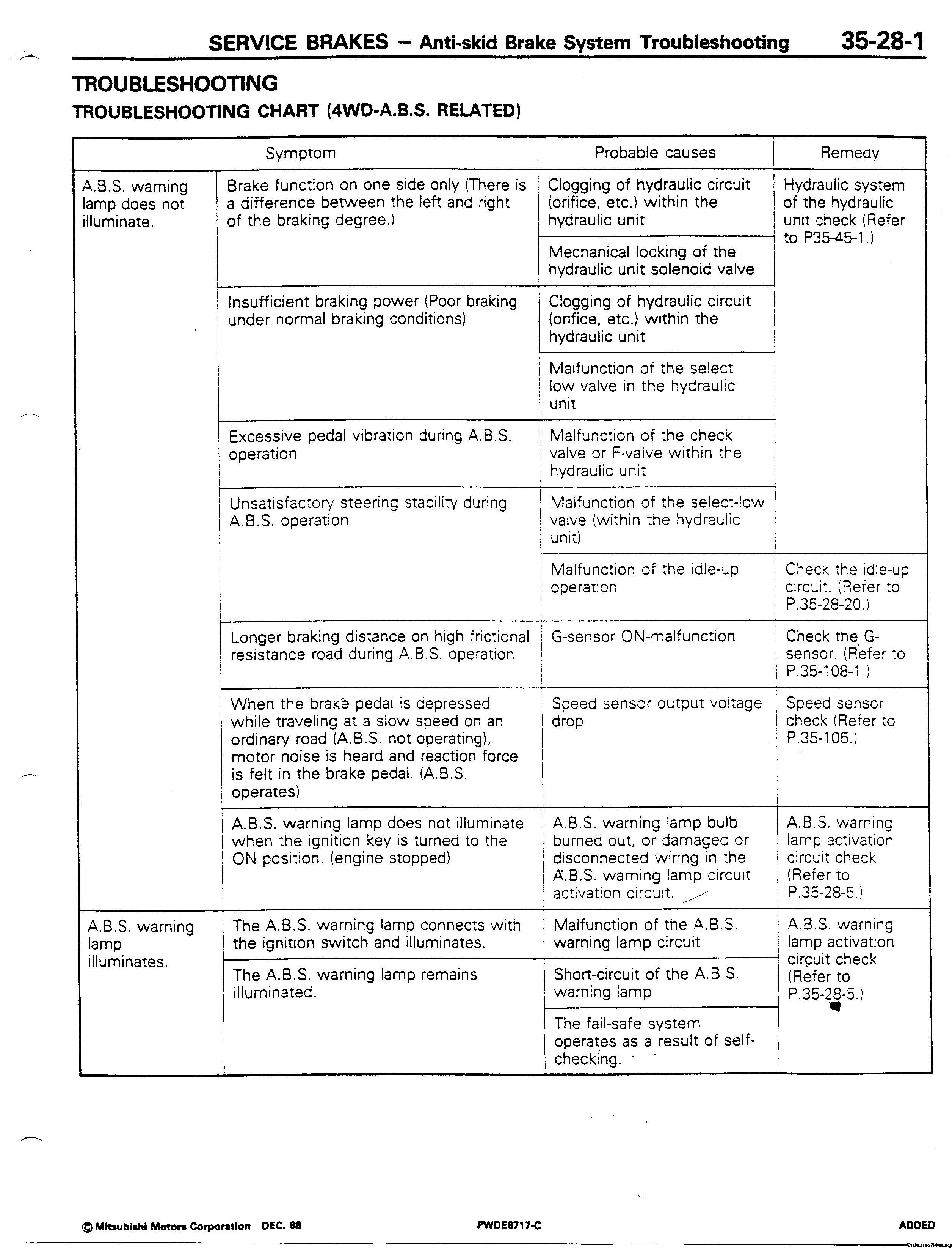

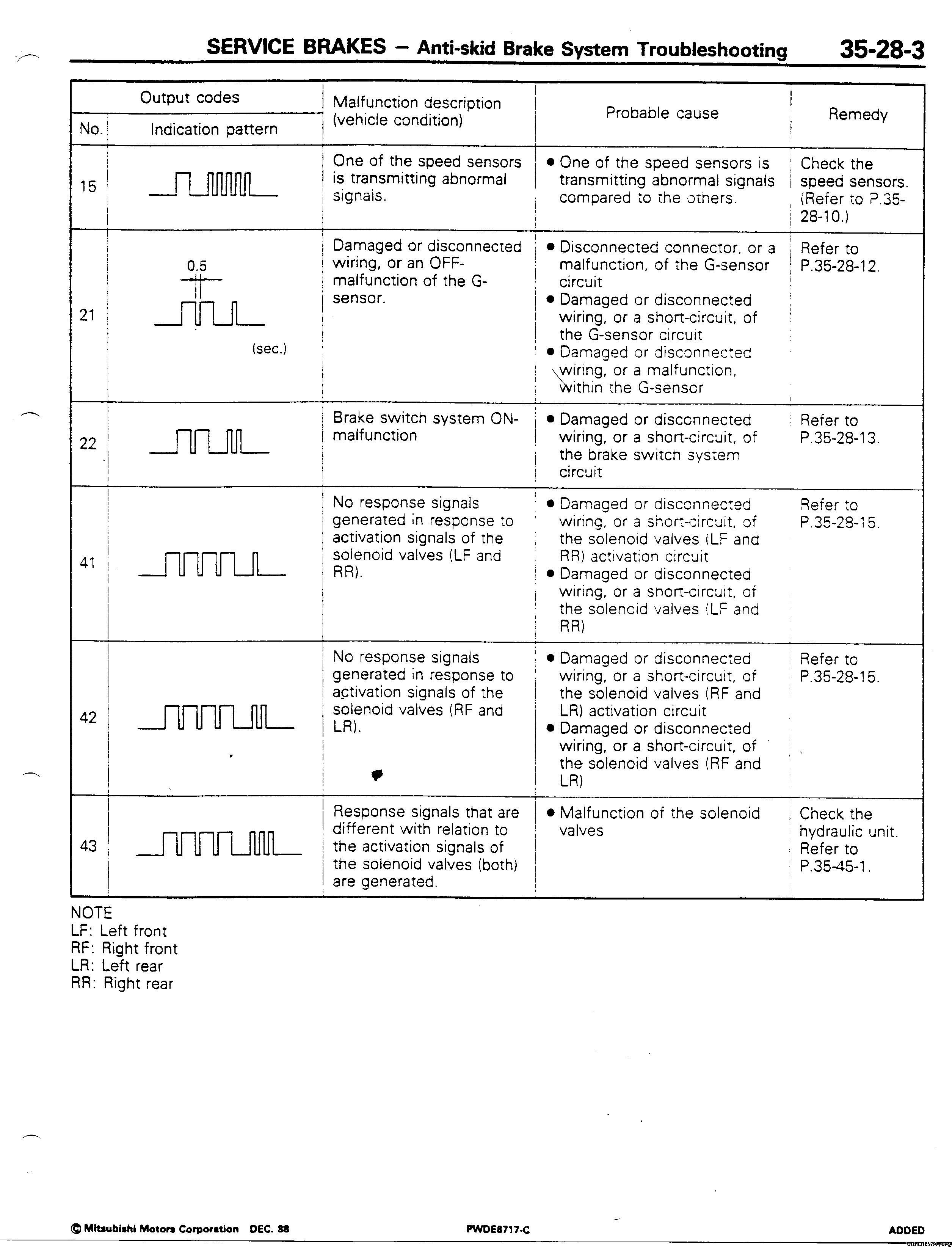

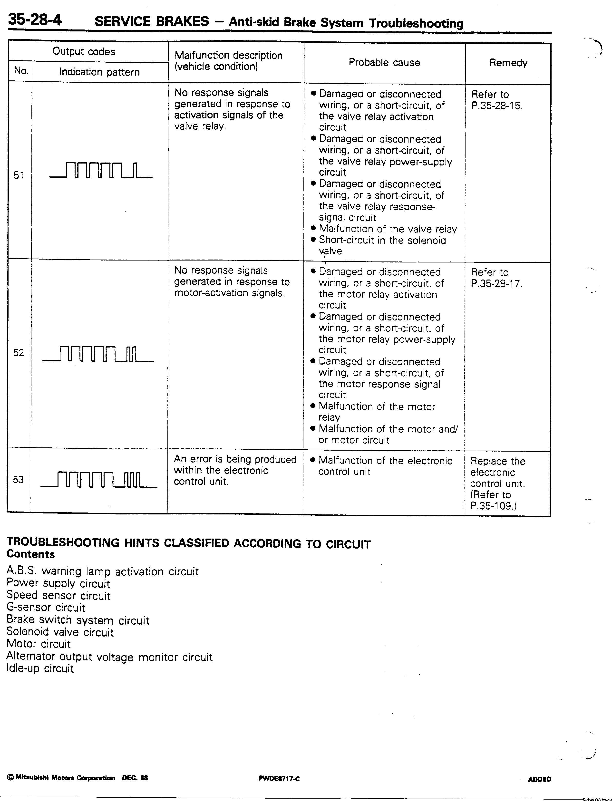

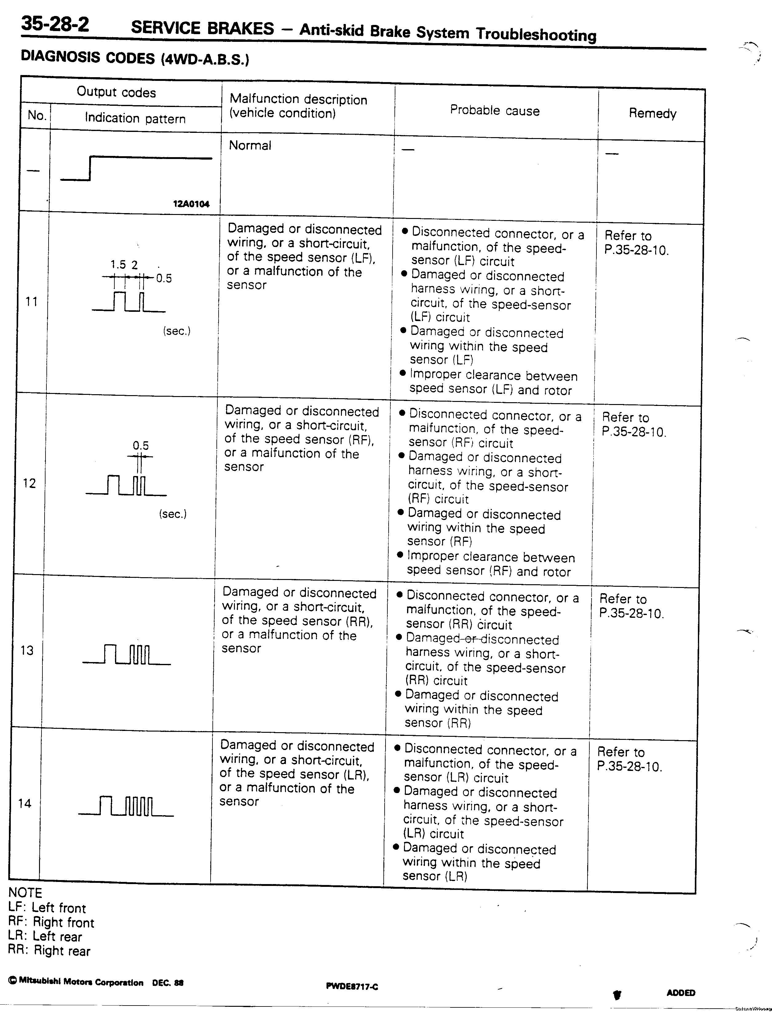

I'd be inclined to agree with the wheel sensors. Hook up a little 12v bulb and use that on the diag port. You'll be able to get the code easily. If you use a meter it might dwell and you'll get confused.
Anyhoo... Your car is a late '89:
Took the pic from caps as it gives a nice crisp build date.
Here is the trouble shooting guide from the Service manual specific to pre '91 4WD cars. I've pulled the rest so I can drop it on the autofeed scanner tomrrow lunchtime /ubbthreads/images/graemlins/wink.gif. Let us know how you get on pulling the codes again!
Hope this helps!
