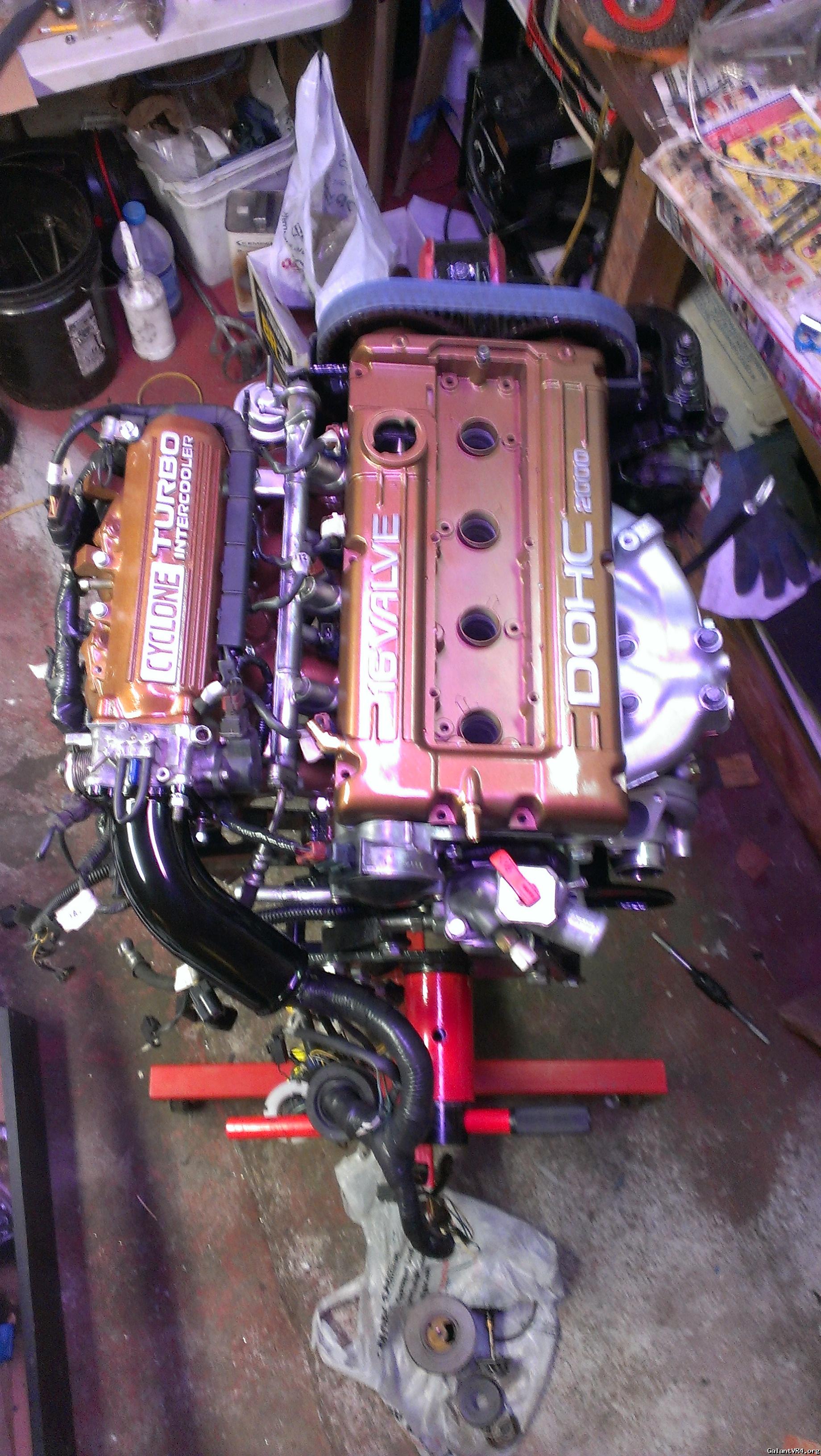

New crank had no woodrif key, or fly wheel pin.
Aluminum fly wheel is bigger than stock. So the new fly wheel bolts I ordered are all to short. I had the auto plate but need starion flywheel bolts.
6-Bolt A/T Plate - (MD952138)
Starion 12x26 flywheel to crank bolts - (MD008839)
My southbend clutch didn't come with a alignment tool or a tob. So I have to order those too. (Edit: tob and alignment tool were included)
Almost done though

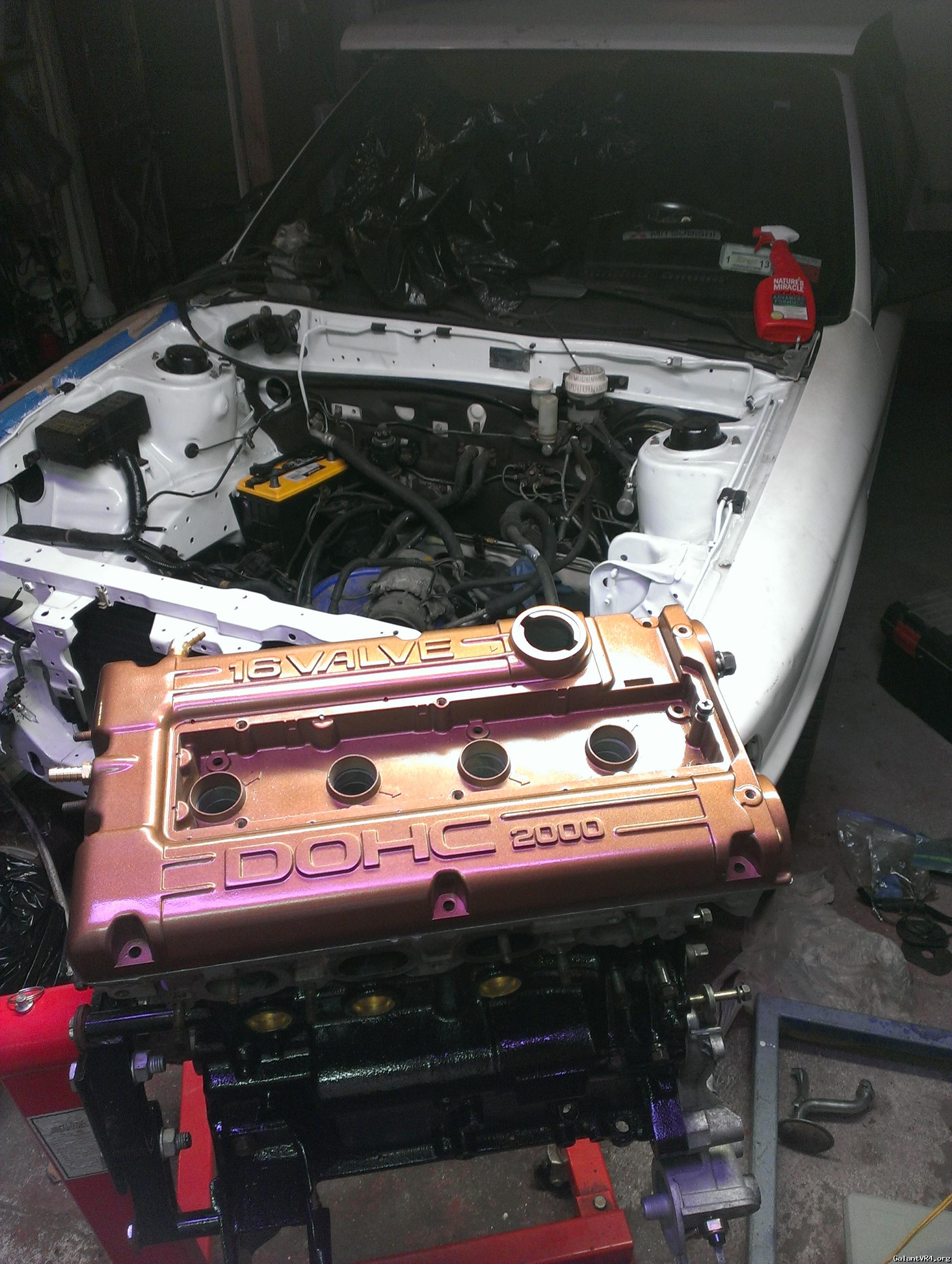

last time i saw that thing we were bolting the head on, ill try and make it next weekend. hopefully the parts you need are in. cant wait to hear it start.
