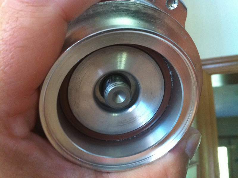

So I swap the bov onto the talon and make passes a few weeks ago, and while swapping it back onto the GVR4, I notice it's making a clicking sound. flip it over:
WTF: the nut is gone and the main plunger/disk is not connected to the shaft!!!!!

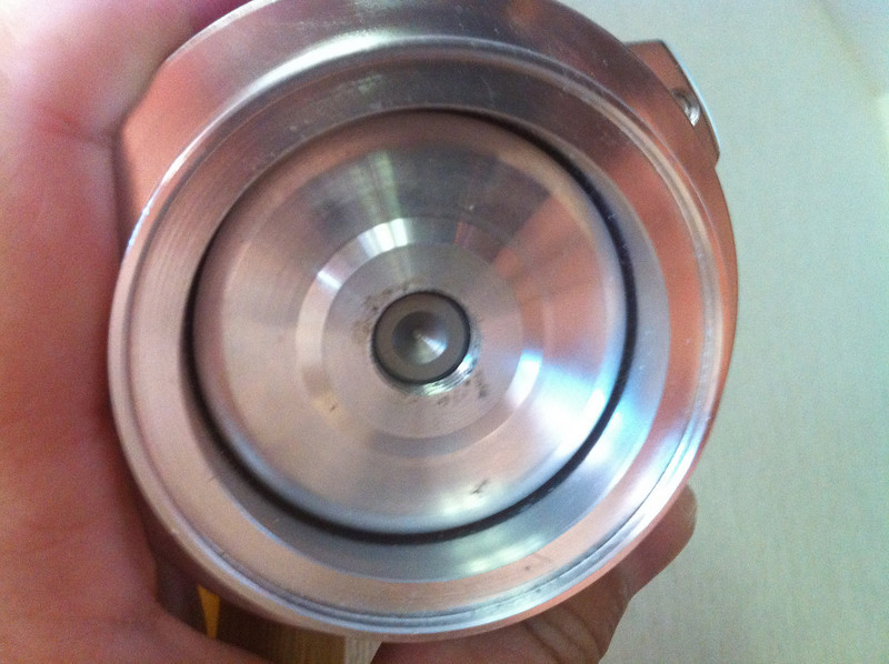

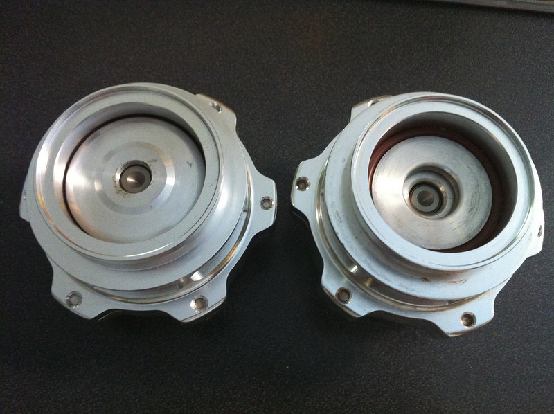

So I buy another of the same knockoff tial while on vacation, thus I don't have to swap them from car to car. Figured I'd go find a matching nut to the new one in order to repair the old one (with red loctite). The new one does not have a nut on bottom...the shaft is threaded right into the disk. It's in an XSpower branded box BTW. Here's the new/old bov side to side:
Closeup of new one:
Closeup of new one:
