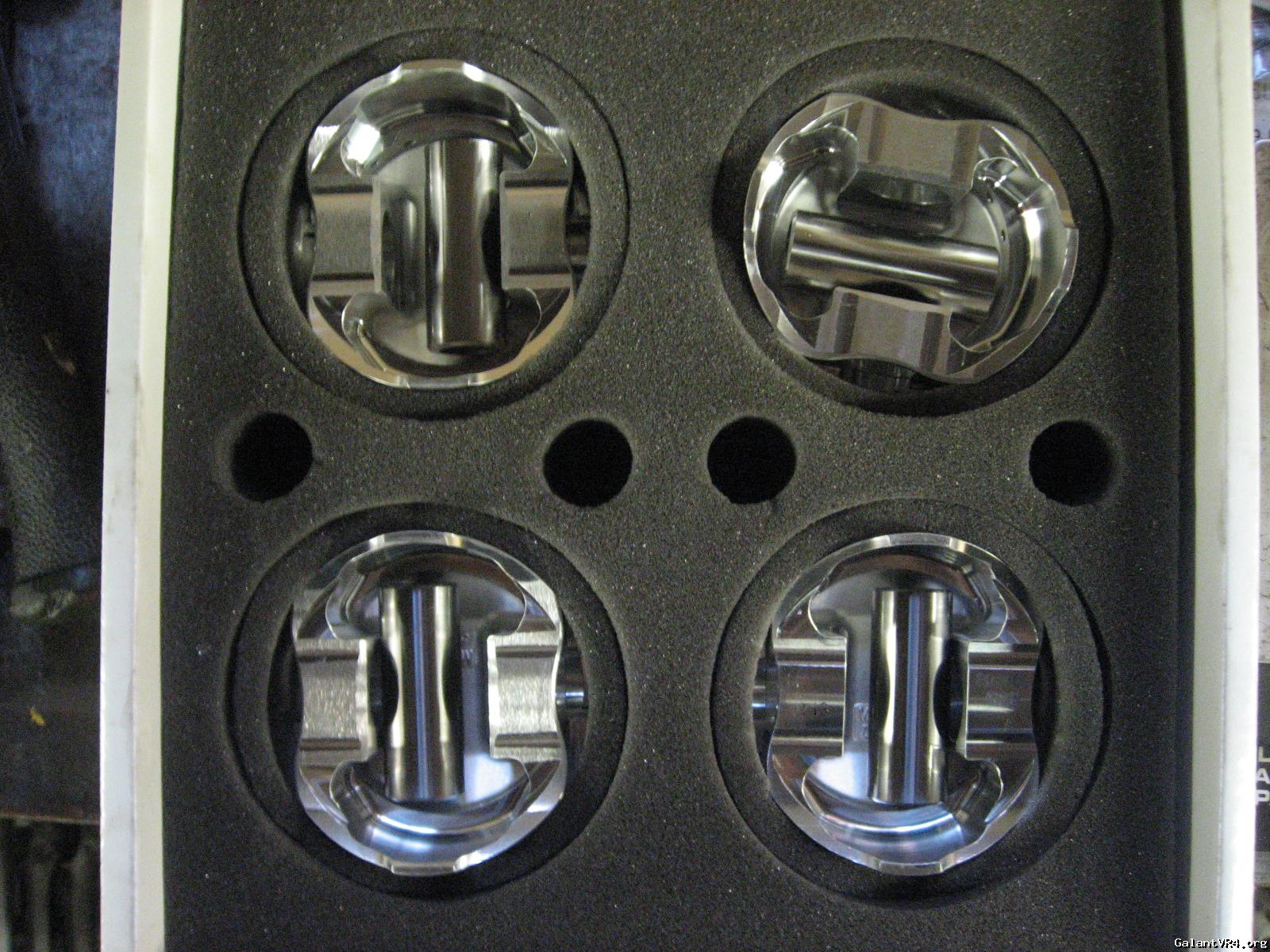

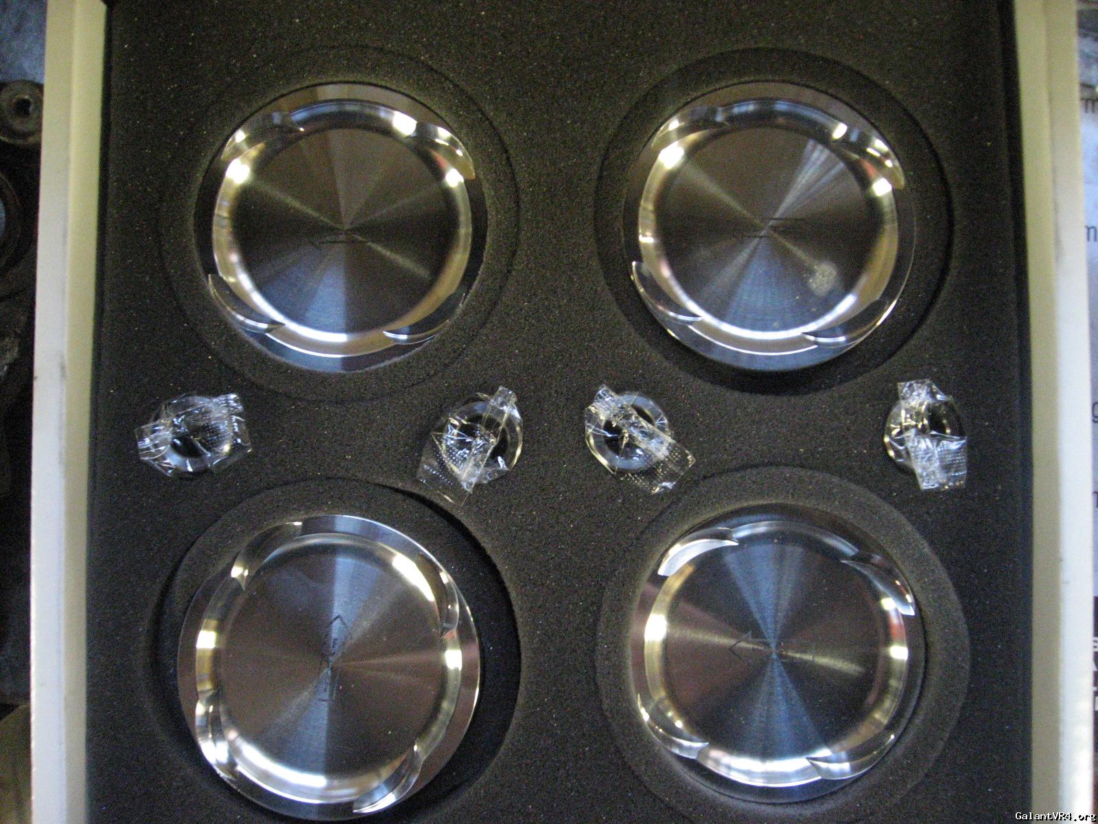

I had a customer drop off a set for a build. Manley always seems to have a pretty piece in the box.
[/url

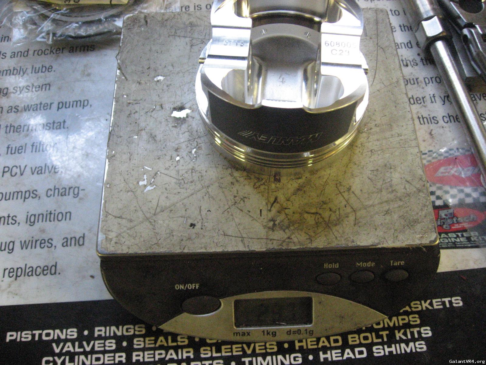

The box claims that that the pistons weigh in at 296-297g
[url=https://www.galantvr4.org/img.php?id=150865 t=_blank]

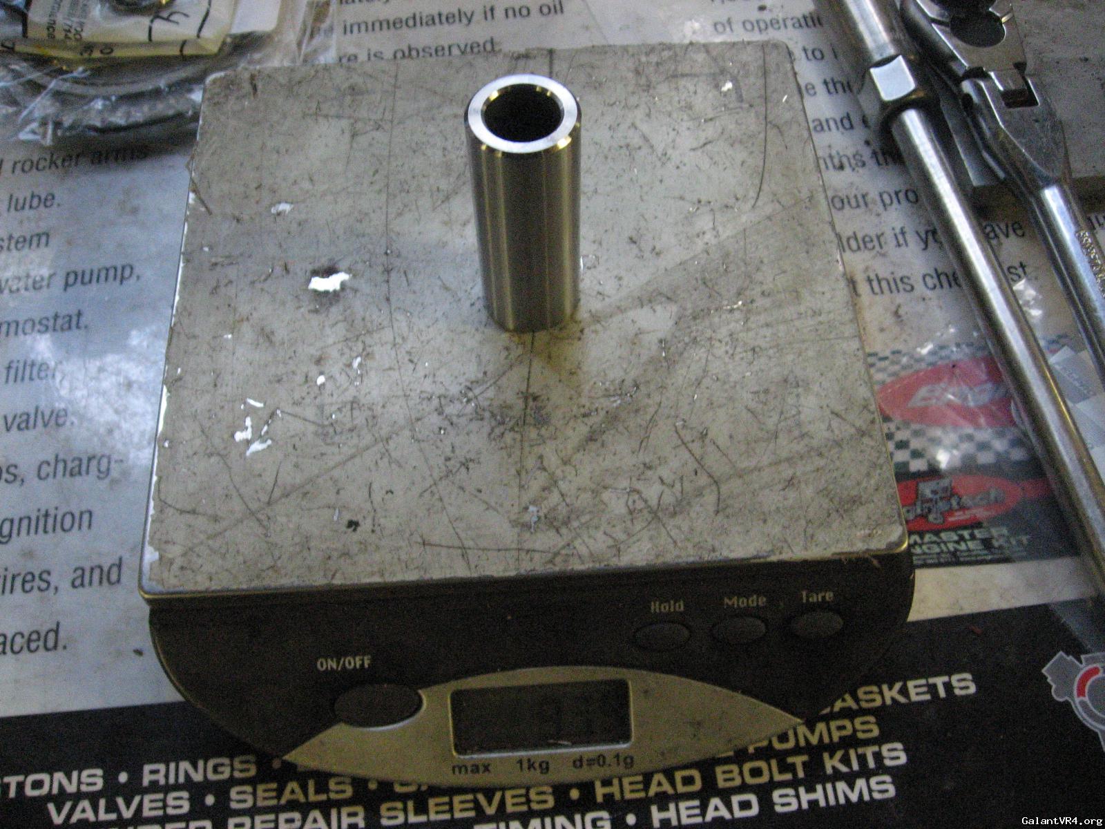

Out of the box they were appox. a gram heavy 297-298g .8g to be exact
The wrist pins were close .2g from high to low
Now placing the wrist pins in the piston, I was able to get .7g from high to low.
Not much needed for balancing on this set.

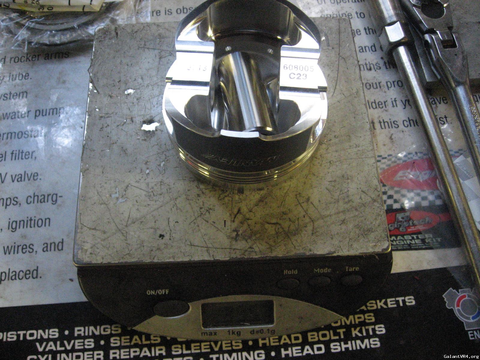

The light piston and wrist pin weighed in at 395.1g
Some slight polishing brought all 4 pistons to 395.1g
The piston diameter was close too I found a mere .0002 variance.
