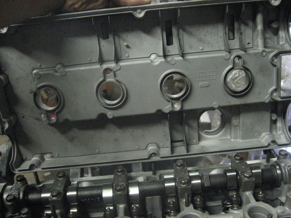

Now with the 4g63 there are 3 oil returns that drain oil from the head back into the block to the oil pan. One on either end of the head on the intake side, and one in the center of the exhaust side of the head.
Yes air pressure will be vented through these oil returns, the drawback is as air flows up, it will catch oil returning to the pan and catch an amount of it keeping it air born carrying it to the valve cover baffles. This is unwanted oil loss.
Notice the 4 baffle vents that allow the air into the valve cover to be vented outside the engine.

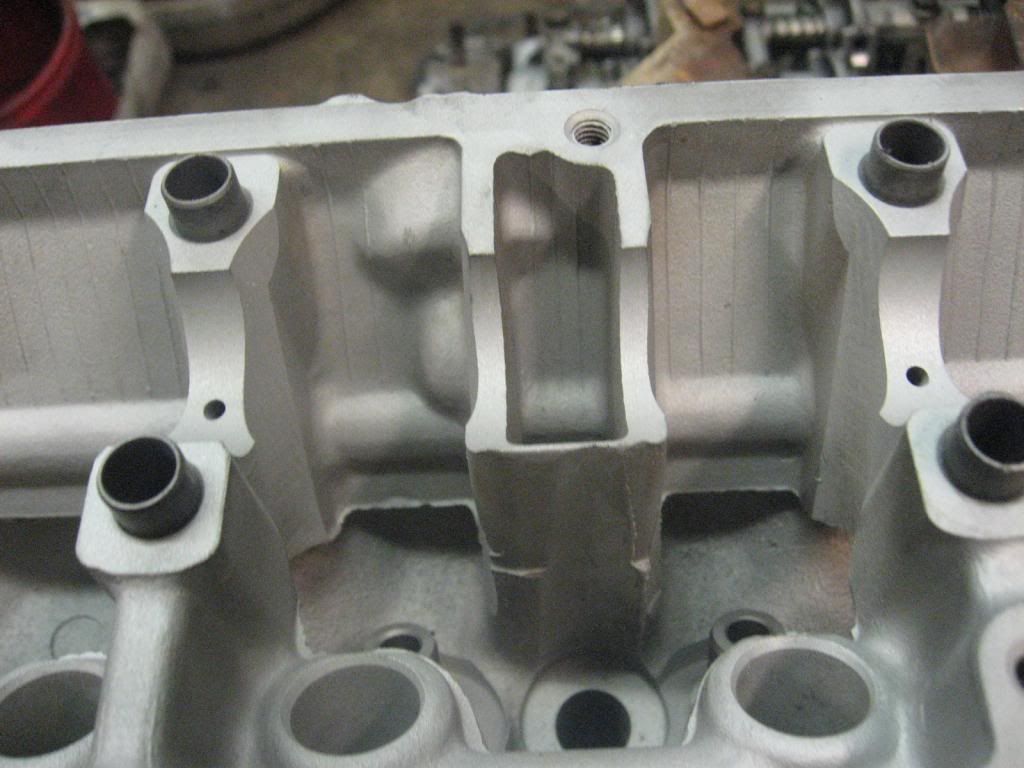

Now if you look at the center of the intake side of the head, there is a vent tower.
Oil is not supposed to flow down this port, but direct crank pressure from the block through the head and direct it towards the valve cover.

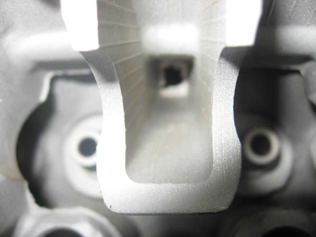

The underside of the vent tower

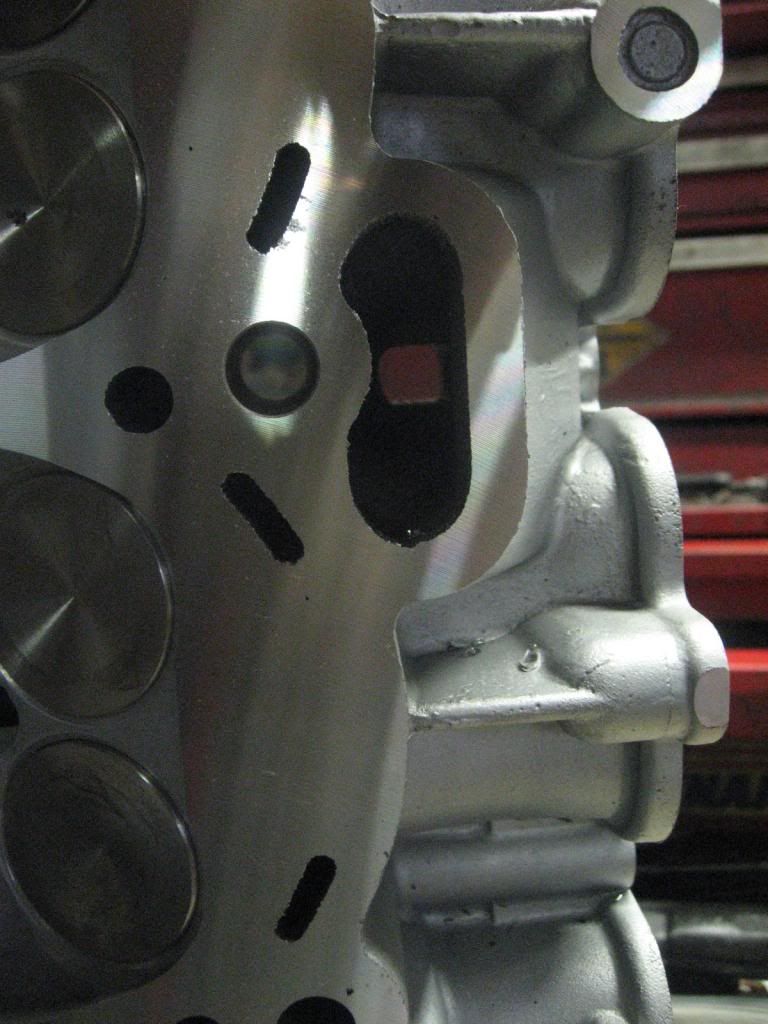

The head vent tower lines up with the dual round passages on the block.

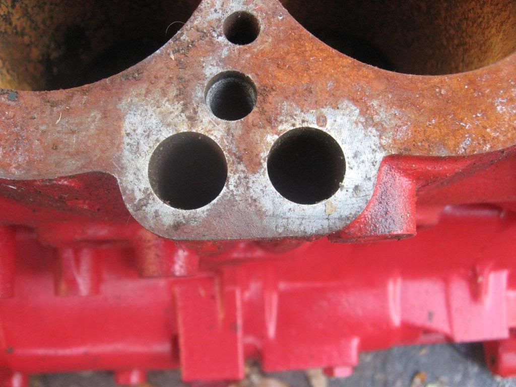

You can see this vent passage cast into the intake side of the block.

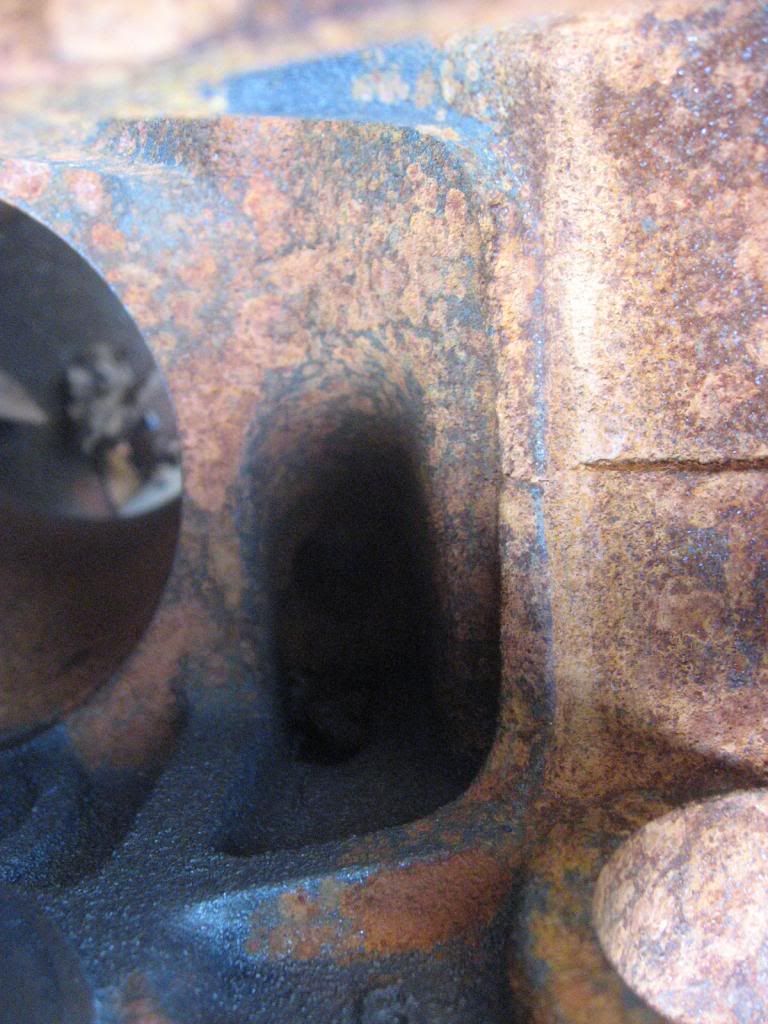

Now in the crank case, this is the start of the vent.

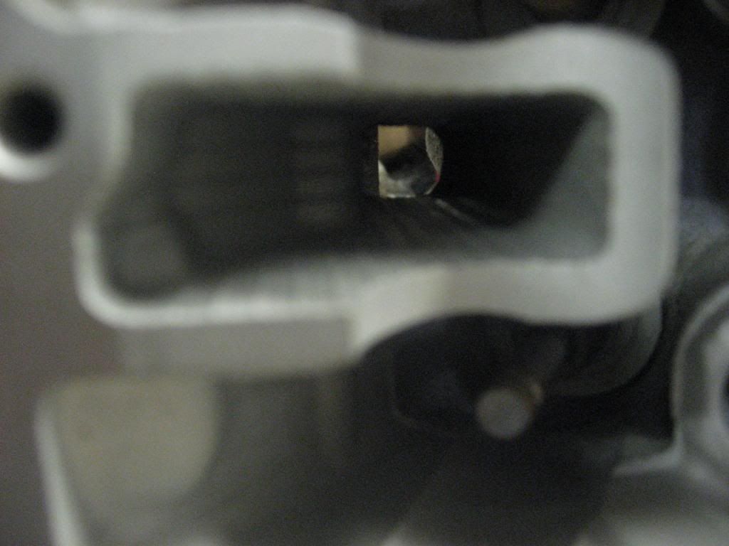

Now from what I have seen, the main restriction of this system is in the head, just from casting the head, there is flashing in the vent tower.
When the head is off the engine, the flashing needs to be removed so the crank case can vent as it should.
