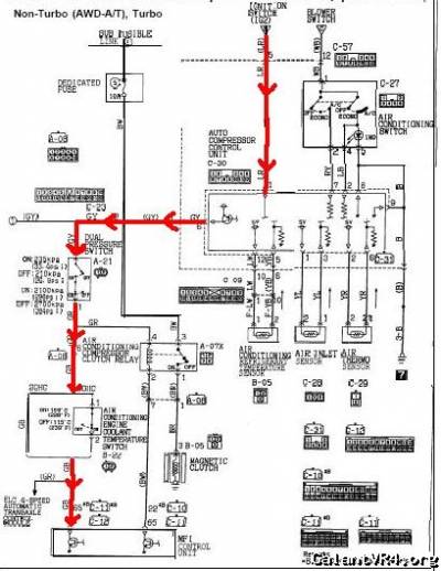

Alright, after spending some time and actually looking it over, using this:
The GR wire from dual pressure switch to a/c engine temp sensor doesn't have continuity which seems to be the issue. dual pressure switch has voltage in and out..
So the question is, does anyone know where that wire runs on the car? From the dual pressure switch to the a/c temp switch on the tstat housing

Do you have a better/bigger picture of the above image? Where is the Dual Pressure switch actually located?

That pic was linked in some other a/c thread on this site. just save as and zoom in.
Dual pressure switch is under the stock coolant overflow reservoir. 2 wire plug, green/red and green/yellow wires going to it. That gets power from the A/C button, and runs to the 2 wire sensor on the thermostat housing, then goes to the ecu it looks like. somewhere between those 2 i'm losing connection

If you paperclip the require connection at the inbound and outbound connections for the dual pressure switch, you can control the relay for the compressor clutch and confirm the control wiring, and clutch function with this manual test.
Be sure to remove the connector and only use the required pins. File down the ends of the paperclip so as to not enlarge or over stress the pin contacts in the connector you are working with. The paperclip has to mimic the exact thickness of the pins in the switch assembly.
This will either confirm the switch being bad (out of calibration/dead) or switch being good and system pressures actually being out of spec.
Also, the AC engine coolant switch is inline and a second fail safe shutoff device to maintain engine operation but defeat AC if things get too hot. Confirm this switch is good also, or even hooked up for that matter. Maybe something got bumped.

I guess I should update with what the fix was. The green/red wire I spoke of before has a splice near the fusebox inside the wire loom that runs parallel to the firewall. One of the wires was at the splice was barely making connection. Fixed that, and a/c works as it should. Must of been a coincidental issue while doing the head swap.
