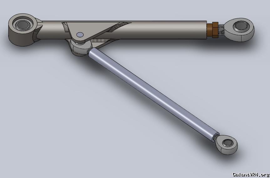

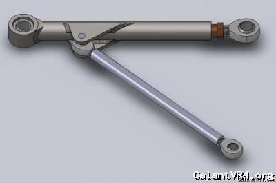

I know most people looking for extra camber are using whiteline camber bushings at the rear of their stock control arms however it only offers a max of +-1°

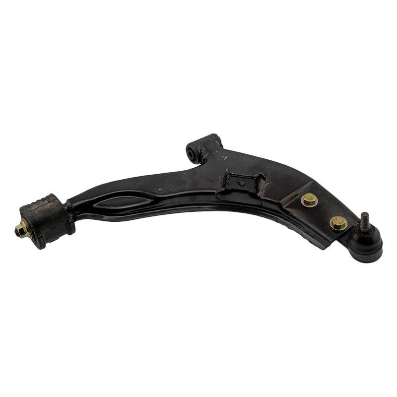

I came across this swap in the CSM community and thought it could solve a problem for us. I havenot found the exact dimensions of the arm so that needs to be explored further, however I found the way the ball joint attaches to it intriguing. By adding a another hole or slotting one of the existing holes holding the ball joint on to the arm adjustable caster can be realized.

Also it wouldn't be too hard to modify the Galant control arm to accept the Elantra ball joint, if the Elantra arm doesn't fit.

It does but its not exactly the same. Its more a proof of concept thing. Or just another mod to consider.
