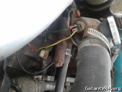

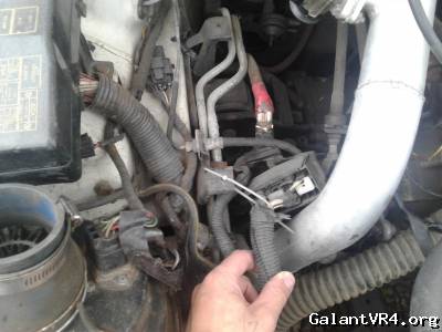

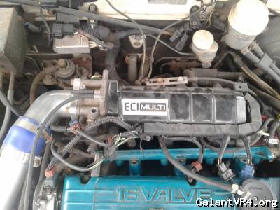

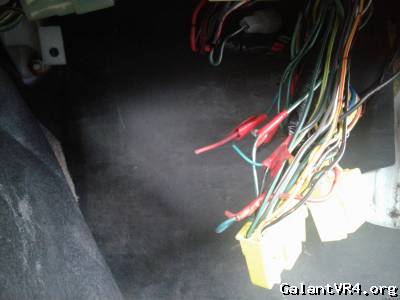

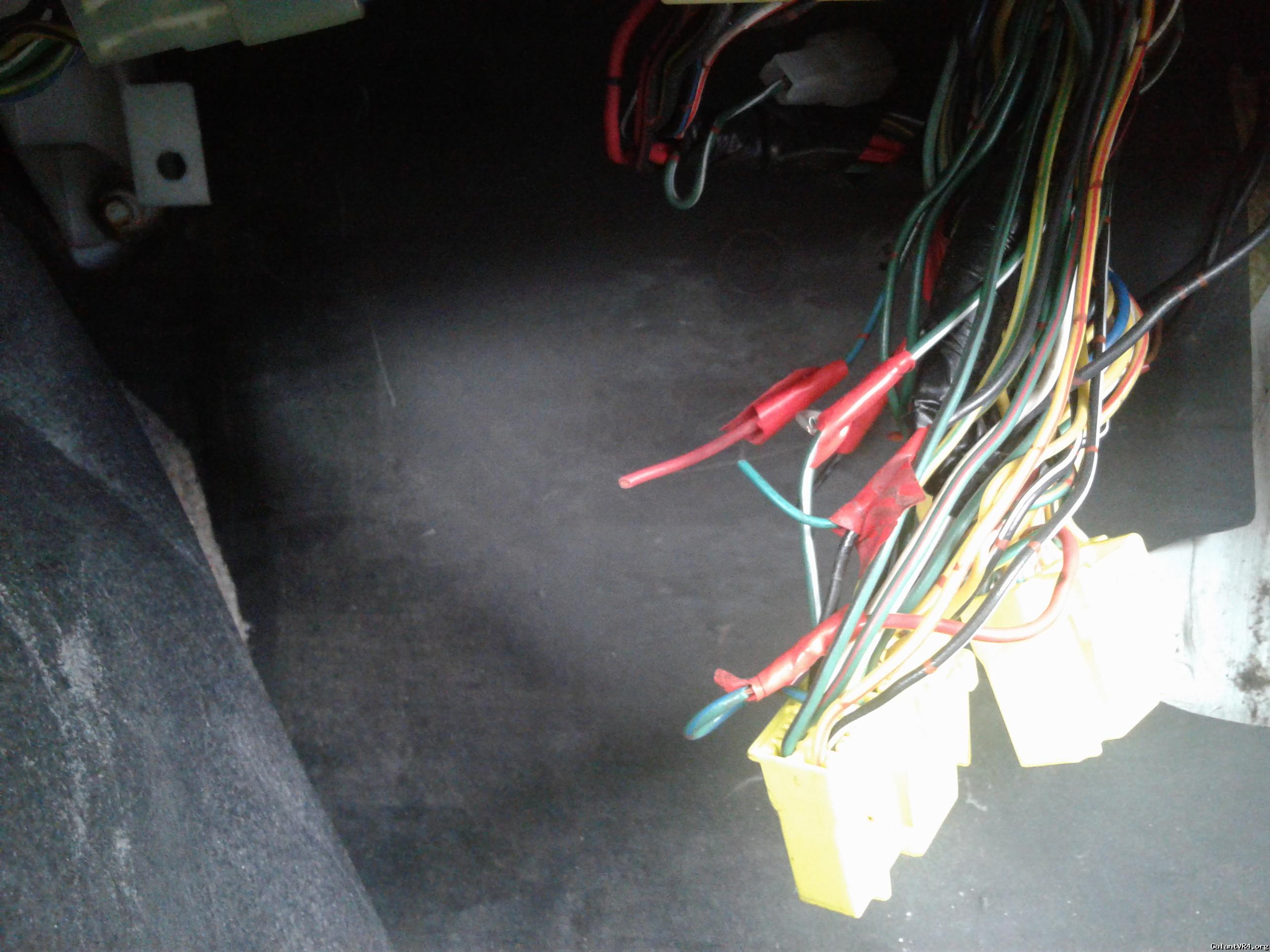

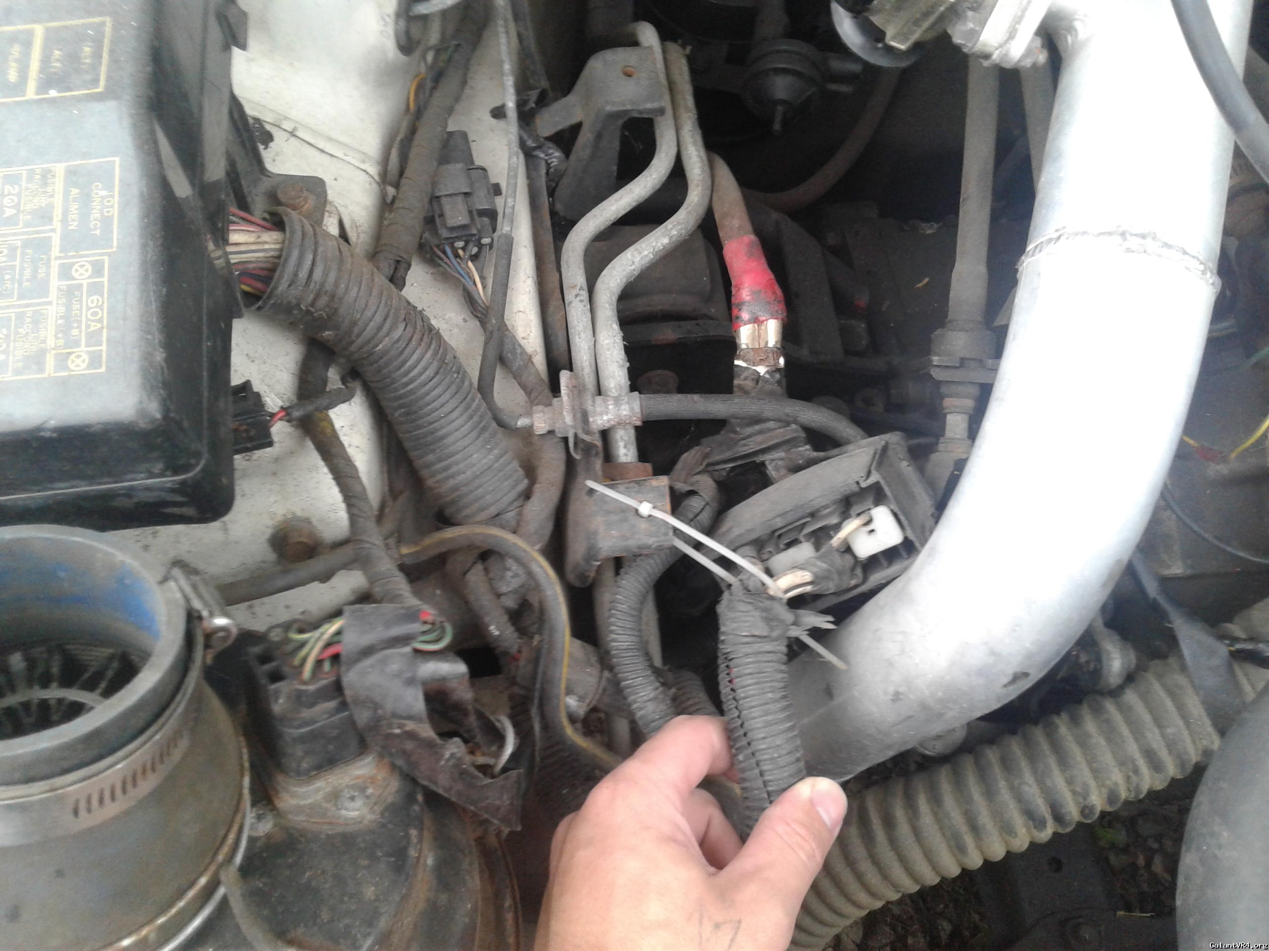

Doesn't build boost.. Doesn't want to run, had a safc on it at one point it's fine, the maf looks like a stocker but wires has been messed up, it does have a bigger then Stock Turbo
But it's far from a good runner.

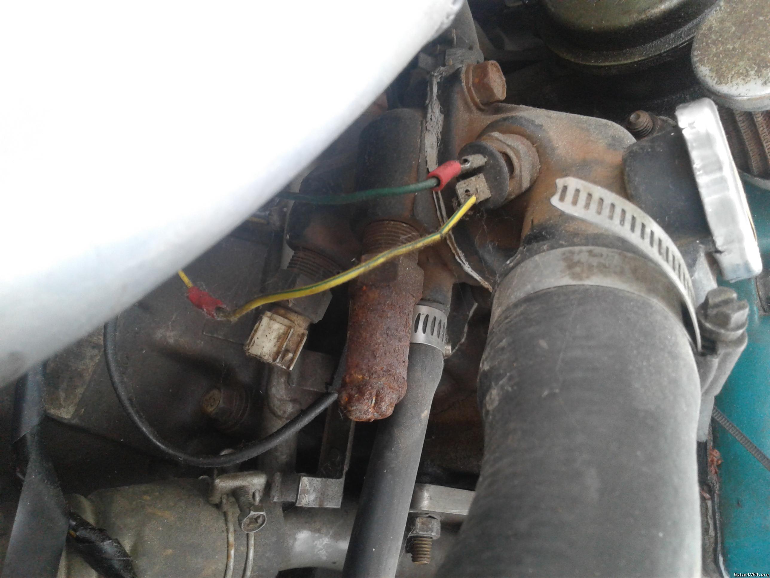

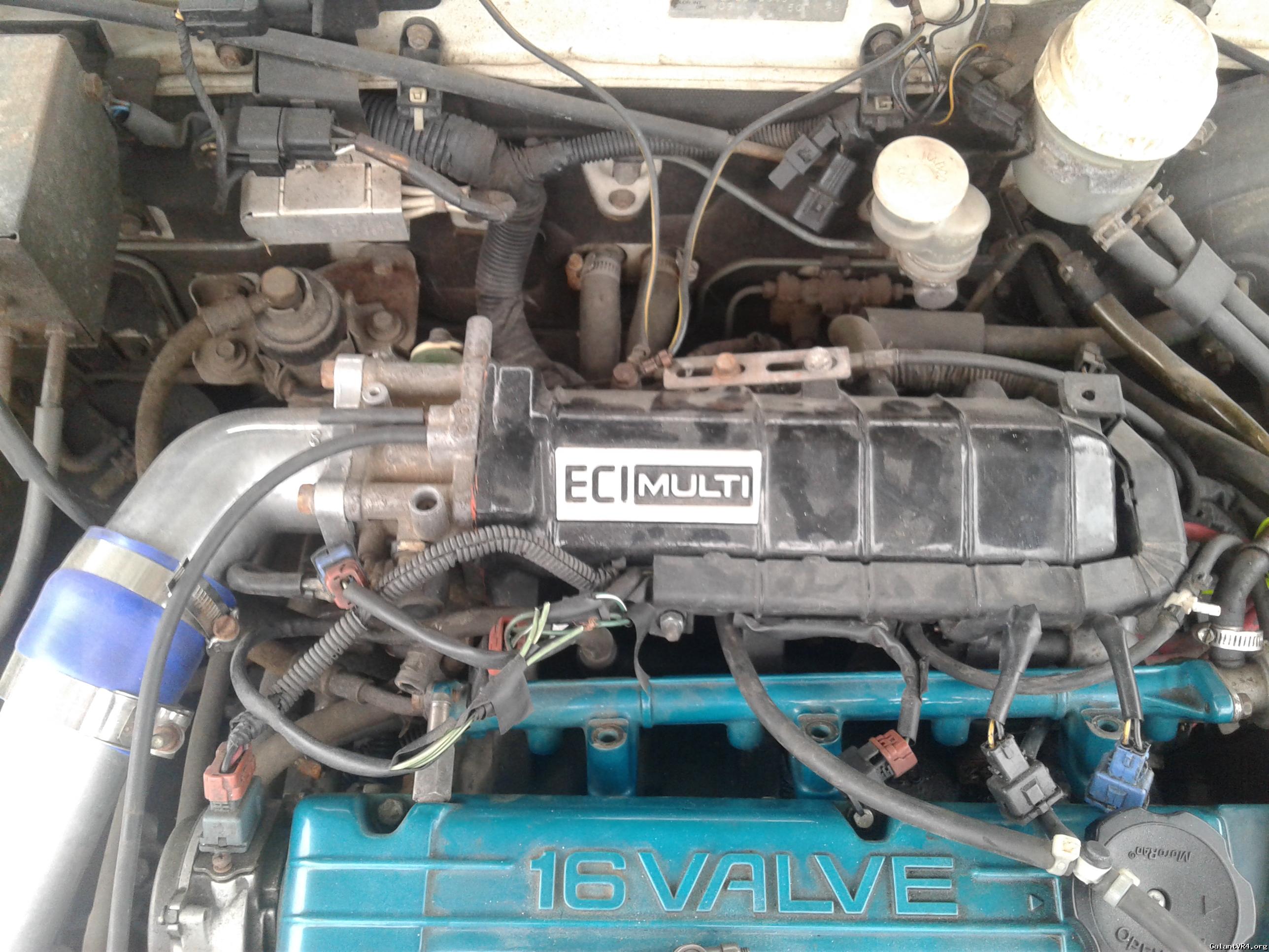

Post some pics of the car and the wiring so we can see what you are starting with.

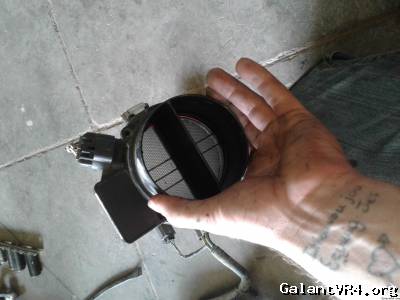

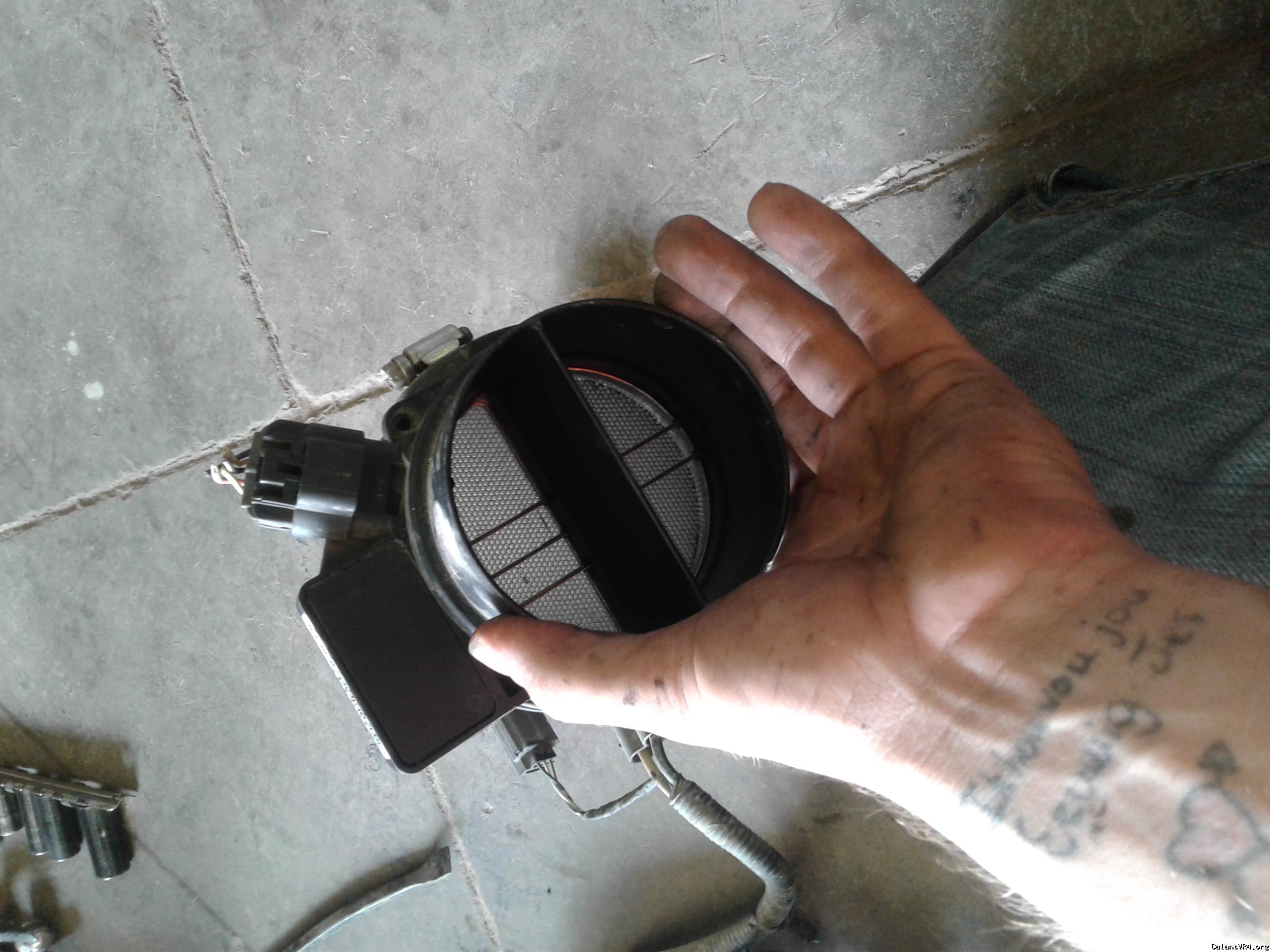

Going to try using the 3.5in gm maf with maf-t and 550 rc injectors and a ported 16g and alot of tlc to get it back into running condition.
I know the 3.5in gm is a bit big,and going with 3in piping would drop my boost pressure 2-3psi( just a guess) but would it fun eh ok till I get a better set up?
Or would it be better to keep is 2.5 then jump up to 3.5 and back down to 2.5 before and after the maf
3,473
It would be better not to use the GM MAF and MAF-T at all. They typically are horrible to tune, and work like sh*t compared to other MAFs that are available for these cars.
What are you tuning the car with?
