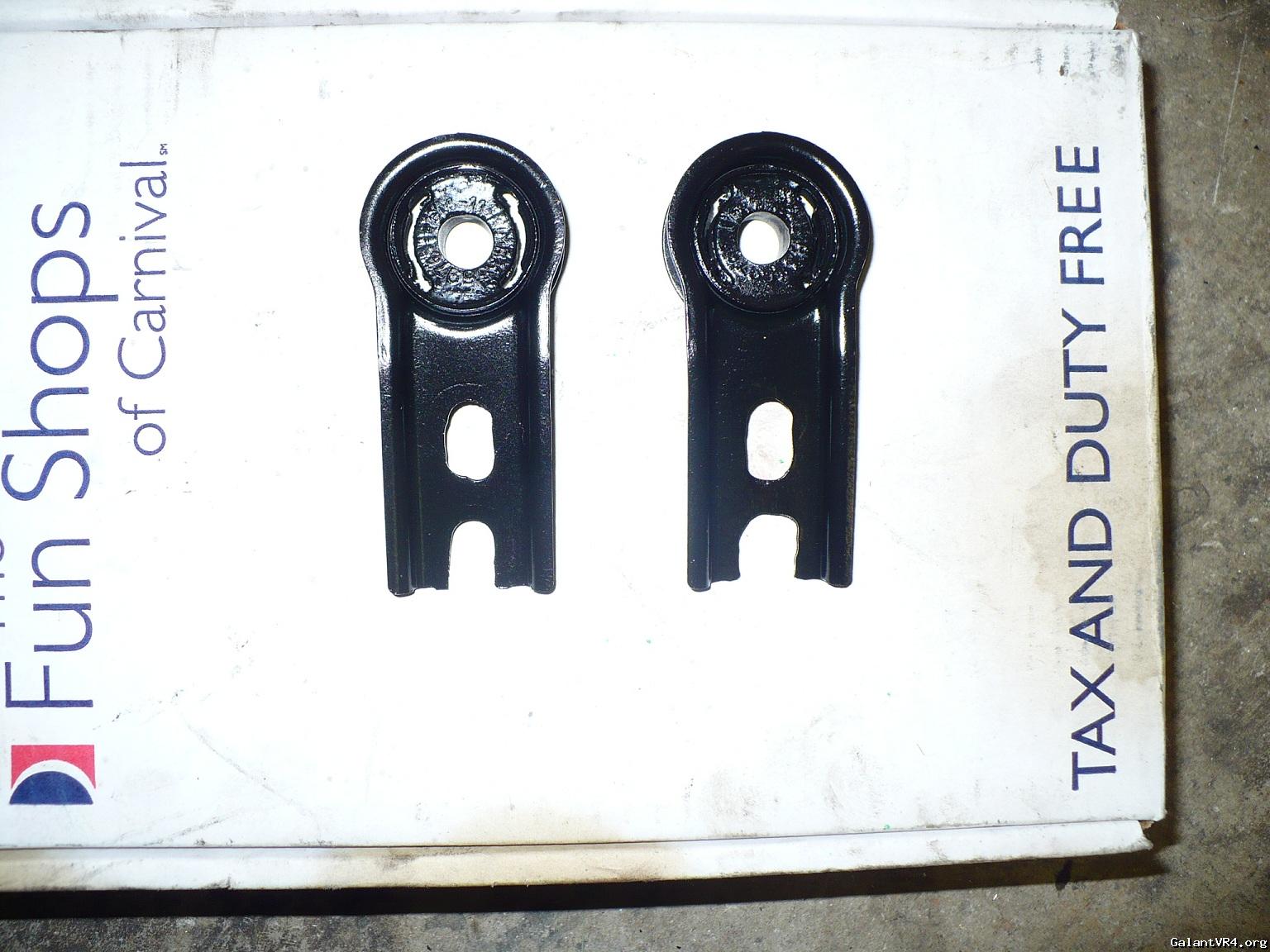

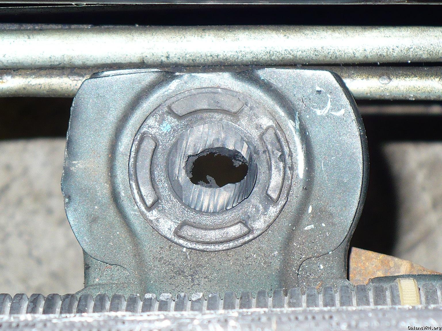

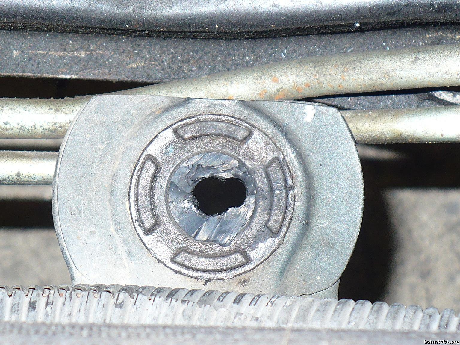

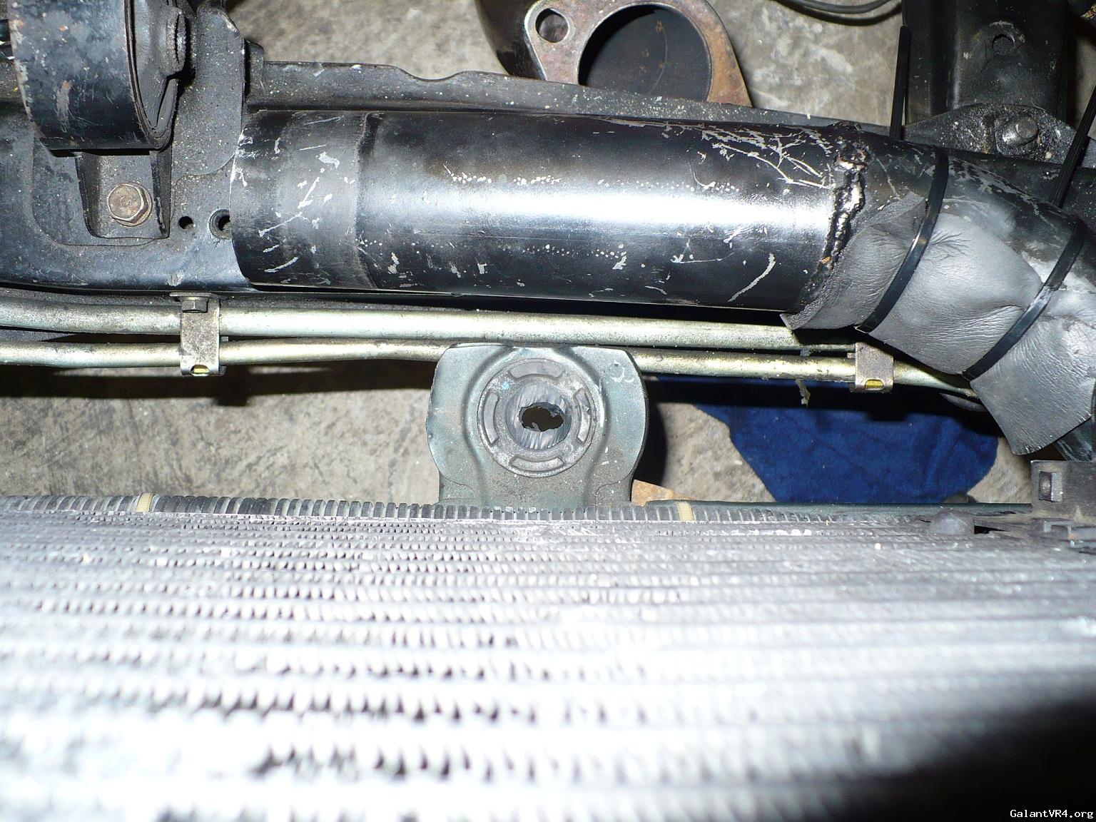

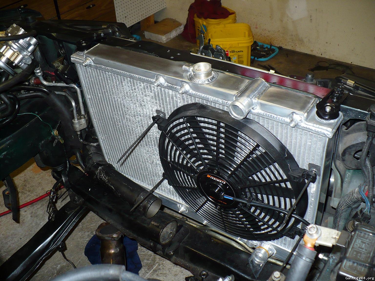

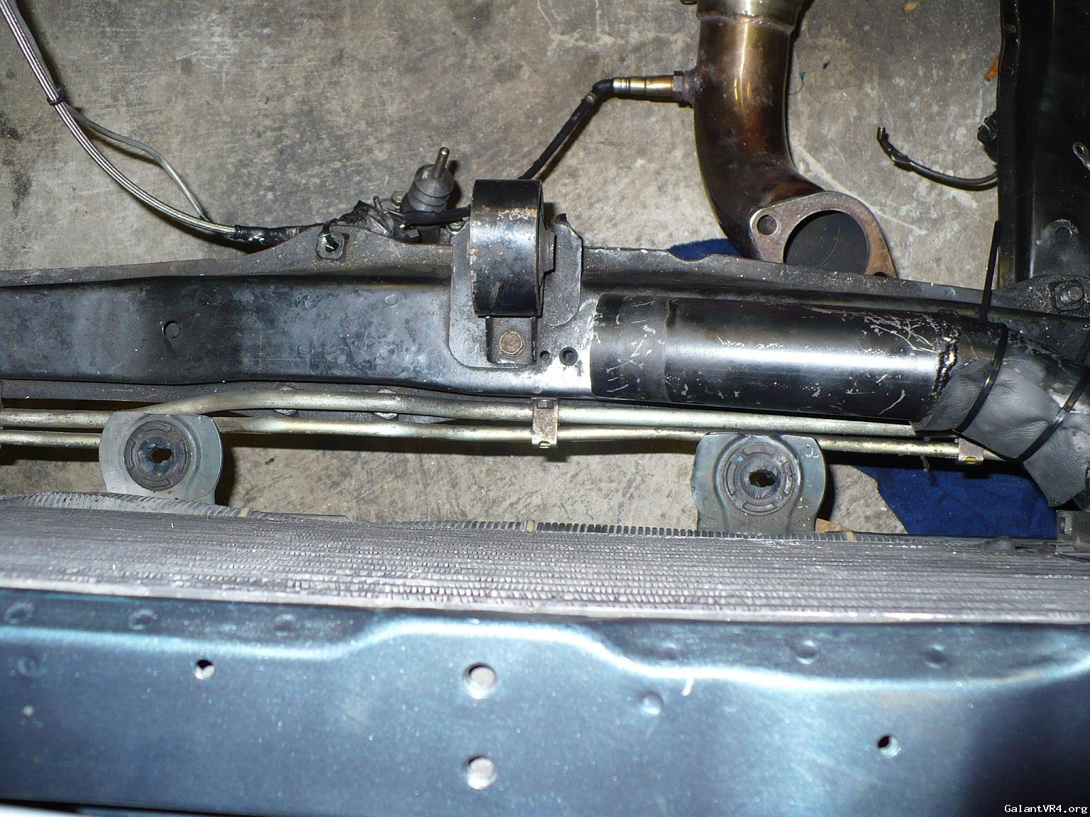

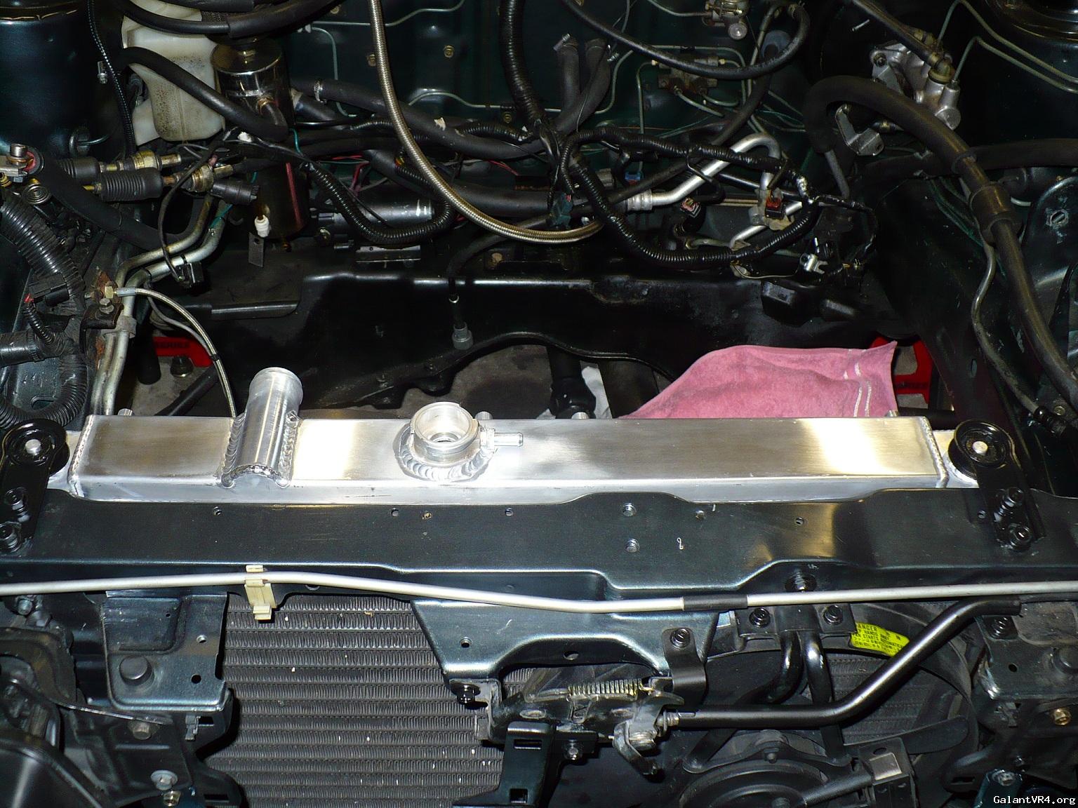

I purchased the radiator off ebay for a 89-92 GVR4 and it didn't really fit right. First thing I did was cut off the 1/8" of rubber on the Bottom holes to drop it down a little. Then I had to move the holes over toward driver side a 1/4". The top brackets I had to elongate the holes to fit cause the radiator was wider then stock. The sensor in bottom doesn't fit. You need a Drill bit and tap for 14x1.5mm for the sensor. After all said and done it fits pretty good. Tight fit by intercooler pipe but it works fine. Good luck... Vinman
