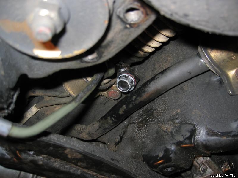

besso two lines on the front power steering rack, the pic isnt showing the rack or im just blind. if you look under the car at the rack you should be able to see which ones need to be blocked. as far as the rear you will need to weld them shut I believe (i planned on just capping it off but it was a PITA so i ripped it all out and put a 4bolt in), also the reservoir for the power steering has 2 nipples that need to be blocked or try using a 2g reservoir (i dunno if the cap w/ sensor fits the 2g) good luck that sh*t sucks.
crap pic i found of the front rack

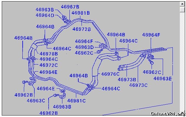

Yeah, you need to cap them off at the right. If you trace lines 46973b and 46973c forward to the rack, you will see which two you need to cap off.
