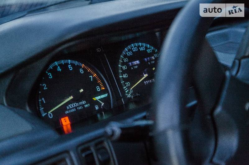

Hello sir, no check engine light, no coolant temp warning nor overheating. Its just like a normal rev cut when it touches 6000 needle wiggles back and fort at the 6000 rpm zone /ubbthreads/images/graemlins/frown.gif

would it matter if the meter panel tach redline is 6k rpm?

^^ 4G67 is a DOHC engine with a 7000rpm redline. The rev cut is built into the ECU rather than the tacho cluster.

Hello everyone thanks for the inputs. Apparently i bought a new panel gauge which has a 7000rpm redline. And now it does rev up to 7000rpm. If only i can post videos to show that the panel gauge is not accurate.. I suppose it should work fine even on the 6000rpm redline. Is there something i miss on the groundings or anything.. And one last thing.. My car seems sluggish.. Do we manually adjust ignition timing for 4g67? Or like modern cars no need for timing gun? Thanks
