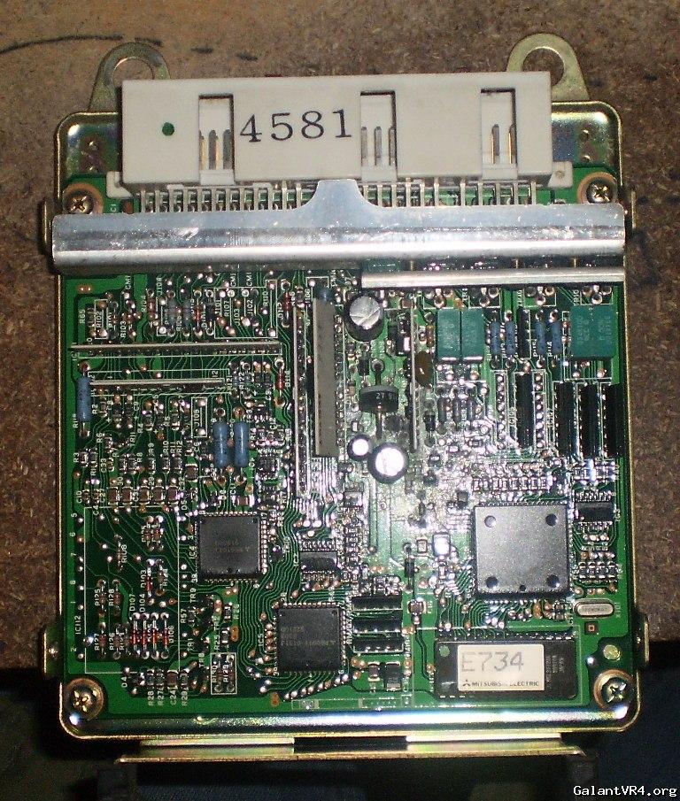

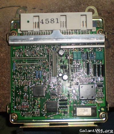

MMM must have some luck on my side, unless I'm mistaken the suposed 4g67 ecu with eprom from my wifes jdm 6g is infact a 4g63 ecu /ubbthreads/images/graemlins/laugh.gif EProm chip has "E734" on it. I was searching dsm-ecu for the correct 2lt .bin file and when I found it and compared it to what's in my ecu it was the same "E734-NT JDM 2.0 Galant, Cyclone, no knock sensor FWD" Here's a photo (yes the caps are leaking, first thing on my list to replace)
