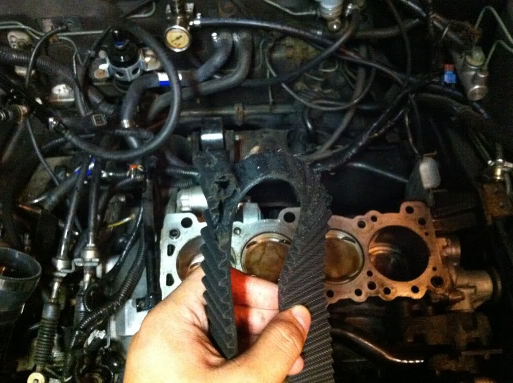

My car skipped timing while moving it in the driveway. Thankfully it was there and not on the road. Didn't have time to go to the cookout, or work on it due to college. Came home today from college for a few hours and worked on it with my brother. Pulled the timing cover and head and found the valves had bent. Going to reuse the L19's get a OEM HG, and get new valves and a timing belt.
Pictures and explanations below.

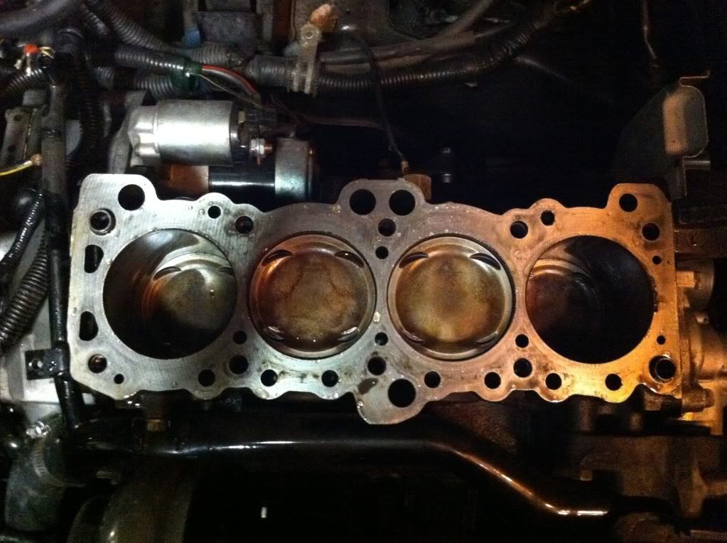

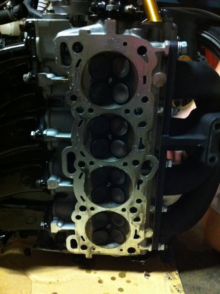

Went home today and pulled my cylinder head with Dan. Just about every valve is bent.
Pistons came out of it alright, no real harm done. A little nick on the tops, but those will get smoothed out.
The cause of the incident. Timing belt separated at the chords. I had leaking cam seals, and it soaked the belt in oil. Chords degraded and it just went, ironically days after I installed the new cam seals.
Sucks right now, but I'm going to try to get some things straightened out, then try to get it running again and tuned by the time winter swings around.

I think what he meant was the cam seals were leaking, replaced the cam seals, then the timing belt broke as the damage had been done to it. Beautiful car btw, loving those wheels on the KG!
jepherz
Aug 8, 2004
7,878
KC, Missouri
That really sucks man. Sounds like the same failures people blame on contitechs are just as likely on OEM. In regards to the question about the kevlar belts, I'm guessing that wouldn't matter. The teeth are probably a separate layer on any belt and that's the real problem here. Kevlar may resist stretching better, but probably can't resist teeth separating.
