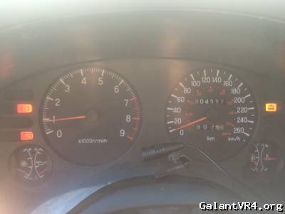

Help me out guys! 1995 eagle Talon TSi, a few mods and it had a relocated fuse box from the previous owner.. Soo the three lights to come on are the e brake (!) in a circle, the charge battery light, and some weird one on the right I don't know about! I have a photo here, my dad and I cannot find the problem, maybe someone has ran into the same problem?! Thank you! Here's the picture!

The yellow light is a coolant light, I think it's low coolant level, don't remember off top of head. The Battery light indicates poor charging, the brake light indicates low brake fluid.

Okay well that's awesome to know! However my friend, All of those things are totally fine, full of coolant, brake and clutch fluid are minty, and battery is perfect. is there a fuse connected to those three things perhaps? Or a ground somewhere may be iffy? Or, possibly my positive is shorting out a bit somehow?

Diode bridge in alternator is gone. Those three lights flickered on right before my last alternator died on my 1g.

Had the same issue on my Galant. The lights came on faintly, and would cycle on and off, causing my dash and head/tail lights to flicker. Made it all the way to the Shootout and back like that, still charged the battery. I replaced it anyway and she is happy.

Yeah guys! You're all right, it was simply the alternator! I don't know why I didn't just unplug
It to test it, but I did not and yes sir's it is!!
Thank you all!
