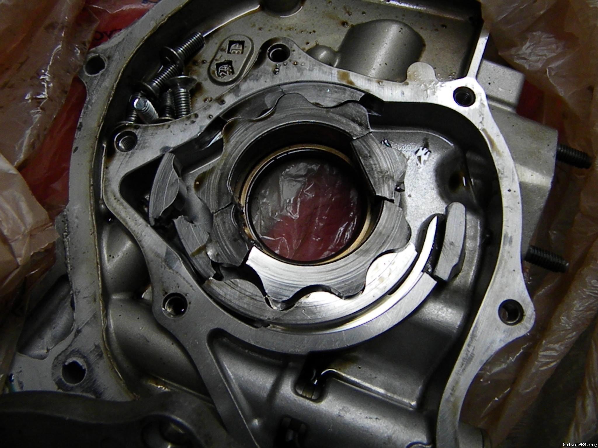

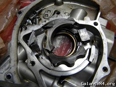

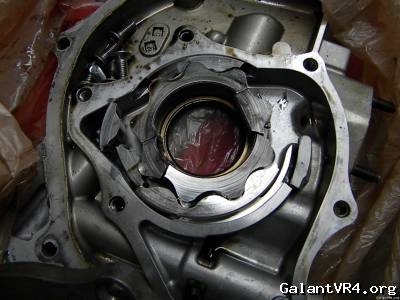

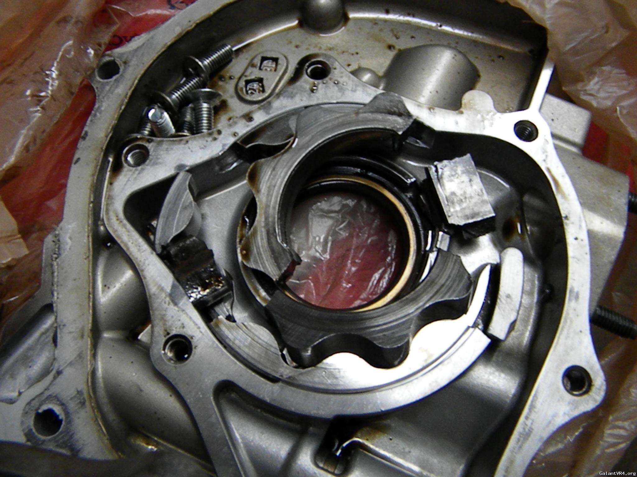

Well this is kind of on subject but maybe not really. I spent about 10 years of my adult life around aircraft. Apaches, 58's Hawks and hooks then later to civilian junk everything from Citation X to old school pipers, beach bonanzas and baby cessnas. Vibrations can screw sh*t up almost instantly on an aircraft. Anywho some 4 cylinders don't have such things to begin with then when you turn them up and start spinning them well past the factory redline vibrations start changing things, like weakening the metal on a microscopic level changing the grain structure even on case hardened parts.
Here's a prime example. My buddies b series Honda we built a few years back. Motor had about 4K miles on it total in about 2 years. He spins the crap out of it and never had the boost much past 15 psi.
60 to 150 if you want to watch.... click me Car started over heating last fall. Car acted just like it had air in the system. We changed thermostats sensors burped the damn thing 2 dozen times but would be fine then go to crap and be fine again. Drove us nuts for weeks. Then the car sat for a few weeks while we put on the widebody front end and made a few changes and he took it to buff the new paint at another friends house and after it was finally detailed took it on a run down the interstate to test the car before the import alliance car show in Nashville the next day. Hard pull in 3rd then 4th and lifted and turned down the ramp. Half way down the ramp oil light came on but no noise, he took a right went about 100 yards to a gas station and checked the oil. NO noise when he started so he started home Thinking it was just a sending unit ......then the gravel noise started and he pulled over.
Well bad sh*t happened. Towed it to a friends garage so he could tear it down over the winter and this is what the oil pump looked like
Case hardened gears plus metal fatigue equals a slight drop of oil pressure. /ubbthreads/images/graemlins/grin.gif I believe the inter ring cracked at the flat areas on the crank first then caused the driven gear to then have a catastrophic failure. One thing we did find was the calico coated bearings saved the crank and rods. Only damage to the engine was the oil pump. /ubbthreads/images/graemlins/dunno.gif Got lucky. Its at the machine shop now and getting new big boy rods put in and hot tanked decked etc but no damage besides the pump. Now before anyone says should have got a factory pump it was a factory one. From all the research we did the fix for this is a ATI balancer instead of the factory one. Thank God the 4G63 has a gear style pump over the Honda design or I'm sure we would be killing them as well.
So what I figured was the oil pump was loosing pressure and causing an increase in heat in the motor and the coolant system couldn't keep up because the head gasket looked fine and its a fancy sleeved block and has no cracks there either.
I personally would be tearing the truck down Saturday to get this lined back up and everything in phase. Sorry for the rambling but this shows what bad vibrations and rpm's can do.
