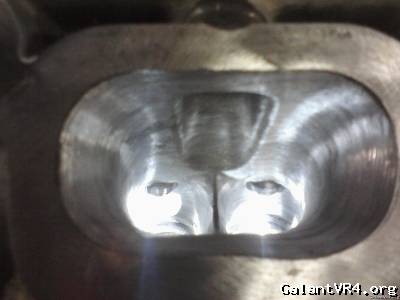

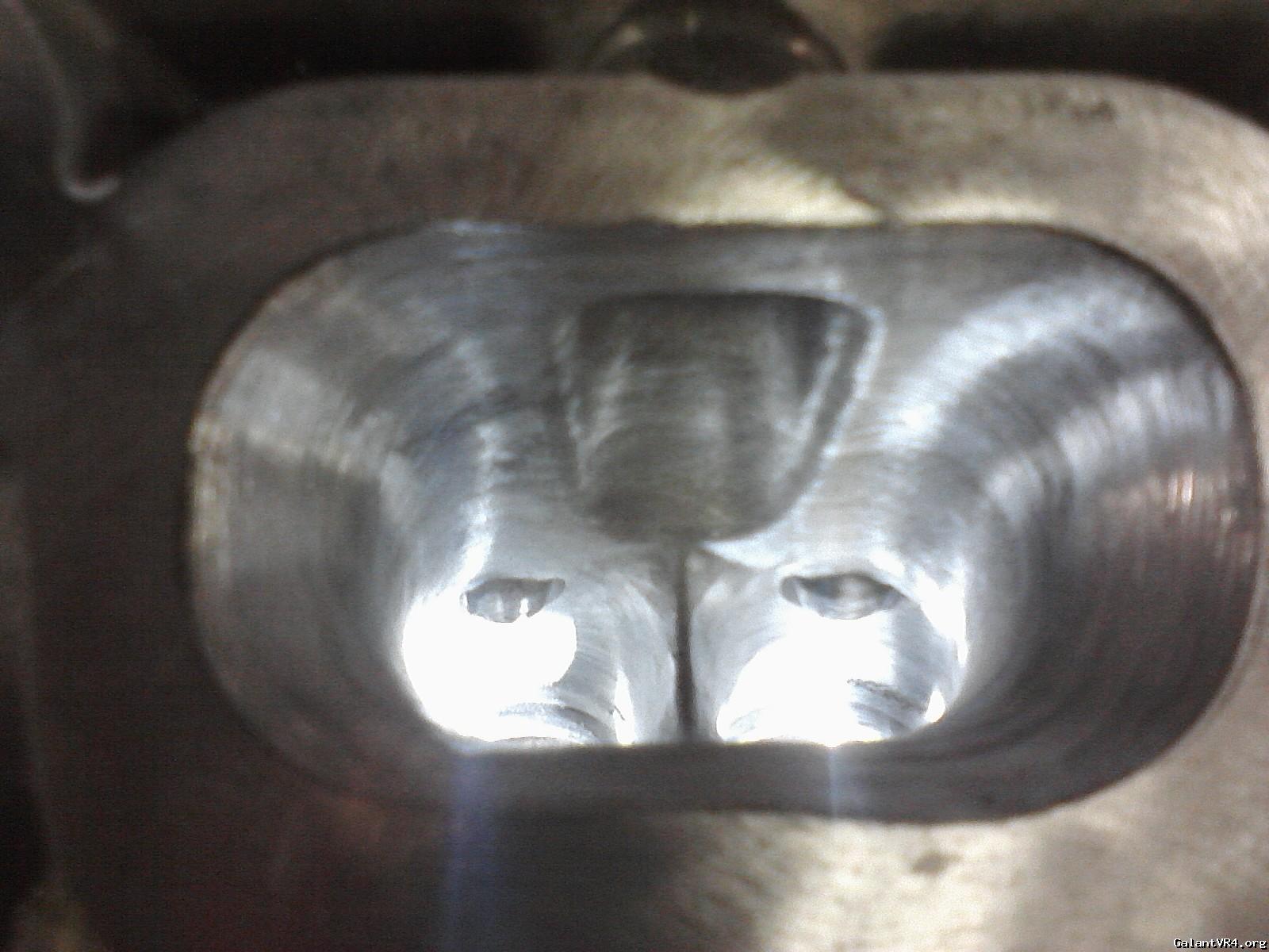

2g head port and polish job *UPDATE*

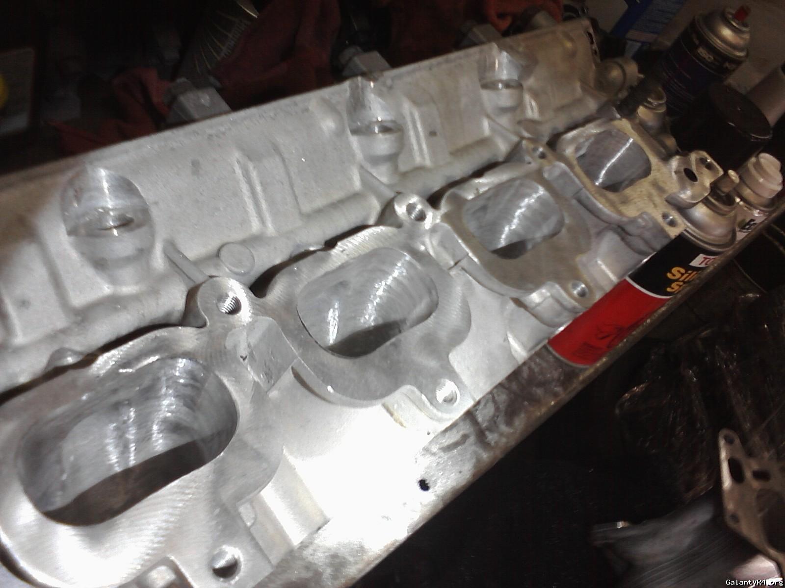

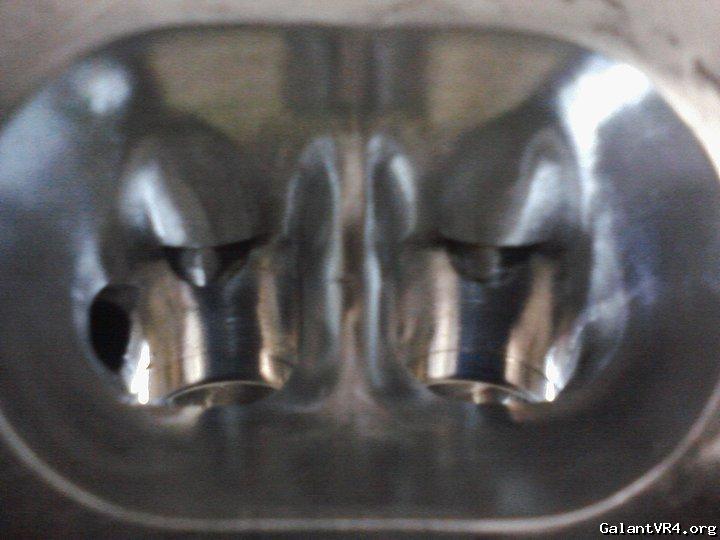

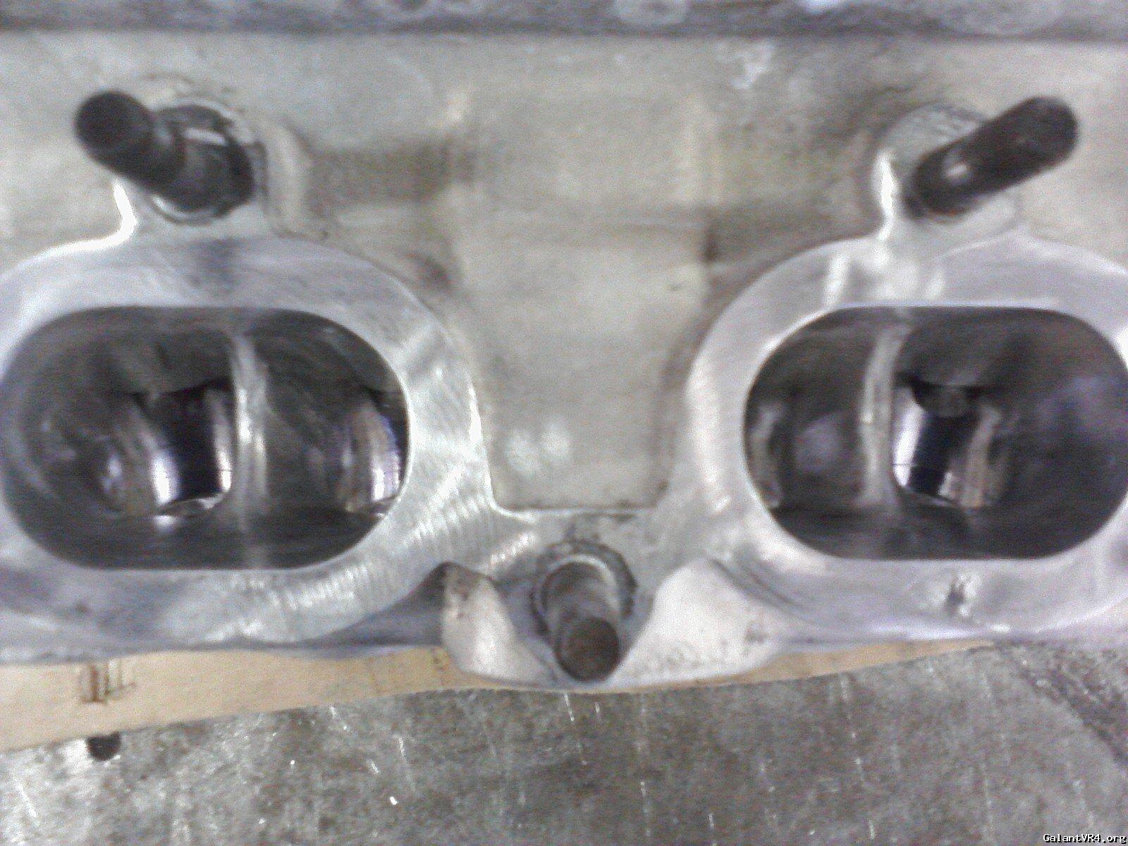

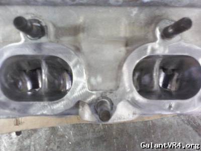

This was my first port job on a 2g head I plan to use on #1707 open to all criticism. Will post more pics of the head once i get to the combustion chamber and exhaust side.
Before
After

There is very little gain in a 4g63 esp a 2g head in porting and the best thing you can do is clean up the casting flash esp where the seats are pressed in but gains will be very very minimal at best.

was just thinking... 2g heads was made for faster air velocity right? not volume... thats where the 1g head comes in...
yes thats why i switched to the 2g head. Would love to get some numbers on it but sadly no access to a flow bench where i live

Ok one newb mistake I see, if you look to the lower left and lower right it dips. Hard to take a 1/2 inch roll of sand paper to make a straight line. But you can take a bottle of Dykem paint it on then scribe and then take a hand file and make flat. Besides that just stay away from the short turn radius and make all the casting flash go away. Also on the intake side don't try and make it 100% smooth you needs some roughness to help atomize fuel in the port. By the bench you'll loose some flow but pick up HP on the road.

Yes, it is better to have the head flow benched after porting and polishing.
I however feel that if you really only polish and keep the porting to a minimum and you can't flow bench it then you'll still be ok. The reason I feel this way is because look at a stock head from the factory. I had a bone stock head that showed about a 8% higher flow in one cylinder. It's pretty common for stock heads to not be matched. The factory gets it close but casting flaws and the bowl to valve seat have very different flaws and flow rates. Going in and cleaning this up will improve flow, but as long as you don't get crazy it's my opinion that your flow will be close enough that you'll be fine, as long as your tune isn't crazy aggressive that is. I have ported several heads this way and never had an issue. I have never truly ported or altered the shape of the ports though, only cleaned up casting flaws and smoothed it all out.
OP from your pics it looks ok, but it looks like you've cut into the port and altered the orginal port shape. This can cause issues and you may want to have it checked.
