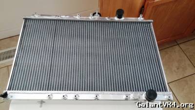

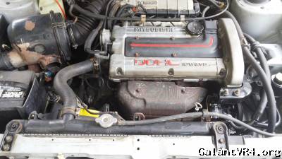

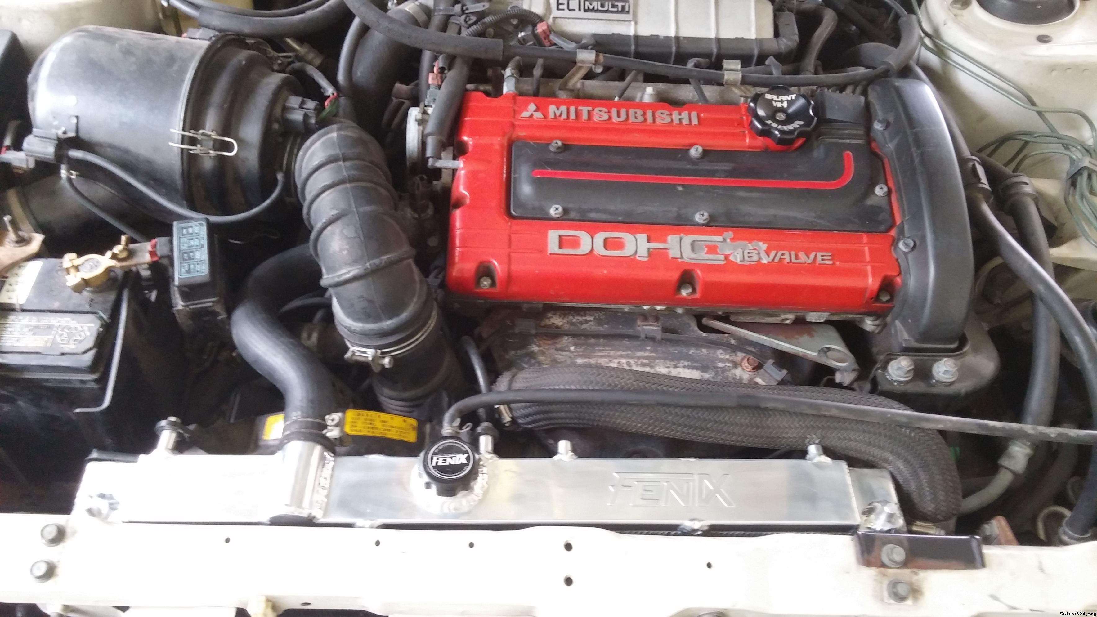

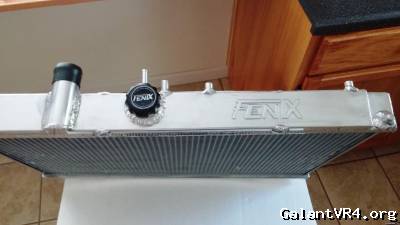

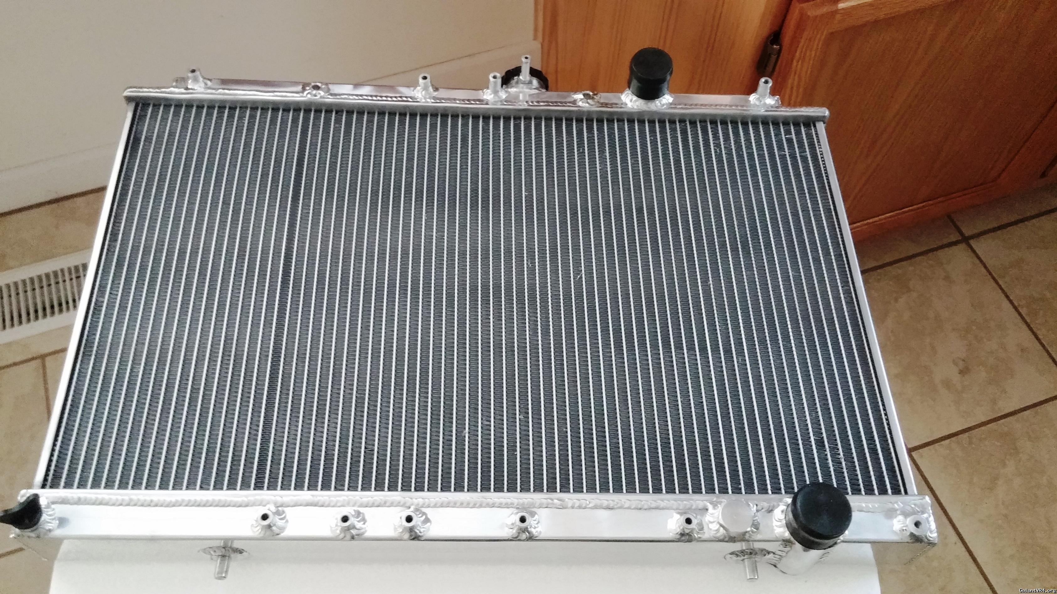

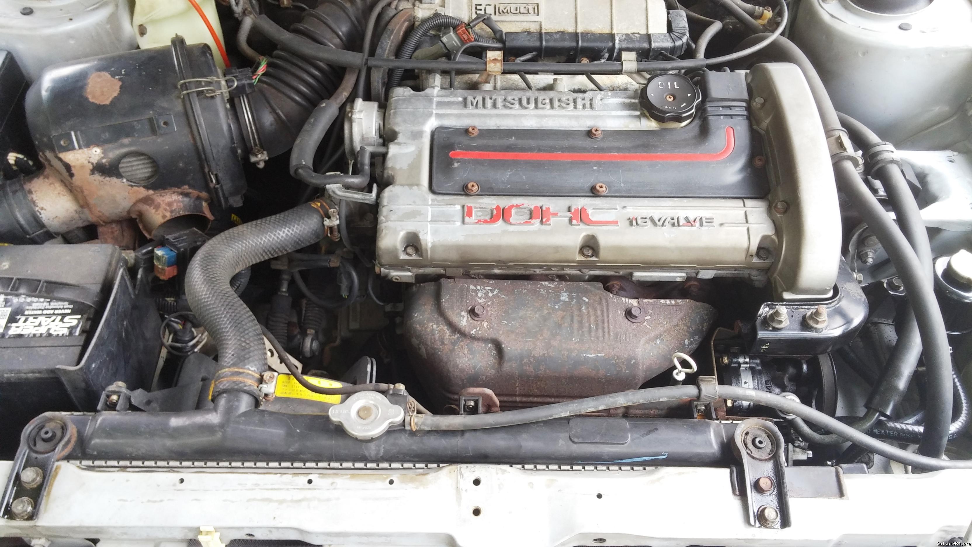

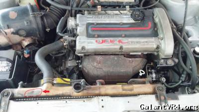

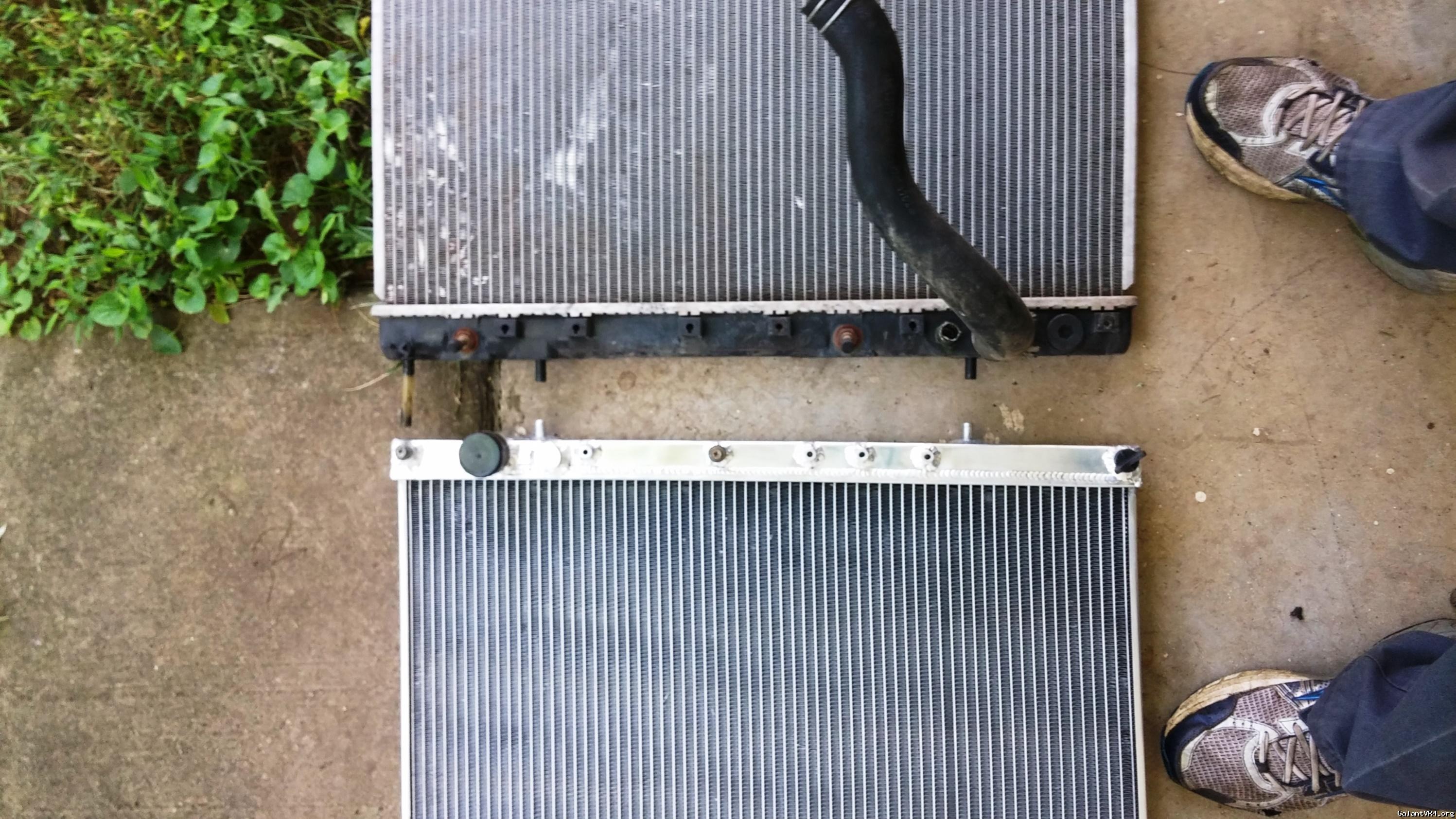

So I figure I've been here long enough I ought to start a thread for 29. I haven't done much since I bought it besides some lowering springs and struts, basic maintenance, and clean up work. It has always run a little warm, just a tiny bit, but enough to bug me. I finally bought an aluminum radiator off ebay for an EvoIII. $69 shipped to my front door from a U.S. seller. Put it in today so here it is.

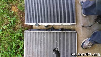

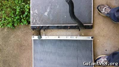

All the mounts seem to be spaced properly

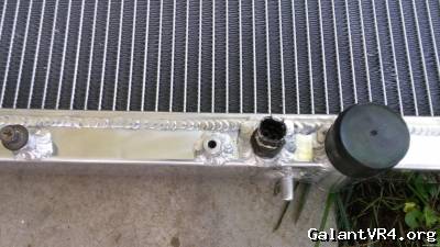

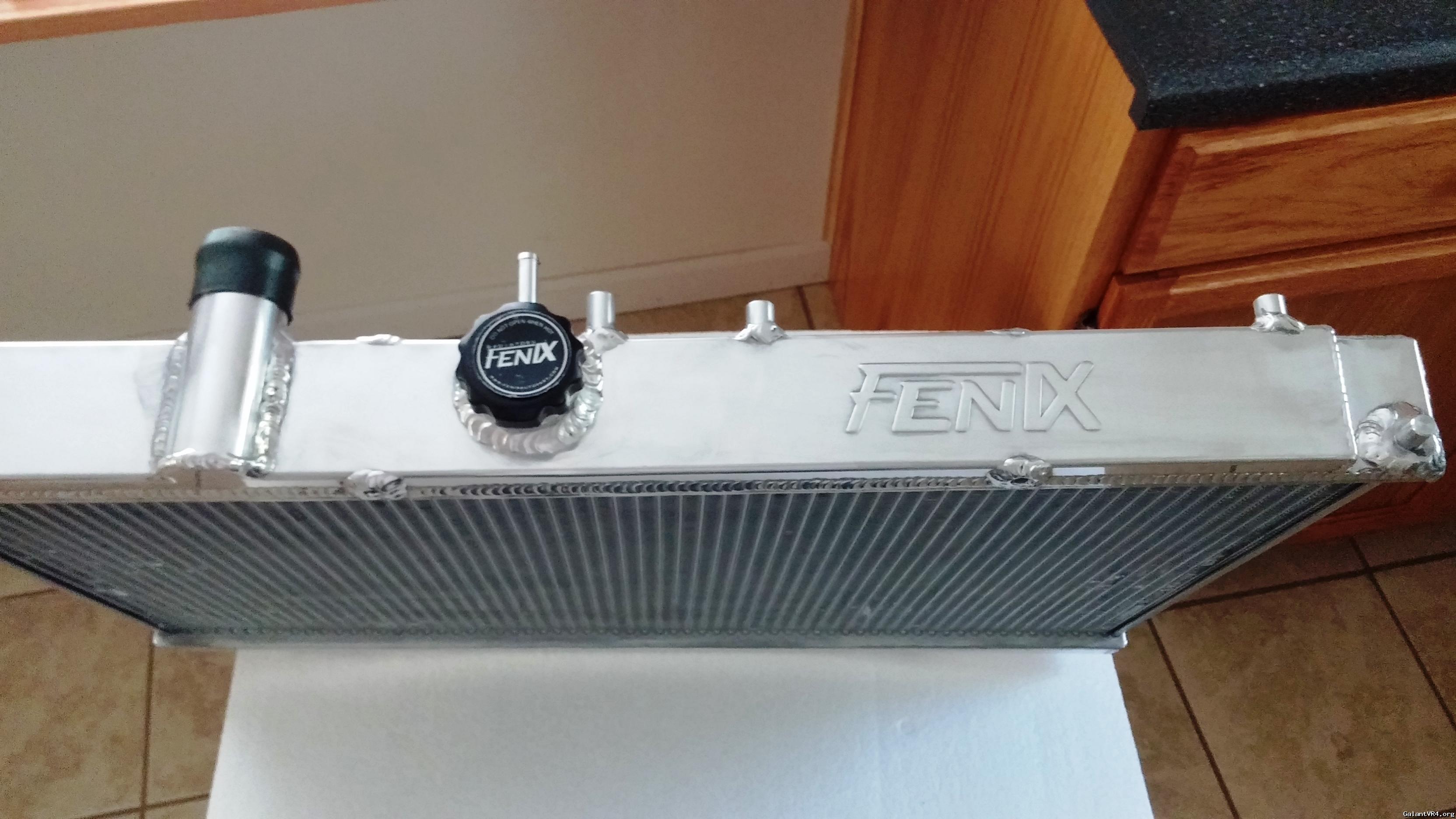

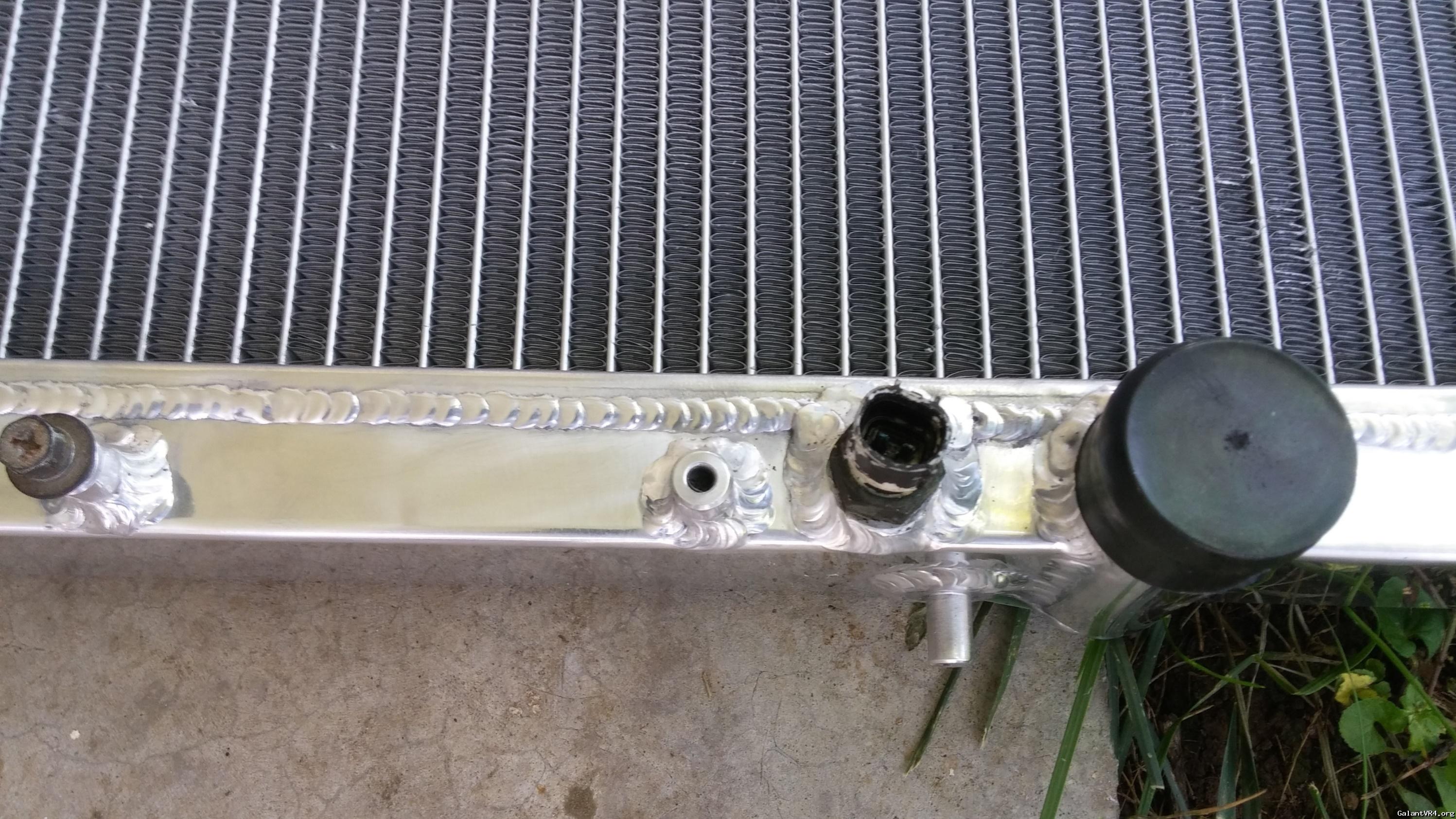

They even included a temp sensor bung

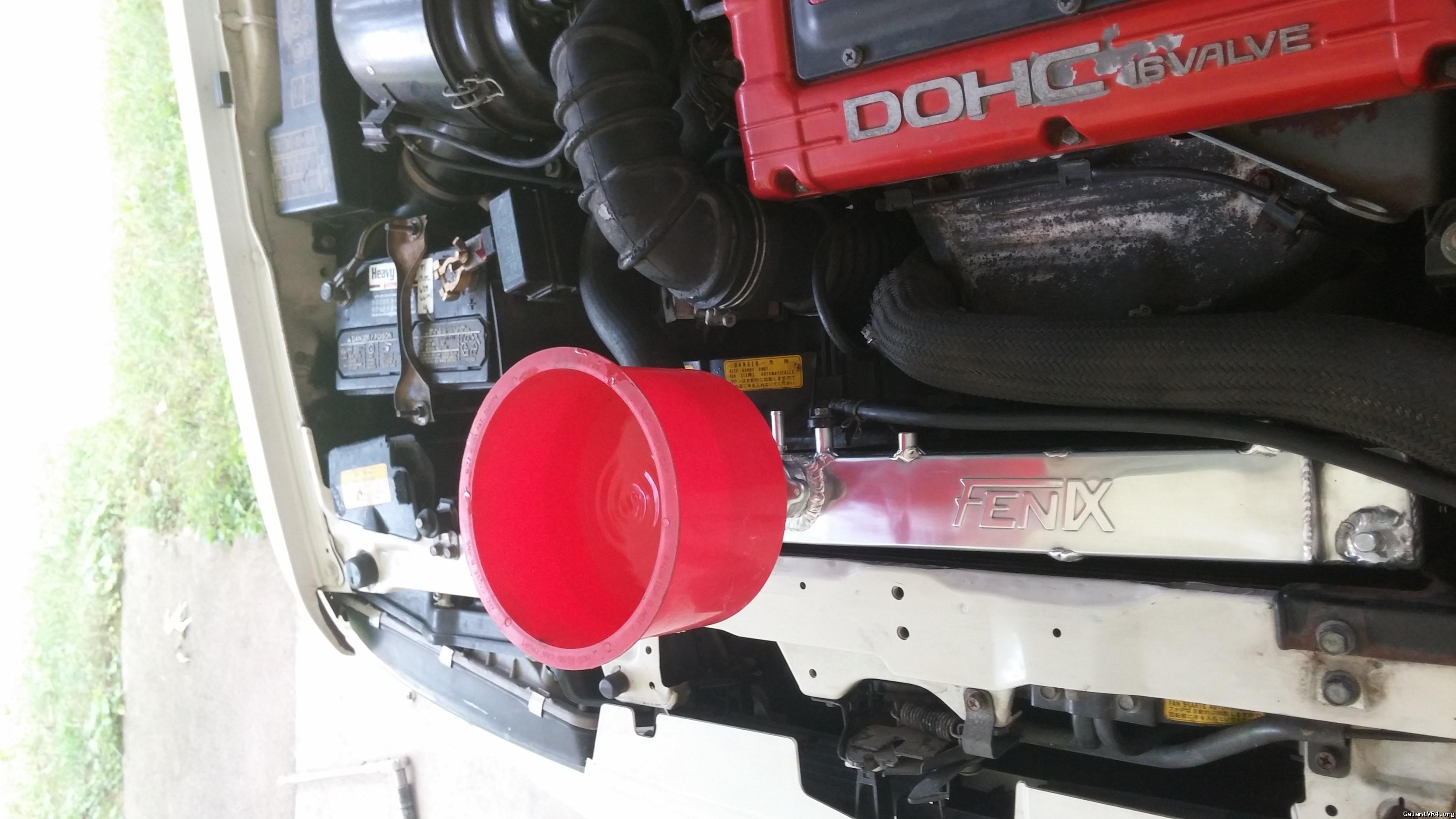

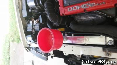

Bleed it out

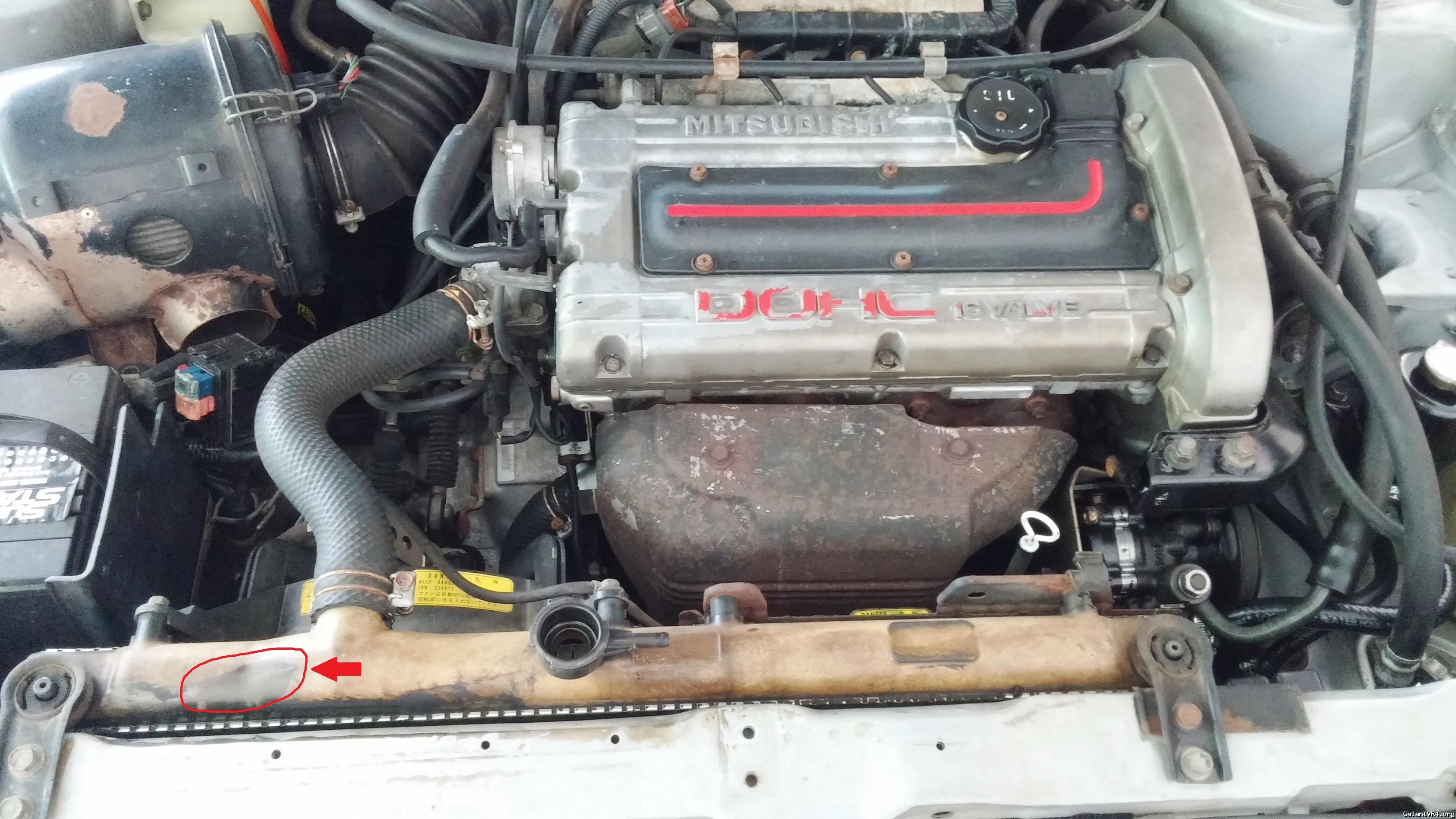

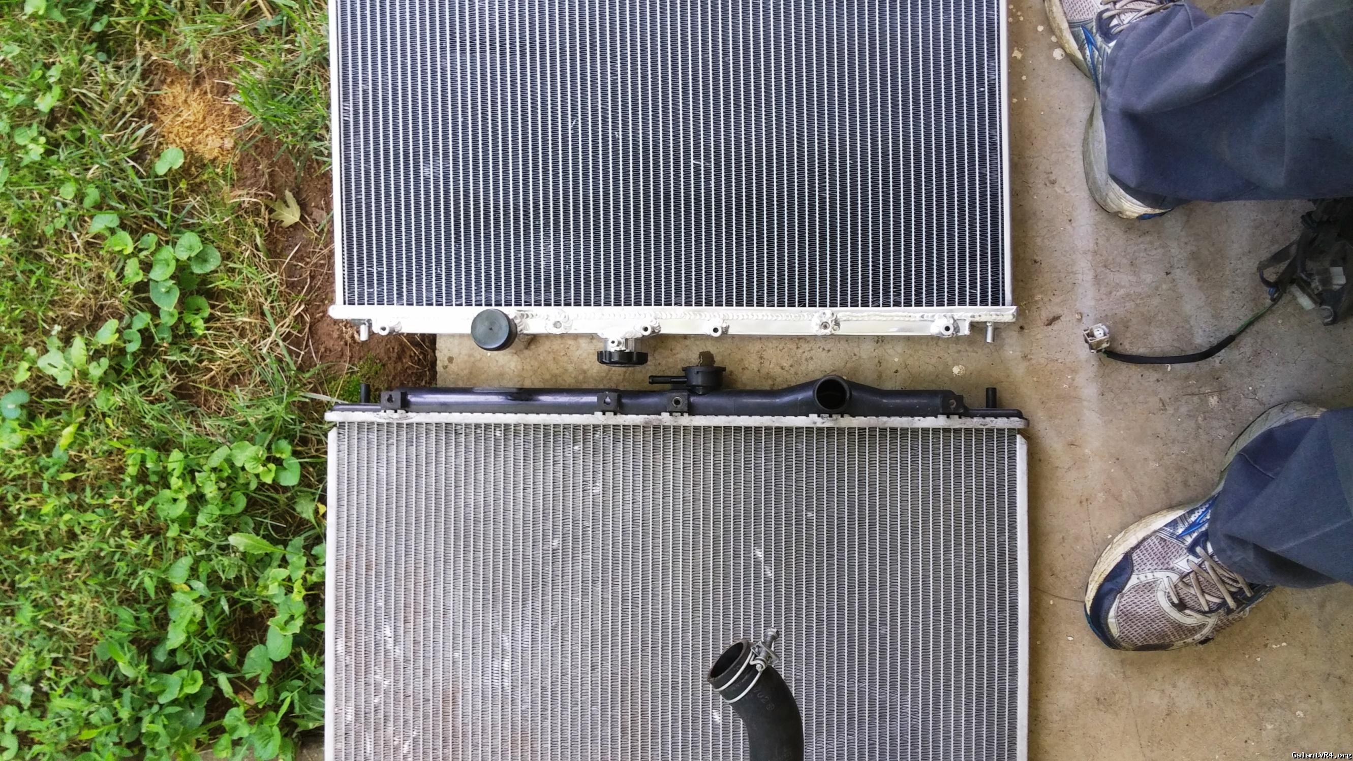

And of course 29 will pay its good fortune forward by hooking its little bro up. GSX has been in DD status with a blown radiator for about 2 months due to an unfortunate power steering leak.
Happy Galants

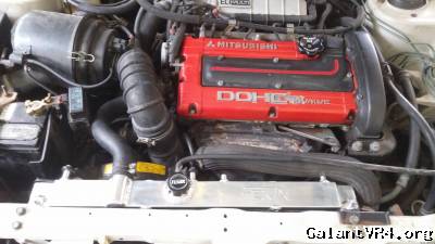

The only downside is the upper brackets don't fit anymore. I'll have to break out the welder and figure something out. Besides that everything fit great and for $69 I can't complain.
