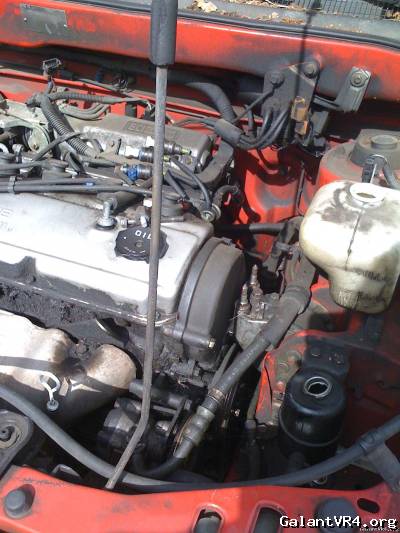

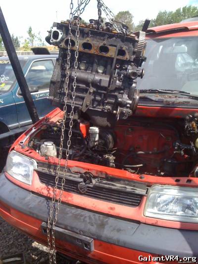

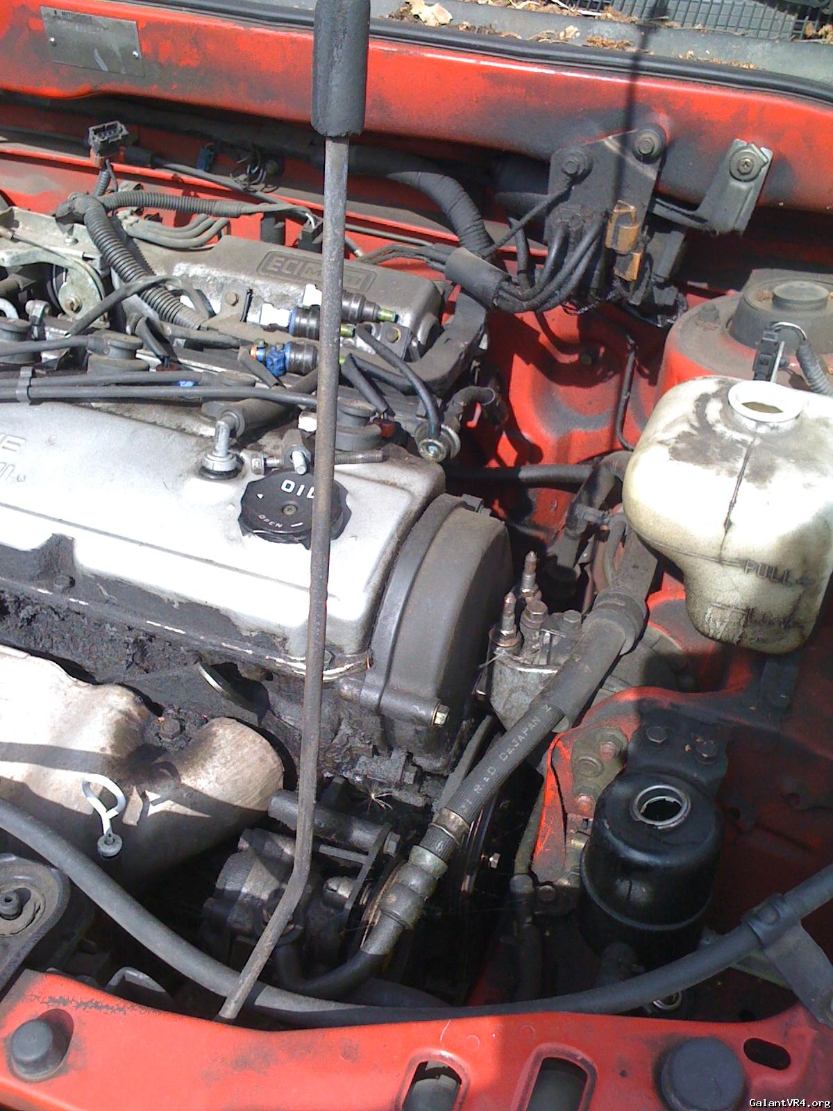

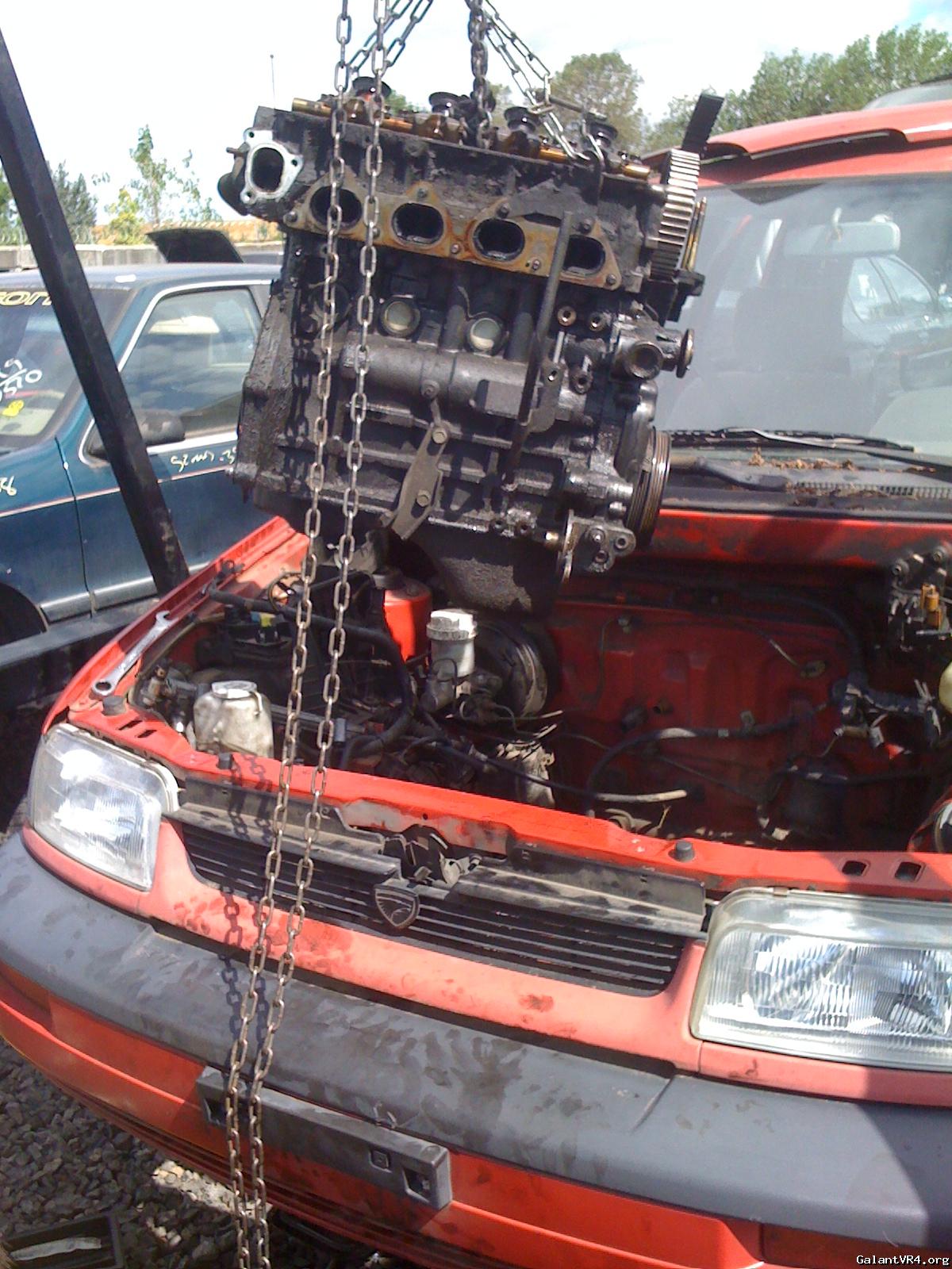

Quoting 89Mirageman:
That is a 7 bolt 4G64, it does not have the mounting holes for the front engine mount on it!
Fixed. He's not going to be happy when he figures out he wasted his money.

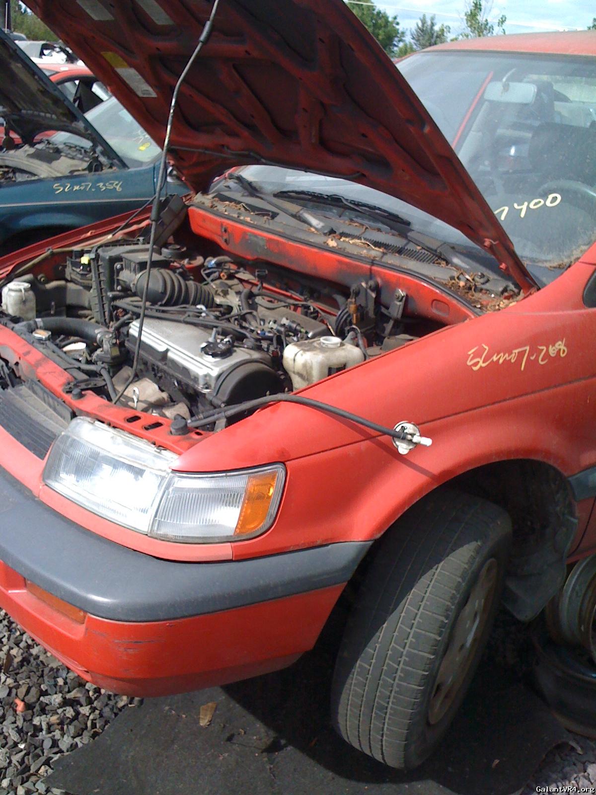

I have owned 3 of these wagons, two were the rare AWD manual ones. Only the 92 models have a true mitsu 6 bolt 4G64 in them and you can tell because they have the square 8v valve cover on them. The one pictured is a 16v found on the 93-96 models.
As far as I know none of the 7 bolt engines have the mounting bosses for a front engine mount because by that time mitsu had switched over to putting the mounts on the tranny case. It may still have the bosses for a rear mount though.
If this engine is going in anything besides a 2g dsm you're going to have to do some custom work rigging up a front engine mount.
