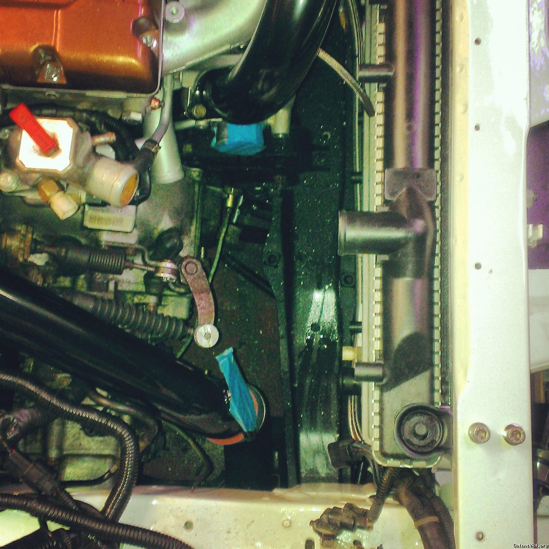

I had one on my vr4 before. The only thing i had to modify was the top mounts. The 1g style radiator is shorter so you will need to extend the studs or lower the mounts. I would just go with a scirocco radiator.

I used slim fans. I welded a 90* bend onto the stock mounts and droped them to fit the shorter 1g radiator. I would get the scirocco because it give you alot more room and cools great. Do some searching about afco scirocco radiators in vr4s and dsms.

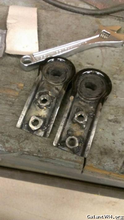

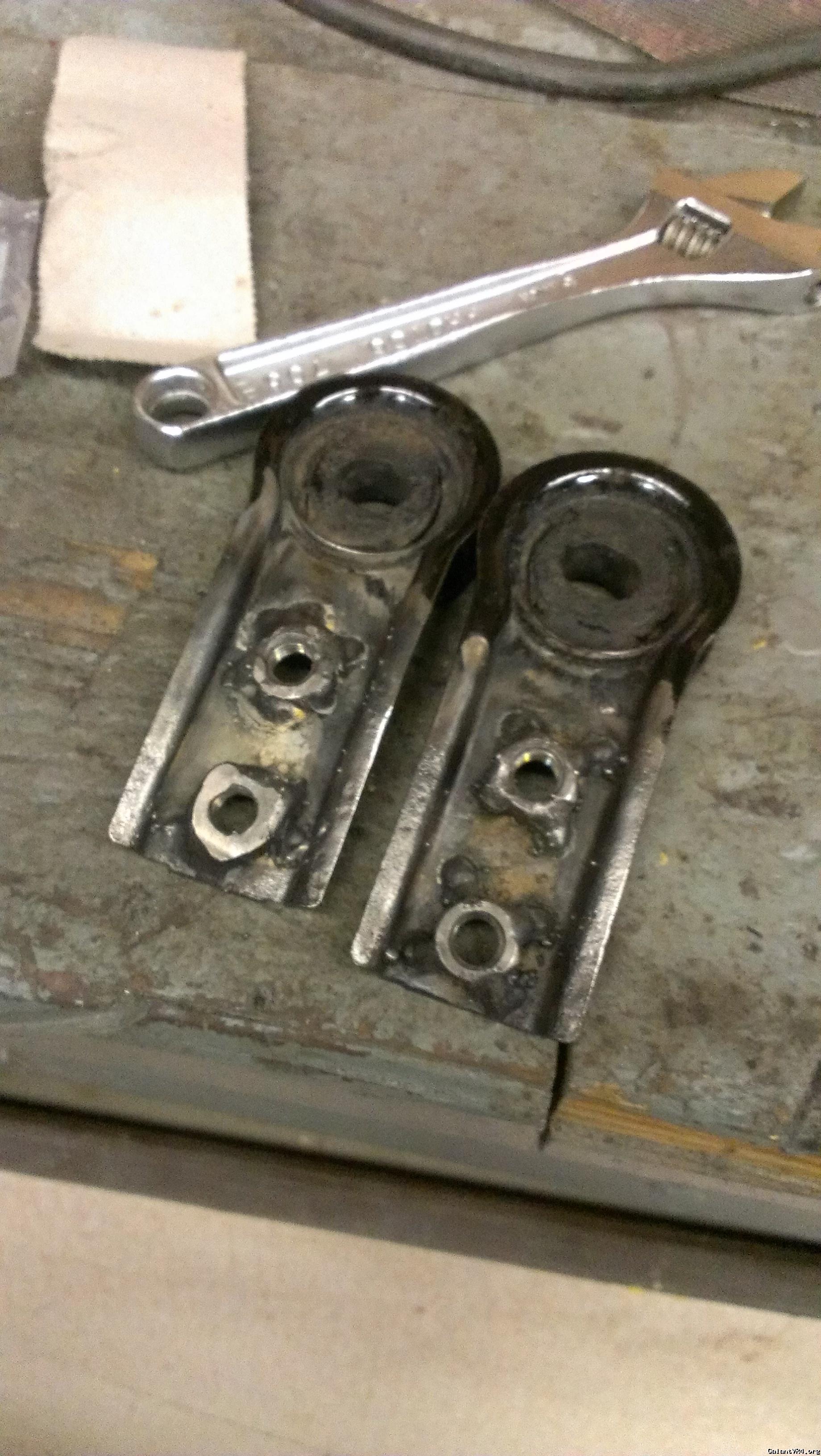

tektic
Dec 19, 2012
1,497
ronkonkoma, ny
I also had a 1 g rad. I welded nuts on to the brackets an installed them under the upper support rather than over. I was originally jus going to thread in the bolts from the bottom but it proved too difficult.
