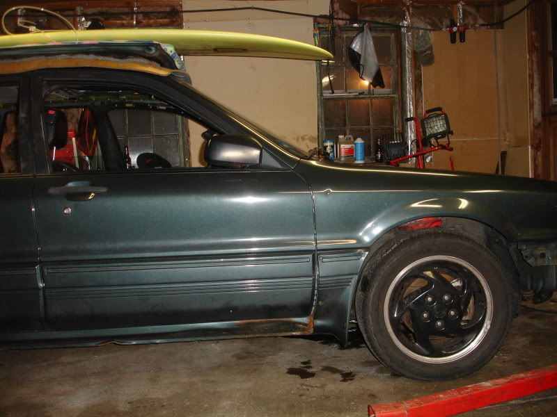

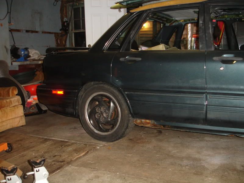

Can you describe the spacer install? I have the same issue with the AGX/ProKit install on my GGSX as you can see:
Front (after engine install)
And rear:
I don't mind the height of the rear so much, I just don't like the differential. If one end was going to be higher I'd be happier with the rear being higher.
