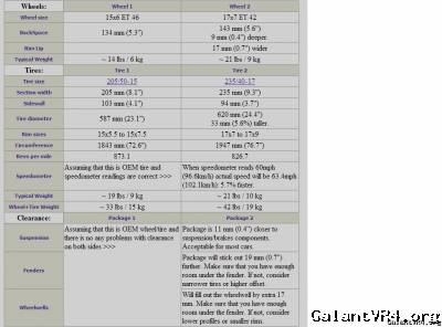

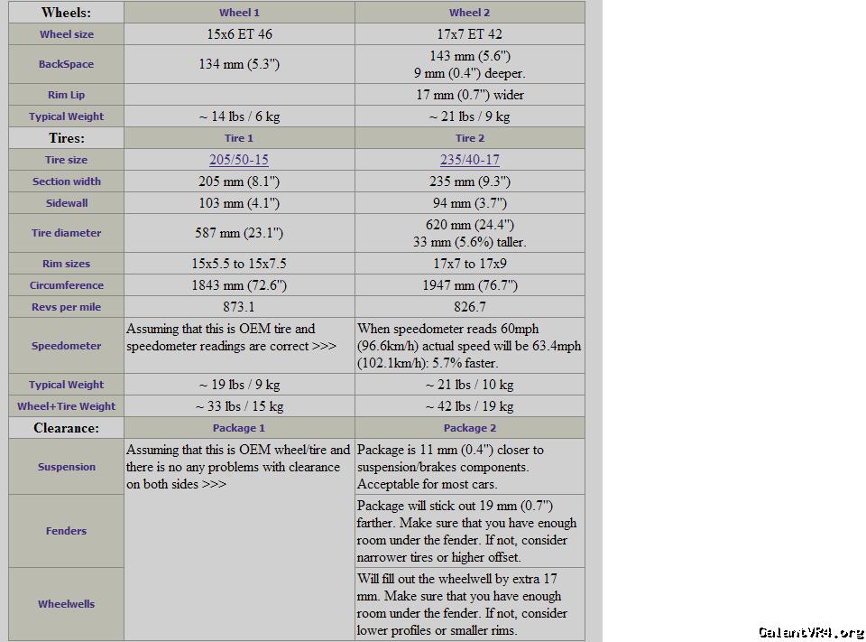

Ok, I am looking hard at a 17x7 wheel (4 lug, all I need). It is 17x7 +42. Nothing too crazy here, I know I will not have fender side issues with this setup.
The concern I have is inner clearance especially in the front. This wheel will be about 12mm farther inwards since the offset is close to stock and adding a wider tires such as 235/40/17, I am unsure if I will have rubbing issues.
Is anyone running such a setup or have experience. Been a while since I messed with gvr4's and wheels/tires. Any advice appreciated. Thanks!
EDIT - I don't think this matters, but I plan to lower it with AGX and H&R - Again, nothing too crazy. I know the AGX is not the greatest, but it will do. I have had this setup before and it was not horrible etc. I will only be using the car for occasional street use, so not a mega concern.
AND I don't want to do a 5 lug swap etc, I want to keep car close to stock as possible. I know lots of wheel options etc..
