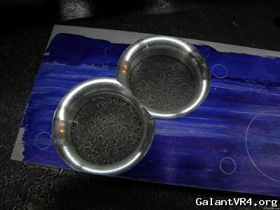

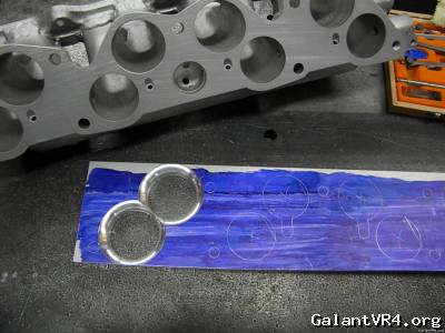

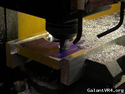

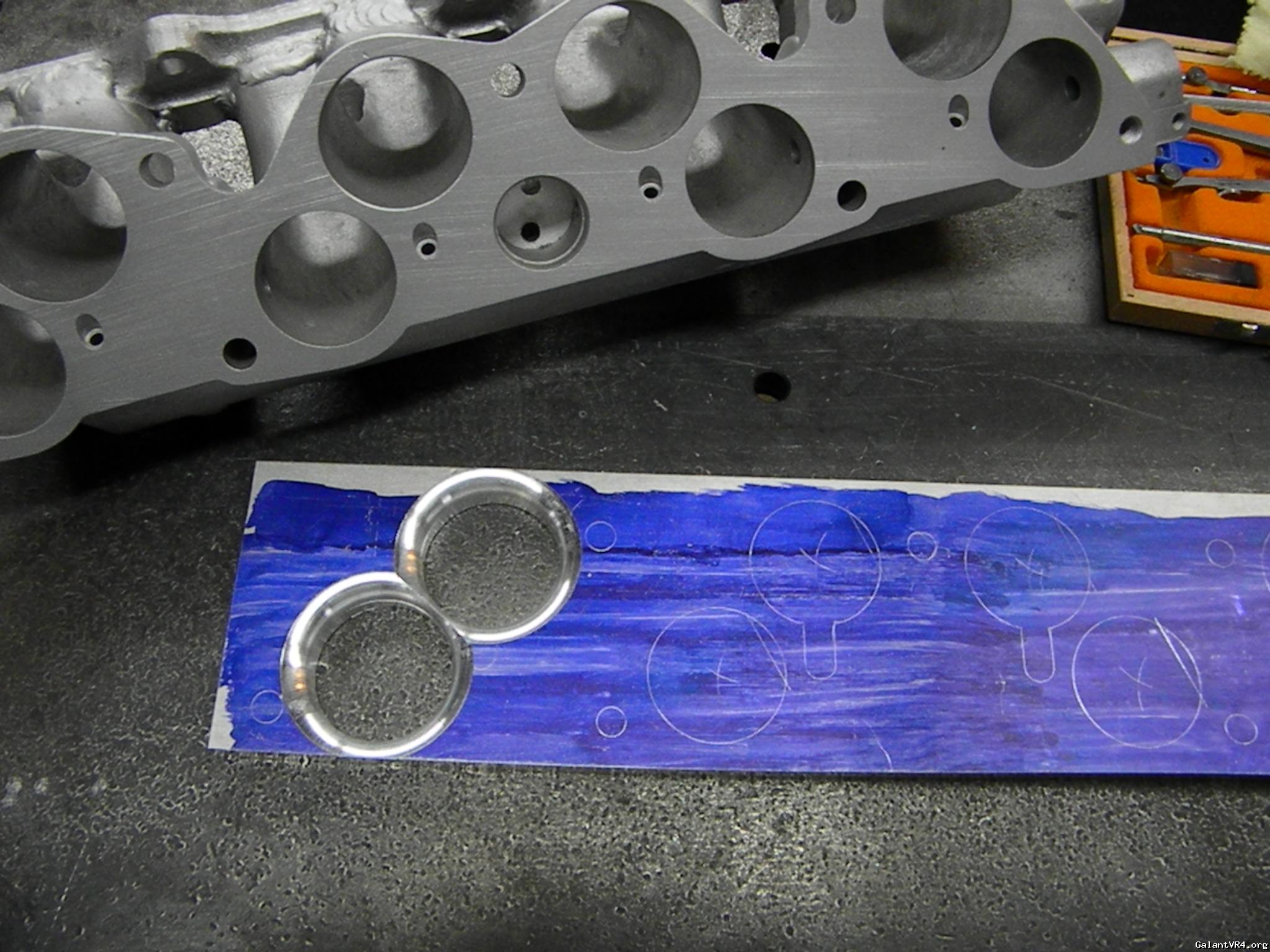

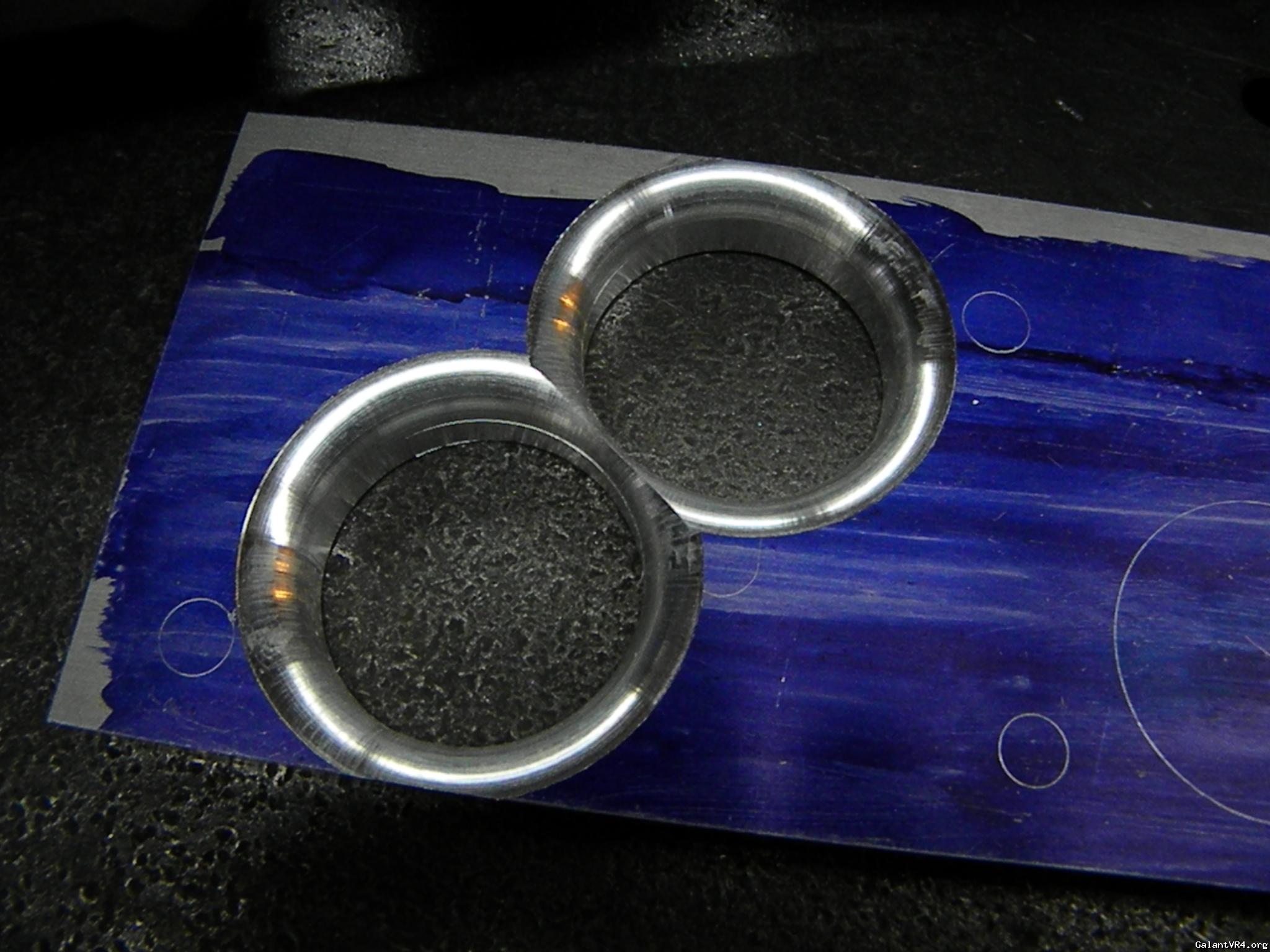

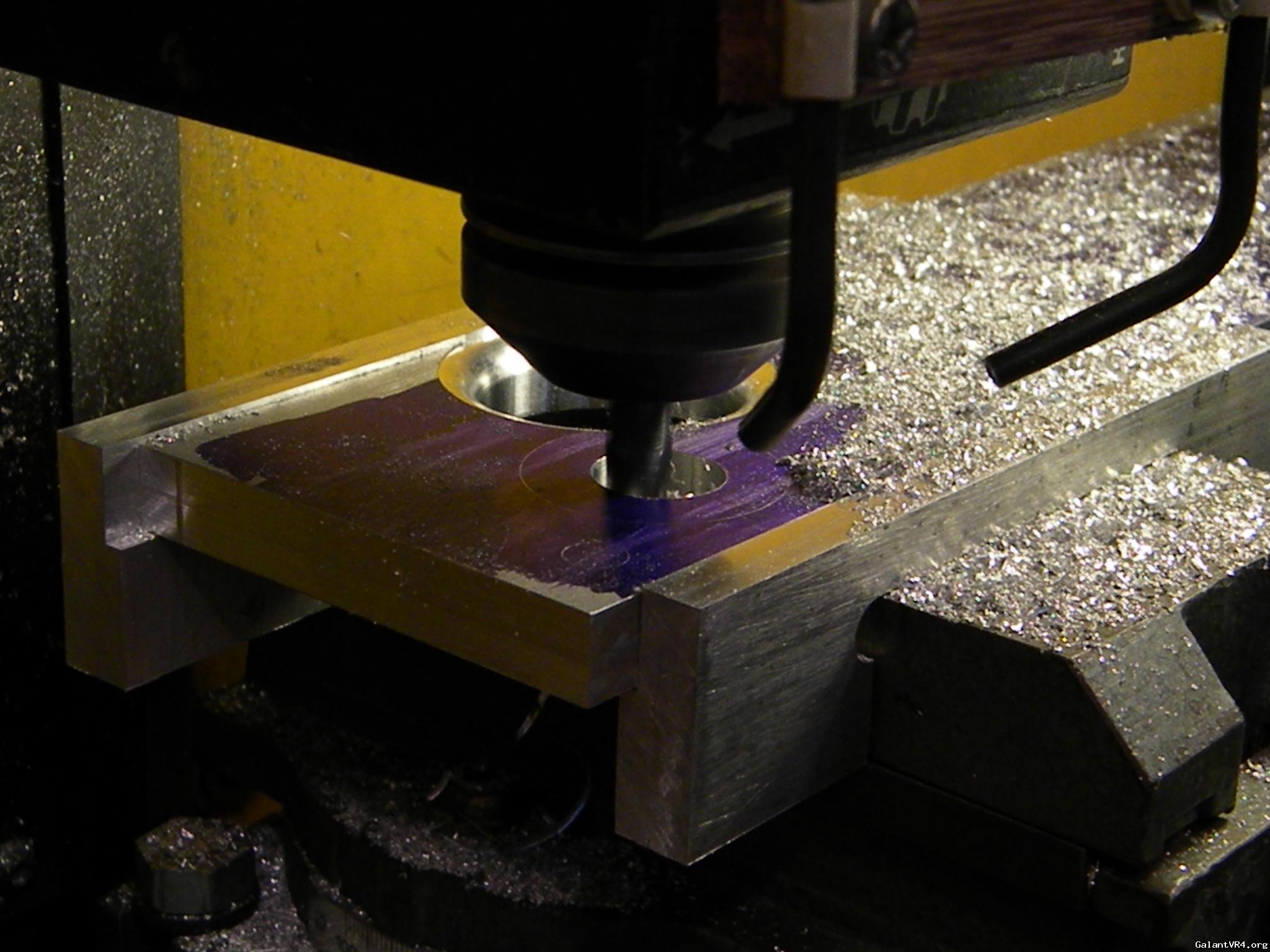

Finally had a day to write code and start cutting.
Custom short runner fat plenum Cyclone. Had this idea in my head forever, lower is roughed in and will need to be gasket matched perfect to this flange and a plenum fabbed up but design is done.

Its an old training machine from tech schools and the same type one that they had where I went to school for my engineering degrees. Its an Emco Maier from Austria that use to be controlled with a numerical keypad and the ability to hold 200 lines of code. I adapted it to run with another board in the controller so it can be controlled with a PC. Now I can run I think 2 million lines of code. It adds up fast with old G/M code programming. Just to pop the single hole it took 1456 lines of code then I think the radius on the top was like 300. But I'm only taking a 1/4 of a millimeter off at a time. End mills last longer just being nice to them.
Its very exact and can hold down to 3 decimal points in metric (toybreaker isn't a fan of the metric system /ubbthreads/images/graemlins/grin.gif) and is very rigid. I think the shipping weight was a little over 500 pounds. Problem is its just small the work envelope is 7 x 7 x 4 inches so things I cut need to fit into that size. I can remove the side boards and put long stuff on it but have to watch the weight but I have rotated the z axis over 90 degrees and milled out holes for studs in axles so really handy.
One of these years I'm going to stop doing anything, turn off the phone and the internet and get all the CAM stuff working and start doing 3D programs and just do drawings and let the machine write the code for me. Its not that writing it is a bad thing just takes up time. Finishing the code and drawings for this took about 2 hours and 5 minutes of that was the drawing. If the Cam stuff was working it would have took about 3 seconds. The problem I have is Austrian machine, controlled by another board and software then drawings in one language, and cam in another. The post processor stuff doesn't know what to do and the controller board doesn't have all the functions that it schould to keep up with what the cam is telling it.
