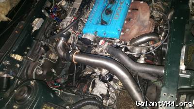

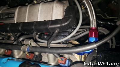

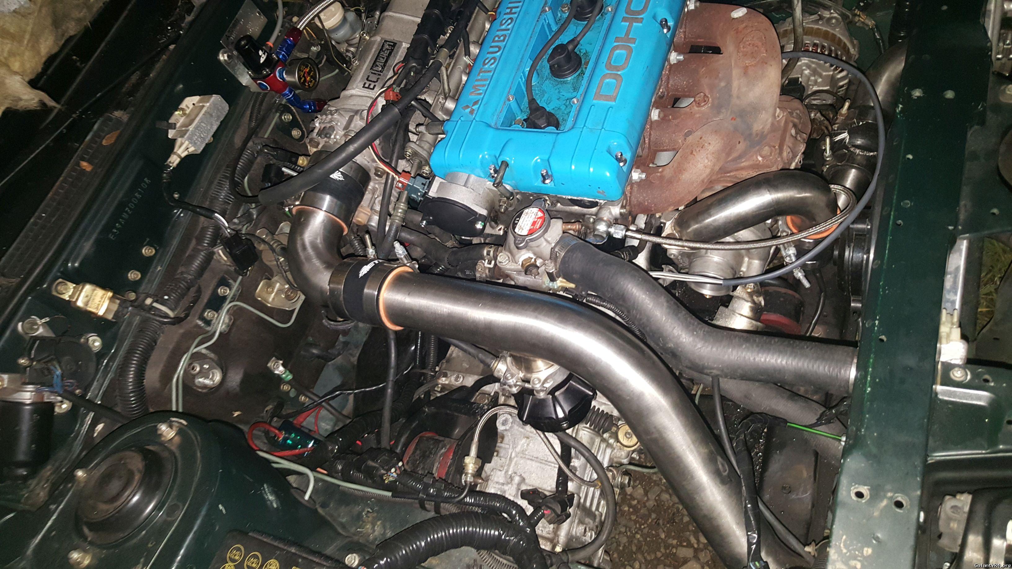

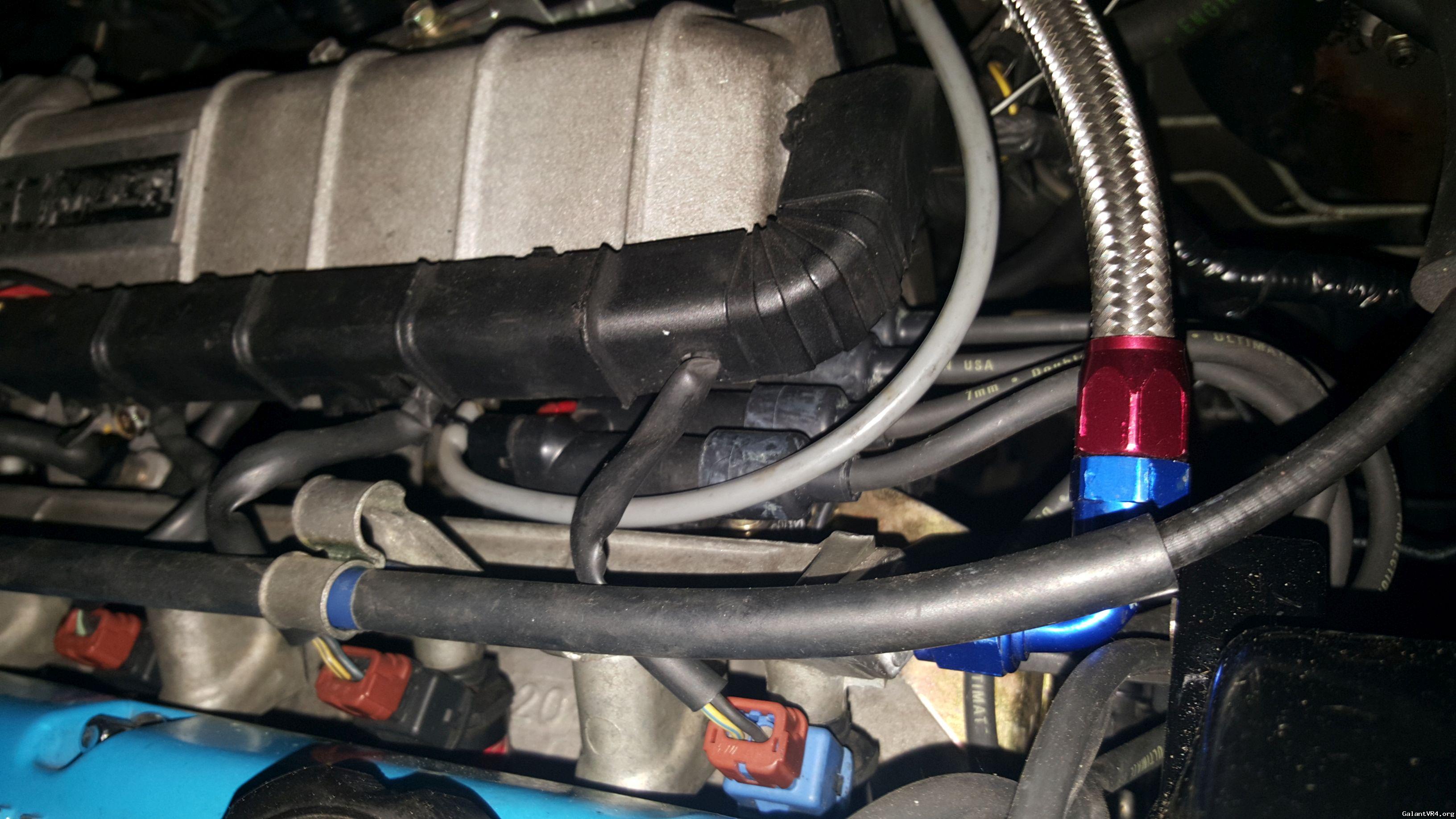

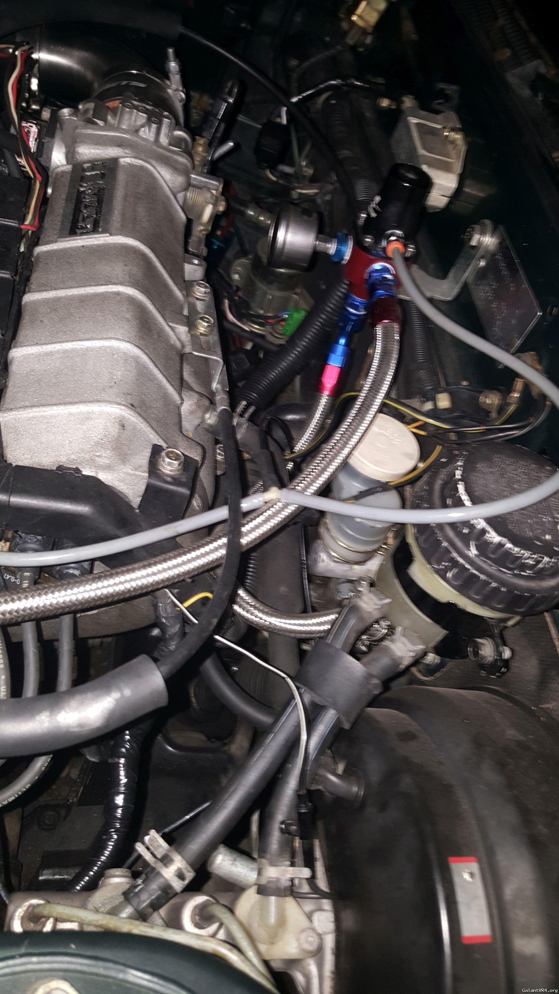

I purchased a used AEM Tru Boost as well as tial Q BOV. I have read on this one for 4 hours and can't find any information on the BEST solution, just what the options are. I attached a few pictures that show the routing of the vacuum/pressure lines. What is the MOST ideal routing/sources for vac/pressure? I am pretty sure at this point I am either going to drill and tap my compressor housing or my J-pipe for the Tru Boost solenoid, get my BOV from the stock location on the front underside(closer to the head, not the firewall) and the pressure for the gauge in the car from P on the throttle body. I also see that the guys who installed this for me have it configured for an external waste gate, which must not be as effective as having it setup for my internal waste gate. The BOV currently is getting it's /vac/press from the stock location, teed to the tru boost. Leaving my FPR to get it's vac from the stock location as well.

this is just my opinion, but you shouldn't T things off of each other for boost sources. the FPR should def not have any sort or a T in it. i would recommend spending 15$ and getting a vacuum distribution block. its what i used for a while till i got around to tapping ports into my intake manifold.

For the vacuum routing, use the stock location for the BOV. For the other components requiring vacuum, use whatever nipples are left on the manifold, or use a vacuum distribution block as Shane suggested.
You should have saved your money on the AEM Tru Boost. ECMlink has a far more robust option for controlling boost, which can be implemented for a fraction of the cost. You should consider ditching the AEM, and using ECMlink for electronic boost control. See here for how to do that: click
