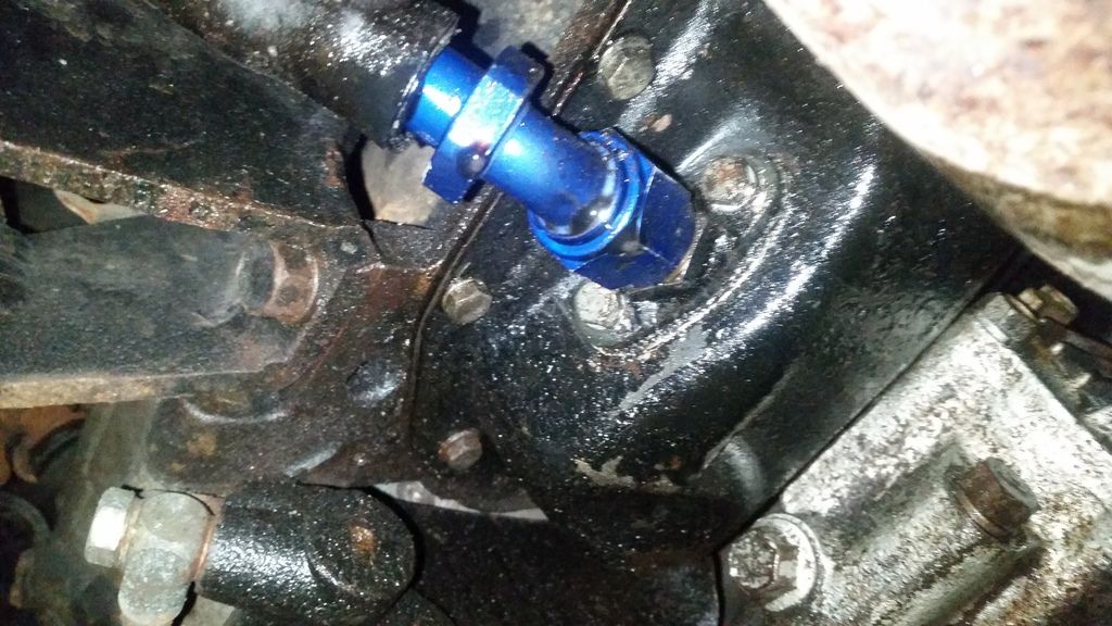

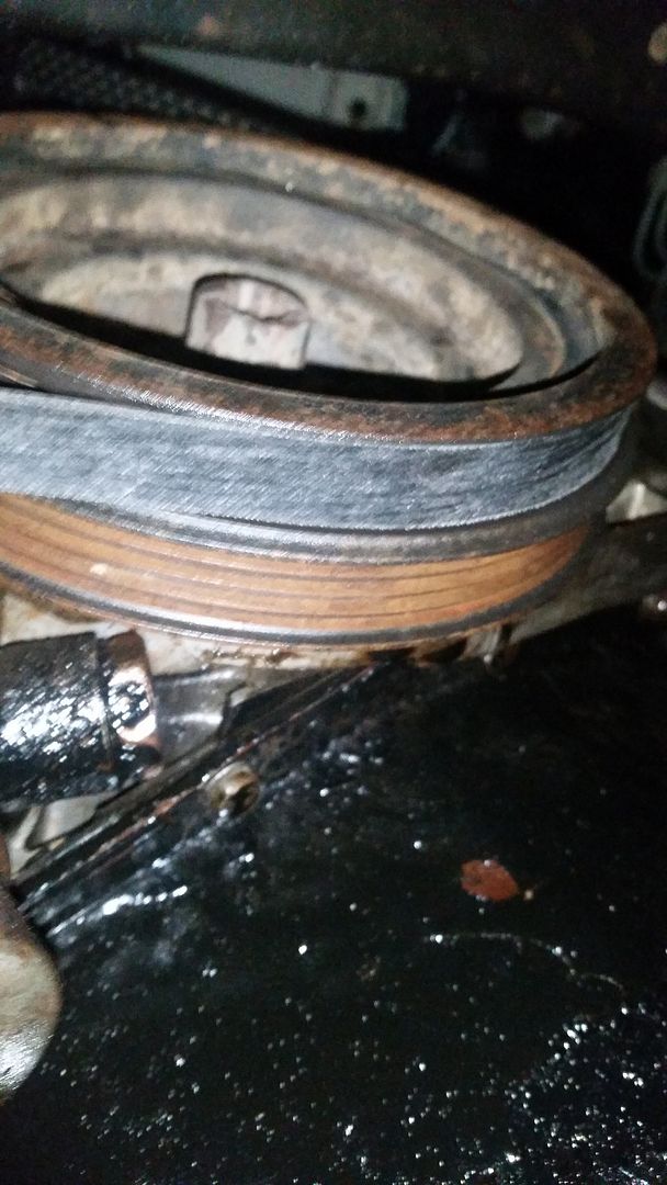

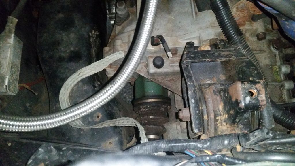

First three are oily spots.... this last one is the passenger side...dry as a desert

I might have discoveres my own problem. I remember the previous owner saying the oil filter was the wrong side because of clearance issues. So maybe my oil filter has lost its seal on the housing.... it hasn't always been like this will attempt an oil change and experiment with a different filter

The axle shaft looks like possibly grease from a split boot.

Grab a can of engine shampoo. Add a little pinch of engine oil dye. Dry off the entire area affected and run the car. See what appears with a flashlight.
If you have access to a blacklight of any sort and a set of yellow lense glasses, you will clearly see anything starting and quite well at that.

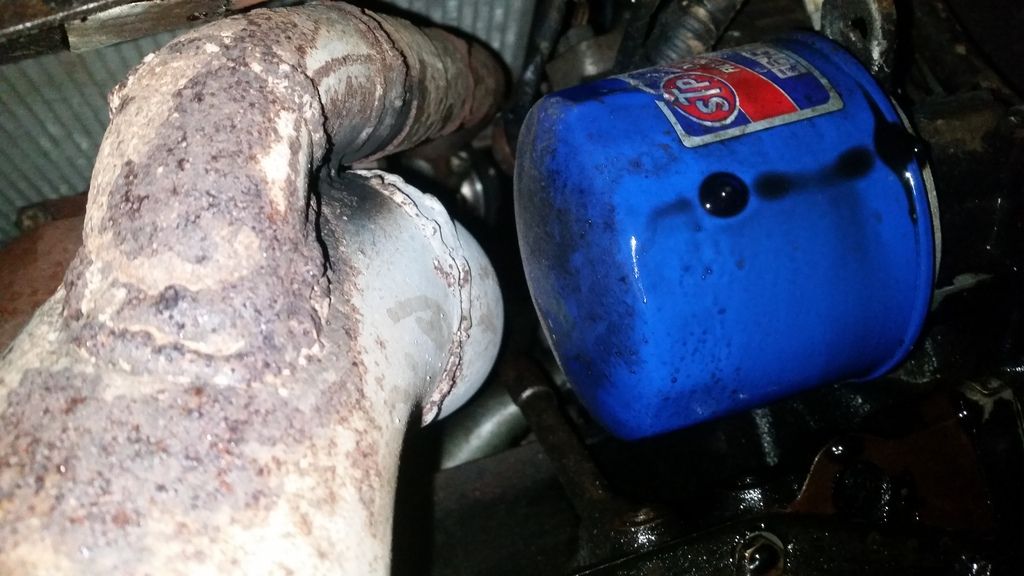

I found the problem, or at least 90 percent of the leak. It was the oil filter. If you look in the picture the PO used a huge stubby filter to fit the clearance of the exhaust. He probably grabbed the first on he could find and was done with it. I got a smaller one that is even shorter. I think it's Delco or something. But I'm going to find a better quality similar size in the future. Maintenance seems almost complete. Then onto you're all suggestions. The previous owner gave me a oil pressure sending unit. I see the old one but doesn't seem to have the wire to the sender. I'm guessing to the gauge. No big deal though. You all will hate me but my fpr is zip tied to 5he brake booster. I didn't have the patience or the supplies to mount the thing. Work in progress

I don't hate you because your FPR isn't properly mounted. I promise though, you will hate you when your car catches on fire. Just sayin...
For the oil press sender, it's for the idiot light since out car's don't have an actual gauge. It's not a huge deal if it's not hooked up. Typically, by the time the light comes on it's too late. It is good for initial startup though. It's a great way to tell if you get oil pressure right away after a few cranks.
Even with a shorter oil filter, it still looks really close to the downpipe. I'd see if there was some way to shield it from the heat. You could wrap the downpipe with exhaust wrap. Or, you could even fab up a small heat shield.
